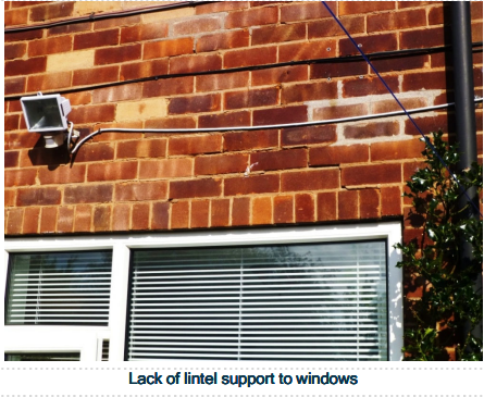

There is evidence of a lack of lintel support, most evident over the rear kitchen window, and additional lintel support will be necessary. Slight movement was noted in the front bay at first floor level and as and when the windows are upgraded, additional lintel support and
improvement can be expected. A programme of refurbishment of the external brickwork will be necessary and a full assessment by a suitably qualified Builder should be obtained.
Additional support to the front bay can be expected when these windows are replaced, with slight movement noted to the brickwork.

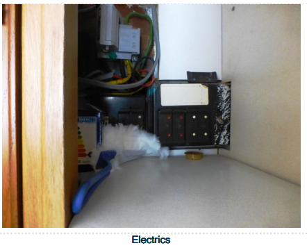

Electricity - A certificate was not provided has been stated on the survey. In addition to this the surveyor has stated the below:
Mains electricity is connected to the property with the wiring being served by an original fuse board within the cupboards to the kitchen serving the various switches, sockets and light roses around the building.
A full assessment by a competent Electrician will be required with all necessary upgrading and improvement works undertaken.
Does the above mean the fuse box needs replacing as well as entire electric upgrading i.e. rewiring? Or just upgrade the fuse box?

I am also concerned about the windows/lintel issue and chimney breast removal. I don't understand why they'd remove the downstairs one but leave the one upstairs.

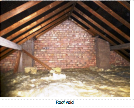

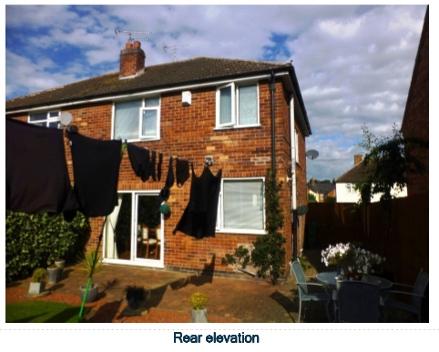

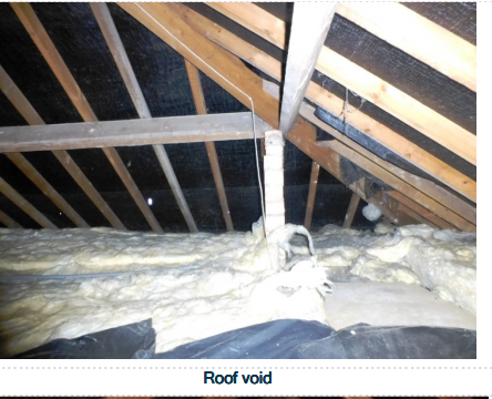

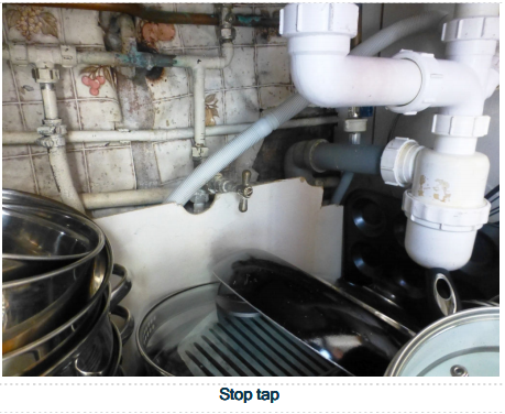

Pictures received via email:
The current owners who are retired have lived in the property for the last 25 years or so.
I am not prepared to trust the EA or the vendor - like you've said, they will try every trick in the book to play it down. At the end of the day, if these issues are as serious as they appear to be then any other buyer's survey will highlight them too. The vendor's will need to address it one way or another.
I have already got the ball rolling in terms of obtaining my own quotes. I will use the quotes as a form of renegotiation to bring the purchase price down only if they don't want to get the work done. I will not have the funds in place for the total cost of repairs (using £8k as an example) but I can borrow the money from family and repay them over 5 - 6 months after I've bought as I will be fortunate enough to have a good amount of disposable income - saving it all for the deposit and legal fees at the moment!
If they can get the work done before contracts exchange I am happy to wait. If they don't get the work done but agree to a price reduction I am happy to get the work done myself. If neither option is suitable for them, I'm going to pull out from the purchase.
Those are all the pictures they sent.... and not very good one's either!
