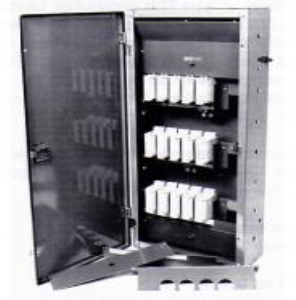

    • Looking at the seals on it, that might belong to the Electric board and i would have thought the council should not lock it with there padlock.
      It may be a old style FB padlock, which the Fire brigade as well as the Electric board can access, though they would likely just cut it offf in an emergency.
      Inside its likely a Ryefield board with 100 amp fuse carriers
      Does the padlock have FB stamped on it, though do not condone you fiddling inside.

This is likely whats inside

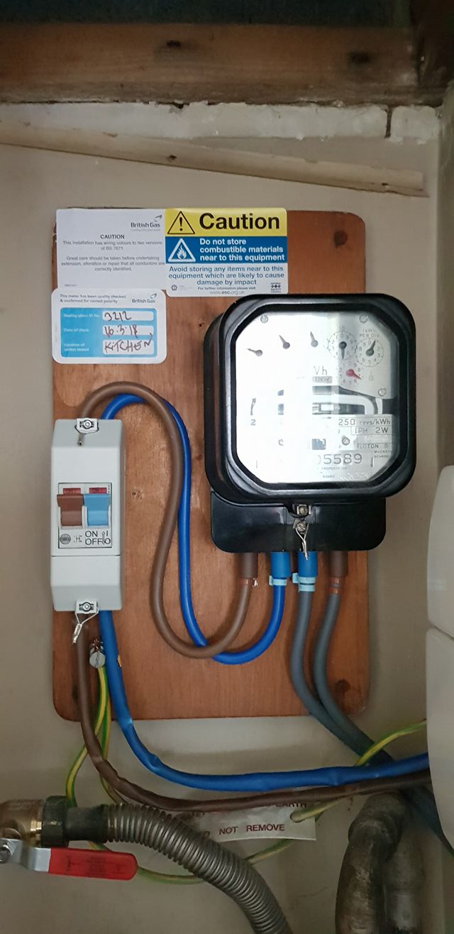

BG Electrician booked for this friday to fit isolation switch and its only £49 which includes the parts, so very cheap I am surprised.
I will now book access to the key from the council, hopefully they will reply in time.
Had the British Gas Electrician come round today and install the isolation switch.
He was very professional in the way he went about his job and was a joy to watch.
I am very happy with his work and he had the keys to access the fusebox, so all good.
He had a fuse detector so he could find the fuse easily and it was one of the two I thought it would be but hard to tell as the layout isn't so logical
Glad that it went well.
Judging by the appearance of the sleeving over them, I imagine that the tails coming out of the isolator must be fairly thin?
