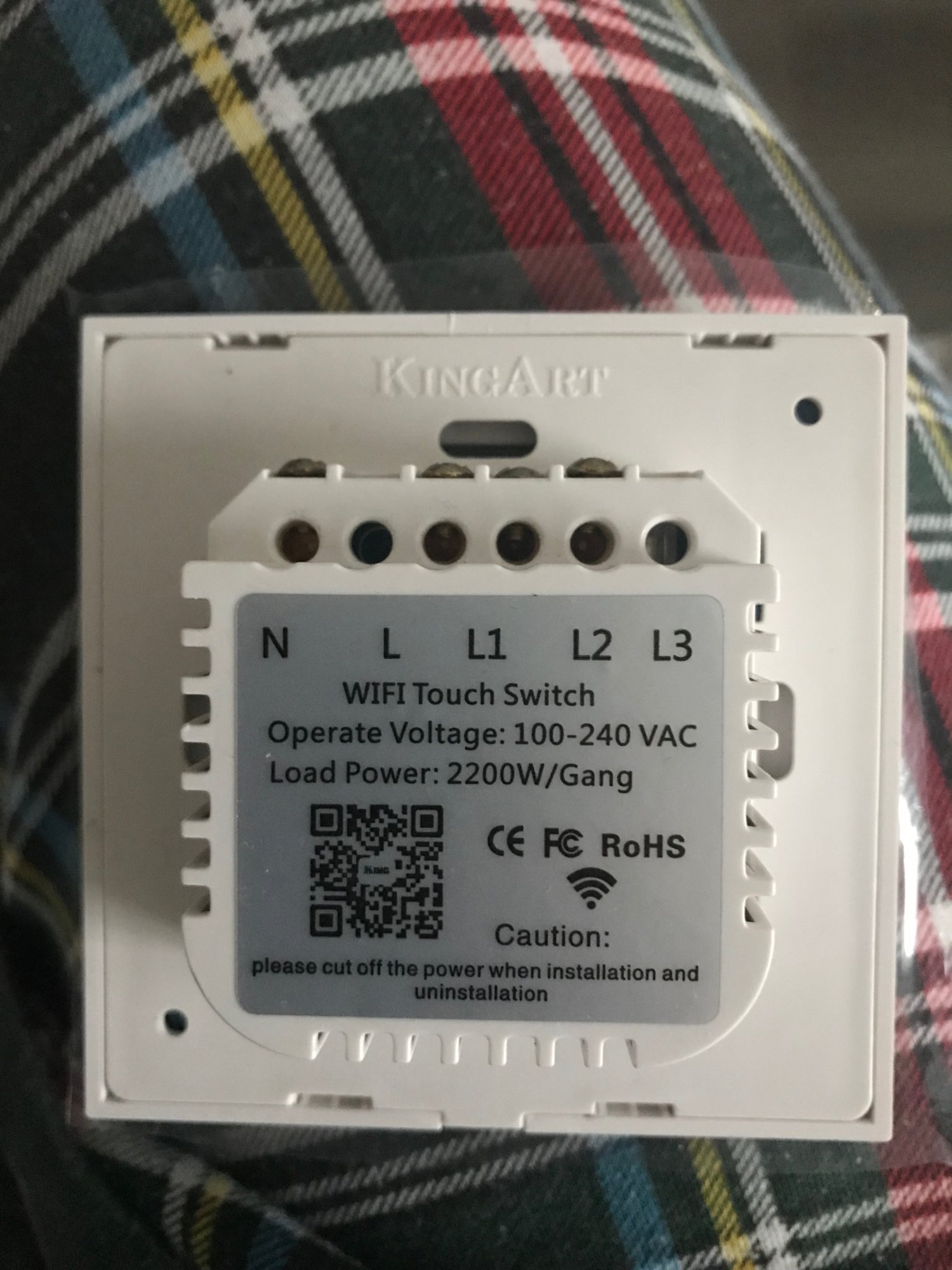

Hello,
A mate has given me two Wifi Smart light switches that he said he could not install at his place as he didn't have a neutral wire.
I've removed my switch on noticed that there appeared to be a neutral wire in mine. Just wanted to check if I'm right before I wire it in.
Current light switch:
Current wiring: Brown Load going in and out (with load In being joined across); Yellow Earth going to the light switch box; Blue Neutral wires loop round in the switch box.
New light switch:
I was planning to run a wire from the white Neutral wire box the N terminal and then run load to L and from L1 and L2.
It's a two gang light switch.
Thank you for the help!
Kiril
I think you have it right. To repeat
Run a blue wire from the terminal block with all the blue wires in (neutral) to the N terminal on the switch.
Mark the brown wires so you dont mix em up
Put the two brown wires that are connected to the COM terminals is the live feed in. Connect both these to the L terminal on the switch. Throw away the link wire.
You are then left with the two brown wires that are the wires to the two lights. Put one in L1 and the other in L2 on the new switch.
That should do it. I hope the back box is deep enough!

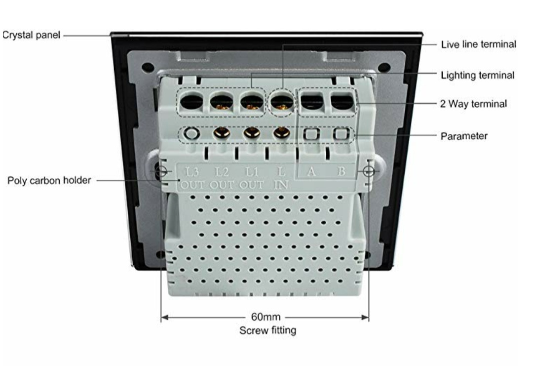

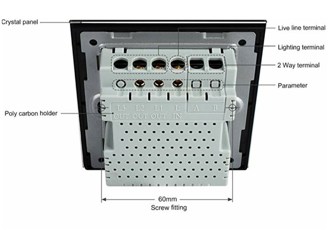

Will check with a multimeter - if all live, I've mostly seen live only smart switches with a single live in (the attached for example) - any thoughts on how I would add the second live in? I'm assuming both into the same terminal is twice the load and ill advised
The loading on domestic lighting circuits is trivial. If you are using LED bulbs (as you should be) the current is negligible, so nothing to be concerned about.
Halogens will be more, so count them up and multiply by their wattage, but it is unlikely to matter.
