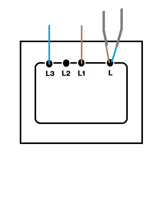

Smart Light Switch Wiring (I have a neutral wire?)

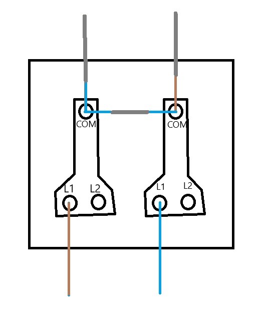

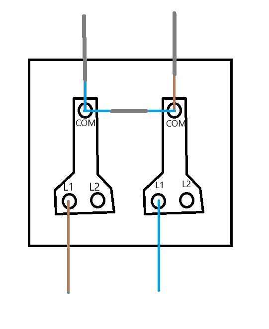

I can take a picture later, but here is the diagram that matches the old and new wiring (note - L2 on the new switch does not have a terminal)
Old wiring

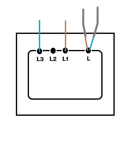

New wiring
Any ideas? Otherwise I'll just wire up a regular 2 gang and leave wiring alone, can't quite get my head around that setup - much appreciate any help!
Not unless you have mixed up the browns and/or blues.
The original wiring doesn't make sense.
Many an hour wasted because of faulty new products.
Fit an ordinary switch and see if it works.

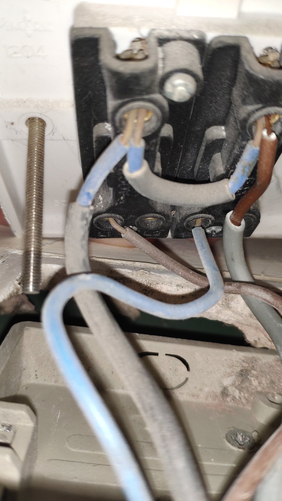

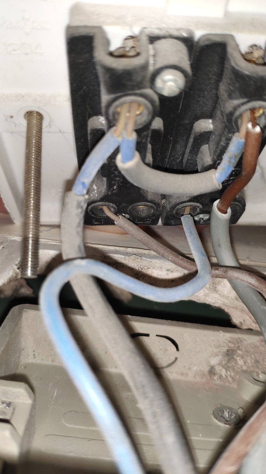

You need to get that corrected. The use of blue as a phase conductor is prohibited. Also the excess copper at terminations is prohibited. Phone a REC (assuming the installatiom is within the 26-Counties).
The existing work is appalling.
There also appears to be no cpc present.

The wiring in the diagram is correct, here is a photo
Then the switch must be faulty.
My setup looks similar to this thread, presuming the blue line is hot (using a voltage tester, it appears to be).
Similar, maybe, but it doesn't matter. It is a very simple job - but things are not as they should be.
There is NO excuse for using blue for wire B.

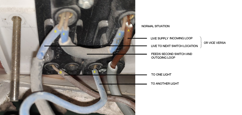

Assuming things are as they look and the lights worked properly before.
You need to find out which of A and B is the live supply.
You said B was 'hot' but did you take it out of the terminal or just put a probe on while connected to the other wires?
Say B is the live, then connecting it to D will make one light work and connecting it to E will make the other light work.
That's all there is to getting these two lights to work.
With A disconnected, some other lights in the house may not work.
If A is the live then transpose A and B.
