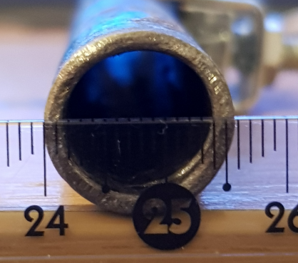

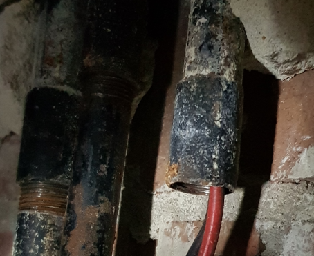

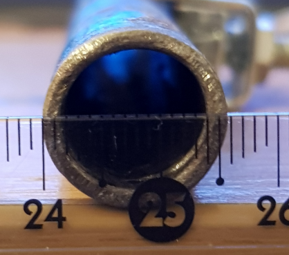

The point I was considering is that my 5/8" conduit have been cut/butchered so the one end has no thread on it currently.
The photo shows the thread which will screw back into the existing conduit so I could try and thread the un-threaded end with M16 and then it would screw into the reducer.
But I pity the next poor sod who has to deal with it and looks at a piece of conduit with one end with BSF 5/8" and the other end with M16 ;)

You could indeed try that, and might well be successful. I may be wrong, but when EFLI wrote "Surely the ⅝" at 15.875mm. is near enough to be treated as 16mm", I presumed he meant that either could have an M16 thread cut on them (with which I'd be inclined to agree, particularly since one is not needing to create a water-tight/gas-tight joint), rather than (as BAS has seemed to have assumed) that one could successfully mate ⅝" BSF and M16 components.

But I do still wonder how good a thread a 16mm die would cut on a 15.875mm pipe. Although fluid-tight joints aren't needed, a reasonable amount of mechanical strength and friction is. Worth a try.

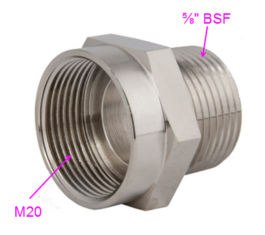

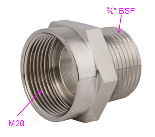

Are M20 to ⅝" couplers/adapters available?
A (coarse) male M16 thread has a minor diameter of about 13.5mm, so I would hope to be able to cut a reasonably usable (even if probably not water/gas-tight) thread on a 15.875mm (⅝") pipe/conduit.
As I said, worth a try. Such a thread might be feasible using machinery, but maybe a hand-held stock and die would not be stable enough on an undersized tube to cut a uniform thread.
I thought his plan was to insert sections of ⅝" tube into the existing couplers, and on the other ends cut M16 threads to allow the use of M16/M20 adapters into M20 bushes?

Yes that is my plan as otherwise the sex is reversed as the existing pipes have a socket to screw into thus the reducer can not be used.
That is the only reason I would reused the existing cut off conduit otherwise I wouldn't bother and go straight to 20mm conduit.
But if you could find something like this:
Yes that would be nice if I could find one that way around but I have tried.
