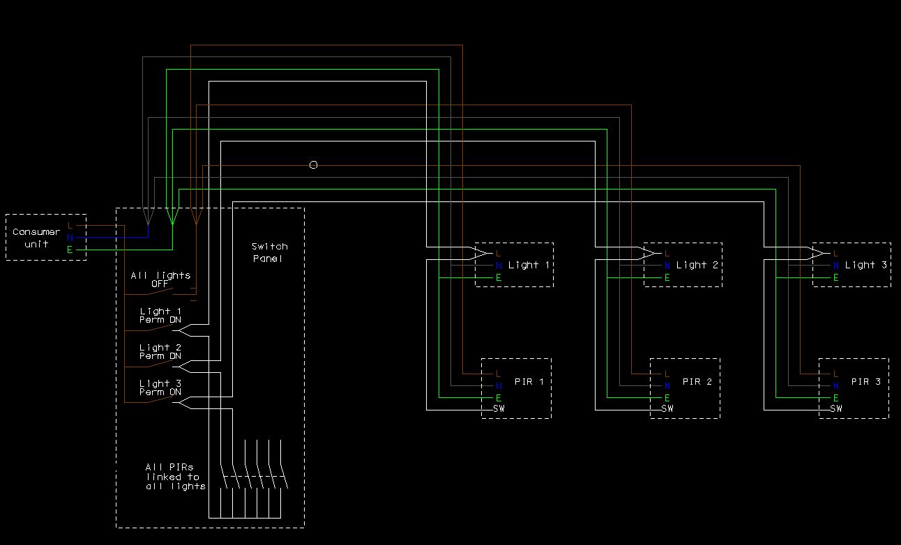

Good evening all I've got an interesting problem. I've been asked by a customer to wire up a series of outdoor flood lights and PIRs around a large property (over an acre in all).
There are currently 4 large floodlights 2 with PIR's. They have asked for 3 additional ones and they have asked for each floodlight to have its own PIR which will, in normal operation trigger just that light, but when they are out/away can they turn a switch (possibly to be controlled by a spare output from the alarm panel in the future) that will link all the PIRs so any 1 PIR will trigger all the lights.
I think I've worked out how to do this but i would need a 6 pole single throw switch, which I've never heard of. Can this be done with contactors?
I've never done anything with lighting contacotrs and wondered if anyone could offer some suggestions? I've attached a diagram of my thoughts so far. It only shows 3 lights and PIR's for simplicity. All the lights and PIR's will be wired back to the switch panel in 4 core, mostly SWA but a couple will be 1.5mm T&E ran internally in existing containment. I might also have an issue with voltage drop as the furthest light will be over 400m from the DB but this is doable in 16mm SWA. I just have to find a way to break the news that the cable alone for that light will be £2500 !!

I think I've worked out how to do this but i would need a 6 pole single throw switch, which I've never heard of. Can this be done with contactors? ... I've never done anything with lighting contacotrs and wondered if anyone could offer some suggestions? I've attached a diagram of my thoughts so far ....
I can't think of any other conceptual approach which would achieve the functionality you want.
As you imply, I imagine that it could be difficult (or impossible) to find a 6-pole mains voltage switch (but someone may come up with a source!). If I were doing it for myself, I might 'link' (with a bit of plastic and some superglue!) three DP grid switches - but one can hardly do that for a customer!
However, as you say, you could simply replace that switch with one or two relays or contactors (you may, again, have difficult in finding a single one which had 6 sets of contacts) - and then have a single SP switch which switched L to the coil(s) of the relay(s)/contactor(s). I see no problem with that, so wonder if you have thought of some potential issues?
Kind Regards, John
At that power rating, you can probably just link the PIRs together like that. For the multi-pole switch, just use a relay* (or more than one relay) operated by the switch/alarm panel output/whatever. As it is, use a 240V AC coil, if they use an alarm output, you could replace the relay with a 12V DC coil model from the same range.
* A contactor is really just a specific type of relay.

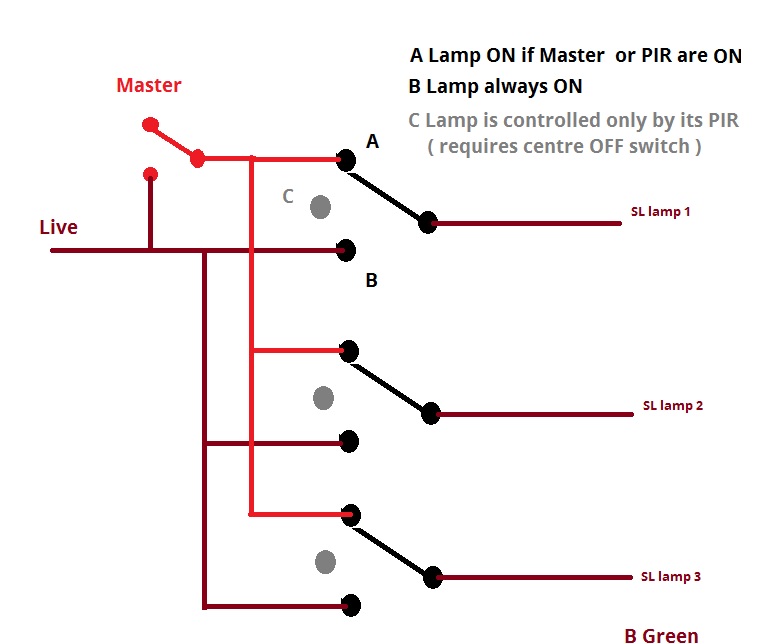

Or use Change over switches on the Swithched Live lines
Centre Off switches are available if that function ( PIR only controls the lamp ) is required

Thanks for the reply's, i think the light that is 400m away will be dropped as the cable costs are far too high. The 6 pole switch from RS is perfect and i might even go for more poles if they do it so there is spare capacity for the future. I was going to mount everything into an enclosure and put an MK grid switch along side that controls the individual lights so the rotary switch can just me mounted in the enclosure . i will post some pictures when its all done if you interested.
