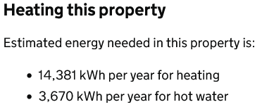

You did not say Infrared, that changes things. The infrared heater does not heat the air, it heats objects in front of it, so any thermostat which measures air temperature is not going to work, it is instant heat, so a PIR to turn it on as you enter the room would work, they are used where there are a lot of air changes, common with listed buildings where you can't fit double glazing etc. Also garages, churches, use them a lot.
So now back to start, why are they fitted? It may be because rooms not used for long, like with the church, or massive drafts like with the garage, or wrongly specified to start with. One thing need to be careful of is where aimed, as Infrared will go out of even double-glazed windows, so must not be aimed at windows, also of course nothing in line of sight between room occupants and the heaters.
They are the same as open fires, which also give out infrared, so are fitted at the focal point of the room. Or fitted high up, these
typically used in bathrooms, it seems there is far and near infrared and I don't really know the difference, but we are looking at how the flat is used.
Back in the 90s we all had infrared heaters, they were called light bulbs, and I, for one, set the central heating to a background heat, which was supplemented in the evening by turning on the lights. When I changed to compact fluorescent lamps, I also had to change the thermostat to a programmable one, so evening heating was higher, and as a result in winter in real terms, the tungsten bulb was saving energy, as having the air cooler, resulted in less losses with air changes, we had 6 x 60 watt bulbs so 360 watts, and the heater you link to is 350 watts, so you need to look at the building first, and its use. My late sister would leave for work at 7 am and visit our parents on return, so only got home at 8:30 pm and by 10 pm was going to bed, so for her that heating would have worked well.
For me, retired, and at home all day, same when small children are at home, we want 24/7 heating, so infrared is not really going to work. My daughter had this problem when they decided she could work from home, her home was never designed to be an office.
So using existing heaters, looking at occupancy controls, I have same with my lights, I have a switch by the door, so I can turn them on/off as I enter/leave the room.
