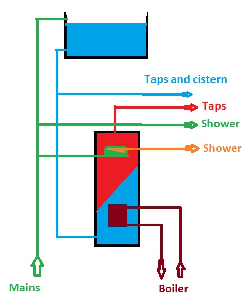

I'm very interested in the possibility of installing a shower pump, which if it would work with our current system would almost certainly negate the need for a boiler change to improve the hot water supply to a shower. I think its best to start a new thread in order to focus specifically on that possibility.
Meantime many thanks (again) for all responses to my query about conventional versus combi. :)
I think that the OP has made it perfectly clear that he is happy with his experience with Worcester and wishes to stay with them , really cant understand some of the comments of so called professionals on this post
Thanks for that. I am happy with Worcester and when we do decide to change the boiler thats what I'll be going for. Meantime as suggested above I'm going to explore another route, because it is mainly the lack of a decent shower which has stimulated this discussion in our household, and it would be ridiculous if we spent two and a half grand changing a boiler when we could address the problem with a shower pump for a lot less.
On reflection I think I can cope with tanks in the loft, though a shower thats adequate in summer but nowt much more than a trickle in winter is a pretty significant problem.
An alternative for having mains pressure showers is a second coil in the top of the cylinder to heat mains pressure water using heat from the water in the cylinder. Does not require any shower pumps. The second coil is the green/orange item.
Low pressure hot water for taps and basins is supplied from the cylinder.
