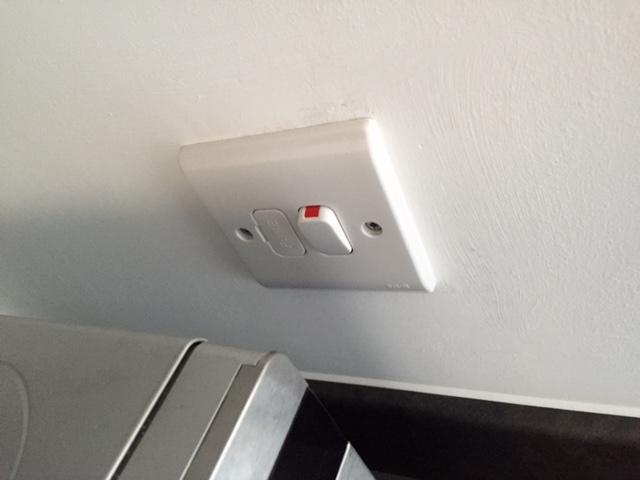

Convert a FCU to Socket and FCU, or Spur of a FCU?

In terms of the the extra socket i'm thinking of putting it right next to the current FCU. Its a stud wall, so what would the best socket back box to buy, in terms of easy fitment etc?

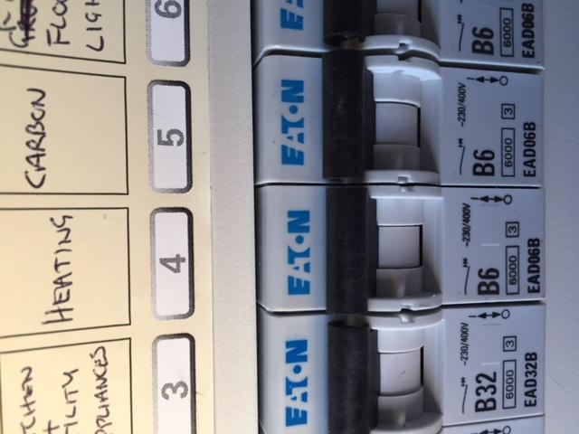

I've installed the new socket and spurred it off the FCU and everything went great! Pretty happy with myself, all working great and looks like a pro job!
So before I changed the MCB to the 16A one from the 6A one, I plugged the microwave in and and to my shock everything worked fine, the 6A MCB did not trip, and everything seemed great. Ive now changed the MCB to a 16A as recommend, but i'm now confused, if the 6A one was fine and not tripping, I should be using that really? I thought you should always use the lowest MCB/fuse you can get away with?
Also, i noticed when changing the MCB to the 16A i was supprised to see how thin the cable was supplying the bolder FCU/my new socket, I think its 1.5mm. I take it all that is ok? Its only supplying the boiler FCU and this one new socket.
Should I stick the 6A MCB back in?
What power is your microwave, and how long did you have it on for? A 6A MCB will allow about 8.7A (about 2,000W) to flow for an hour, and appreciably greater currents than that to flow for shorter periods of time, without tripping. On a sockets circuit (when you don't know what will get plugged in) the MCB is just there to protect the cable (so any size less than the current carrying capacity of the cable is fine), and one could't size it according to the (unknown) load, even if one wanted to.

Thanks. Its a 800w Microwave, had it on for about 5 min warming up some food. The circuit only has the boiler (3A FCU) and my new single socket, which will only ever have the microwave plugged in. Given that, would the 6A MCB protect the cable etc better and therefore be safer?
That wouldn't even trip a 2A MCB.
Well, if you were absolutely certainly that you (or anyone else) would never want to plug in anything other than (or in addition to) the microwave, then a 6A MCB would be adequate. However, a 16A MCB provides ample protection to the cable so that 'more/btter protection' would not make it any safer.

The 800 watts refers to the output into the food. The input power from the mains will be around 1200 watts. See the rating label on the back.
