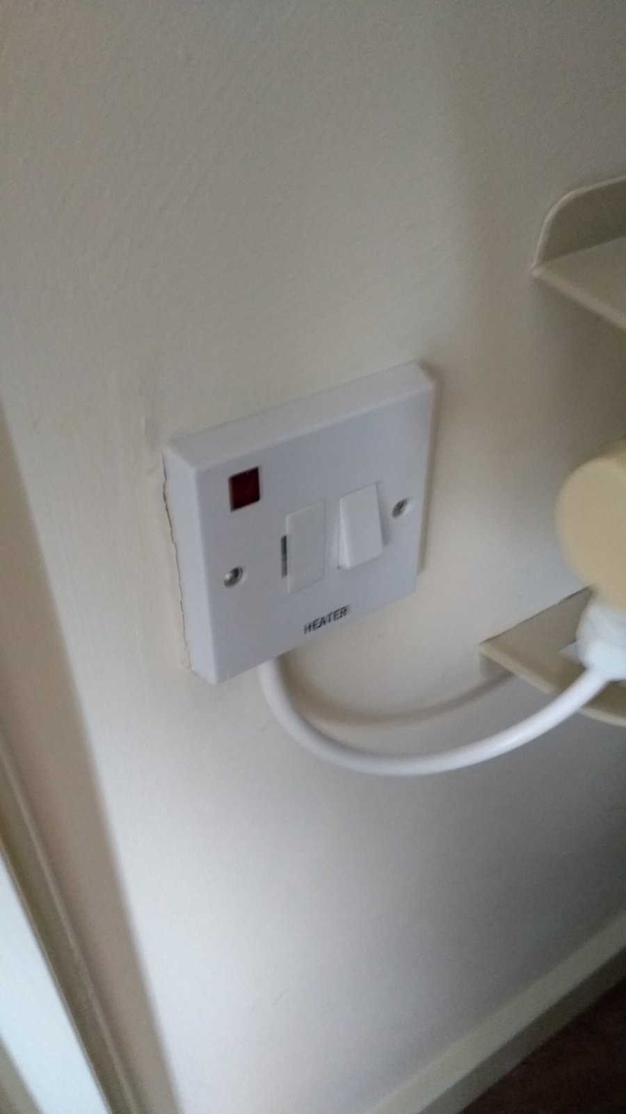

Hi,
Is it possible, and if so how, to convert a hard-line airing cupboard heater point to a standard socket?
Pic attached.
Cheers.

You can simply change the existing front to a socket.
Remember to do it safely of course. Isolate and test for dead. Disconnect, and reconnect a socket front.
Assuming the circuit is on an RCD (if not - no socket allowed by the Wiring Regulations):
  1. Turn off the power.
  2. Remove the existing accessory.
  3. Replace it with a socket.
But but but but but....
Why do you want to swap it?
What will you be plugging in?
Is there a door on the cupboard?

He, yes it's on an RCD. It's a fairly wide airing cupboard so I'm thinking of turning it into a hidden desk/office space. It will be a PC and Monitor plugged into it.

So that means you should install a twin socket, at least.
Then there's
Printer
Modem/router
External devices such as backup
Powered USB hub
Phone charger
Lighting​

No it's not in the bathroom. Thanks for your help I'll have a go at it tomorrow
