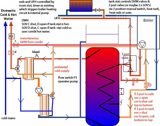

Hi All,

Ok so how am I going to do it?
If you look at the schematic I`ll try to talk you through it.
I think the DHW is fairly standard except the tank stat opens and closes the 2 port motorised valves to allow hot water from the tank through a plate heat exchanger the cold water is preheated through a 2nd preheat plate heat exchanger to reduce the return temperature to the bottom of the tank and preheating the combi feed water and the feed to the main plate heat exchanger so a smaller exchanger can be used. The DHW circuit is a direct feed using the hot water in the cylinder to gain maximum heat from the tank. The heating circuit pump is triggered by a flow switch when you open the tap, this flow switch is situated after the combi supply so the preheat works for the combi water even if the tank is not hot enough to heat the water on its own and the combi will use less gas.
The heating is a bit more unusual. There is a 3 position electrical switch (manually operated) ; the positions are `heat rads` - summer position, used when we are confident there will be sun to warm the tank by the immersion the next day; the next is `heat tank` so we have manually decided to heat the tank up as we don't think the sun will be good tomorrow or the sun has not heated it today and we need more than 1 shower in use; the last is `auto` or the winter setting, where the tank stat will heat up the tank using the boiler whenever it cools down to the temperature set on the tank stat.
so there are 3 modes, the first we'll look at is heating with a hot tank.
The boiler receives the heating demand from the room stat and begins the ignition sequence and starts the internal pump. hot water is circulated from the tank through the open motorised valve `a`(SOV `b` is shut) and into the return of the boiler, the boiler will sense the hot water and stop the ignition of the burner, the burner may have already lit by then if everything has cooled down which is a pain but what can you do? (I'm not going to muck around with the boiler extending the time delay between the pump and the ignition start.) The pump will circulate the water around the rads and as SOV `b` is shut it will pass through the coil from bottom to top where it will once again enter the return of the boiler. I've just realised that it needs another blending valve before the return to limit the radiator temperature, I'll blend it with the radiator return where the direction arrows are shown.
Ok now we'll go through a direct combi boiler feed so the tank is under temperature but it's not worth heating 300 litres by gas as the sun will heat it in the morning so the electrical switch is in the summer - heat rads position. The same thing happens and all the valves are in the same positions but the boiler will now sense the return is under the temperature required and fire the boiler, on the way back from the rads the still hot return water will pass through the coil of the cold tank, heating the tank water and ensuring the boiler is condensing. If the tank gets heated by the immersion during this operation the boiler will sense the temperature rise and the boiler will turn off the burner.
The final mode is the heat tank setting, the 3 port valve will turn to open the top of the coil to the boiler output, SOV `a` will shut and SOV `b` will open the flow though the coil will now go from top to bottom extracting as much heat from the water as possible and returning directly to the boiler return through SOV `b`. The return water from the rad circuit will not be able to flow backwards as the 3 port valve will be shut at the front end. If heating is demanded by the room stat the 3 port valve will go to the mid point opening the tank coil and the radiator circuit at the same time, the return from the rads and the return from the bottom of the coil will both flow back to the boiler return through SOV `b`.
Ok so that's how I think it will work but if you've got this far please let me know if you see any problems with the design.
One question i have is the unvented tank has no bleed point, the manual shows an inclined feed tube as I`ve shown but I'm a bit concerned that all the air will not be expelled causing problems, I`m putting the bleed on a long pipe to act as an air collector which can be bled but I also thought of cutting a valve in the top of the tank but how would I attach a flange reliably?
Also I took this diagram from another post and it shows the pump after the heat exchanger, I would have thought it better to push the water rather than sucking it through or am I wrong?
Any assistance on the size, type or best places to get Plate heat exchangers from would be massively welcome.
Thanks in advance to anyone that has spent the time to get this far and makes any suggestions to put my mind at rest.
Tim
Best of luck with that.
So, all this complexity - when by simply connecting the Ariston's immersion to a triac based PV immersion controller, you can heat your Hot Water by PV when it is needed.
As the PV will, at best, reduce around 10% of your gas bill by doing only the above, what improvement in % are you expecting your design to liberate over and above this?
Bearing in mind most households only use 20% of their gas bill to generate their hot water on an annualised basis.
Electric heating is 100% efficient as we all know (I'm an electrician as well as a gas tech); my toaster and kettle are also 100% efficient. I save the planet every time I use them (not). A gas boiler is 92% efficient but the fuel costs a third as much. You will know that nearly all our electricity in the UK is produced by gas, at an efficiency of around 45%. And that PV contributes precisely nothing to the peak load the UK experiences at 8pm, when the sun has moved elsewhere.
Finally, you have a pretty grim boiler and a cheapo glass lined cylinder. Ariston make some quite nice cylinders but anything that is labelled 'contract' in the H&V world is cheap crap. Using it as a heat bank therefore is probably not the best idea; if you want a heat bank, its best to buy a product designed as such. A Joule TS2 has the plate and the controls already on it, and is stainless steel to boot.
To sum up my personal opinion of your plan; misguided.

I've just converted my vented cylinder to a thermal store, as it was a relatively low cost option. It's satisfactory but an unvented would perform better and be simpler. So I don't get why the extraordinary level of complication? I'm sure maintenance costs alone would wipe out any savings you would achieve.

Well I did expect the ridicule! :-o
Thanks for all the constructive replies guys & girls, the whole point of this is its going to cost me next to nothing comparatively. which is probably why the local dealer and fitter doesn't approve.
I am doing this because I need to serve 3 to 4 mixer showers, a bath, and 7 sinks/basins.
To get an off the shelf system with a system boiler would cost about £6K with fitting and every system has its disadvantages.
My plan is going to cost me about £300- £400 including the inhibitor depending on what the plate exchangers cost.

If anyone can please confirm my design would work, confirm how these tanks get rid of the air in the top of the cylinder and suggest plate heat exchanger specifications then I would be most appreciative.

Just because you have the bits in the garage doesn't mean you need to use them. Designing a system around what you have rather than what is needed is not a good way to design a system. What you are proposing is probably going to work but the complexity will be a big drawback in the future when it needs some attention.
Keep it simple for ease of service and fewer items to go wrong.
Showers, my shower is mains pressure heated by a coil inside the vented hot water cylinder, I had considered a plate exchanger with a pump to circulate hot water from cylinder through the plate and went as far as buying one, but dismissed it due to the problems of clogged plates developing and the need to run a pump when having a shower. It is a bespoke cylinder but bought direct from the manufacturer it cost no more than a similar sized off the shelf cylinder. Being vented it has no requirement for safety devices that required regular testing.
What you have is an unvented cylinder. Just use it as that and heat it with the solar when the sun is out and the gas during the winter.
That is simple and all you need.
You don't even need the £200 solar controller. Just a simple light operated switch to power the immersion when the sun is shining brightly.
As said the £200 cost would take ages to recoup!
You will then have a standard unvented system.

Hi Bernard and Tony, Thanks for your replies, I completely agree with what you say but it will be me who fixes it, we're never leaving this house and I`m doing the best I can with what is available, and as I completely agree this will not produce massive savings I am unwilling to pay out significant sums to get the extra flow to the showers.
I thought I'd mentioned in my original post but it must have got lost in the editing but the tank is of no use as a unvented cylinder any more, the electrical anode stopped working and was totally seized in and could not be replaced, the plumber changed the tank for this and it would not pass as servicable for pressurised use. I have pressure tested it and it is fine for use as a vented store, no leaks, the water runs clean and there is no scale.
As the coil has been used with inhibitor I can't use it for water directly to the shower and without an anode the tank needs the inhibitor so it has to be a PHE design.
I can simplify it a lot by having just one PHE but then I would lose the combi preheat which will save gas all winter and it lowers the return temp back to the tank and maintains the statification.
I can also lose the reverse flow through the coil to lower the return temp to the boiler but for the sake of a couple of motorised valves why not?
The main area I could simplify is to lose the blending valves except for the final water temp but then I`ll be constantly playing with pump flows to keep it all stable.
Using the existing boiler to supply the heating circuit has already simplified the circuit compared to some I`ve seen and the burner will only light when the return temperature through the tank drops.
It looks more complicated on paper than what it will be in practice and I've gone through the fault diagnosis steps if any single valve goes wrong and I know what effects various failures would have on the system so diagnosis should be no real issue.
I actually started off having a simple immersion only heat source feeding into the cold feed to the boiler via a single PHE but the inability of the boiler to accept higher temperature mains water (or lack of confirmation from BIASI as to inlet temperatures) has complicated things. Having a single immersion fed by PV would never heat the tank on its own so it has grown to this which will supply the flows required to the showers, use the PV and keep the boiler in condensing mode when it is required.
Just standard 22mm 2 port motorised zone valves and a flow switch if you mean c, d and FS on the diagram. with a blending valve after the PHE.

But it is not the best you can!
The best is that which costs least and saves most.
That will be an unvented cylinder heated by surplus PV generation and supplemented by gas heating during the winter.
