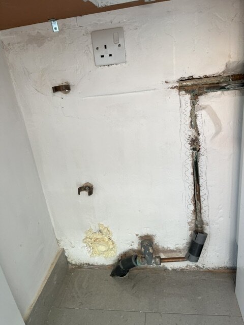

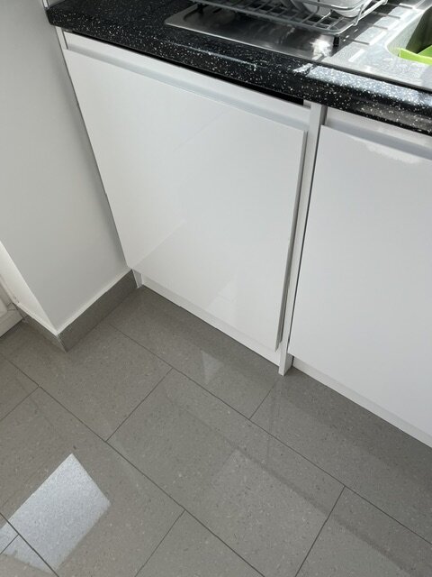

I have an usnused base unit of 615mm space, pls see photo, door is fitted but not in use. I want to convert it to 2 units, one for 150mm pull out and and second for 450mm integrated dish washer. The plan is:
1. Cut the door 597m in the photo to make 2 doors for each of the 2 units: 147mm and 447mm. Paint edges.

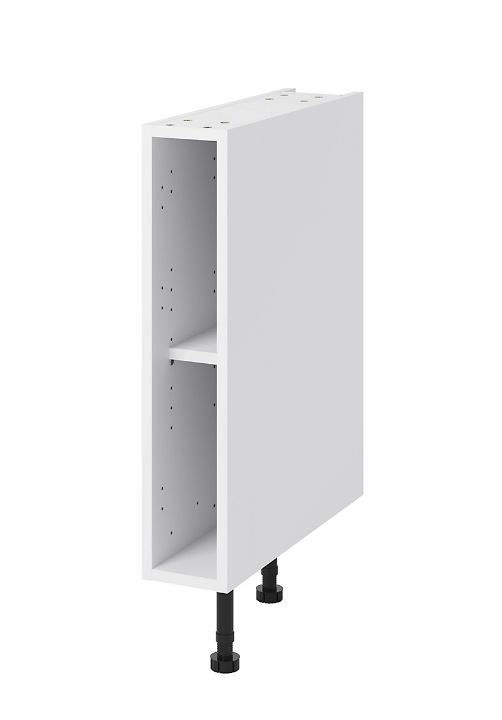

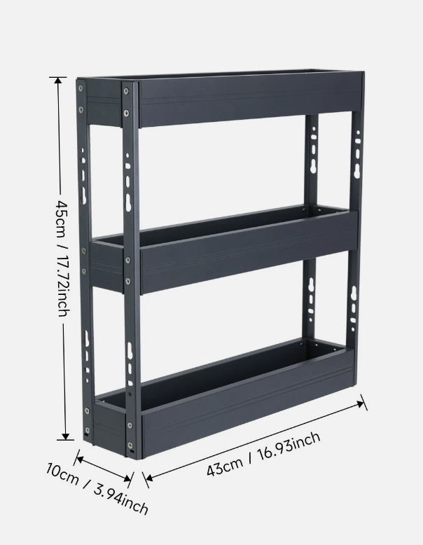

2. Fit 150mm base unit and 3 tier 100mm pull out, pics attached.
3. Fit integrated 450mm dishwasher. Cold water and waste are already available next to the unit.
4. Filler strip if required.
Is the above workable? Which unit to fit first if matters? Any other considerations?

Yes all that will work. You will need fit the 150mm unit first to set the 450 gap for the integrated dishwasher. If however there is any pipework running behind the 600 base unit your are ostriscing, the pipe work will need moving or the dishwasher wont go back far enough.
You will also need to put some silver tape at the front edge under the worktop to stop the steam damaging the worktop.
Unless you really need the storage, I would just put in a standard size dishwasher.

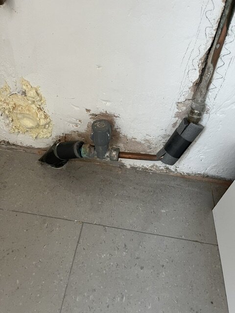

I don't think I can do my plan, there is the stopcock which come out about 60mm from wall, the whole depth is 590mm leaving only 530mm. The depth of the washing machine is 550mm plus 20mm for the door.
I rememberd the old dishwasher was sticking out by 50mm or so.
I may need to replump if feasable?
Or cancel the stop cock as I have 2 compression full bore valves; one on ground floor and one on first floor for the cold water, is that a good idea?
Beko do a 550 deep slimline dishwasher that is 81cm high, it has 45mm deep x 100mm high cutout at the rear, you could sit the dishwasher on a 60mm board and combined you may miss that pipe.

Can you buy doors (new) the size that you need?
Yes, you can cut the existing one, but it’s way easier to build a carcass for existing doors.

Many dishwashers have an indentation at the lower back to (presumably) facilitate services. Perhaps if you swap out the "stop cock" for a full bore levered valve (and remove the lever) that might give you enough depth. I am not a plumber and I am assuming that the "stop cock" is a service valve rather than the mains stop cock. I also suspect that the depth issue was down to the previous standpipe for the previous dishwasher. If you are planning to run the flexi waste pipe into a spigot under the sink, that may get you past the unit depth issue.

Stop cock stands up to 170mm, too high; I bought lever full bore ball valve when fitted will be at 100mm high, all dishwaher have cut out of around 80mm and with legs raised will solve this part of the problem. The remaining issue is the vertical pipe needs to be closer to the wall to give depth slightly more than the 580mm needed by all integrated washers which are 550mm deep plus 20mm door.
Replumping needs to be copper pipes soldered which can't do , will have to hire.
