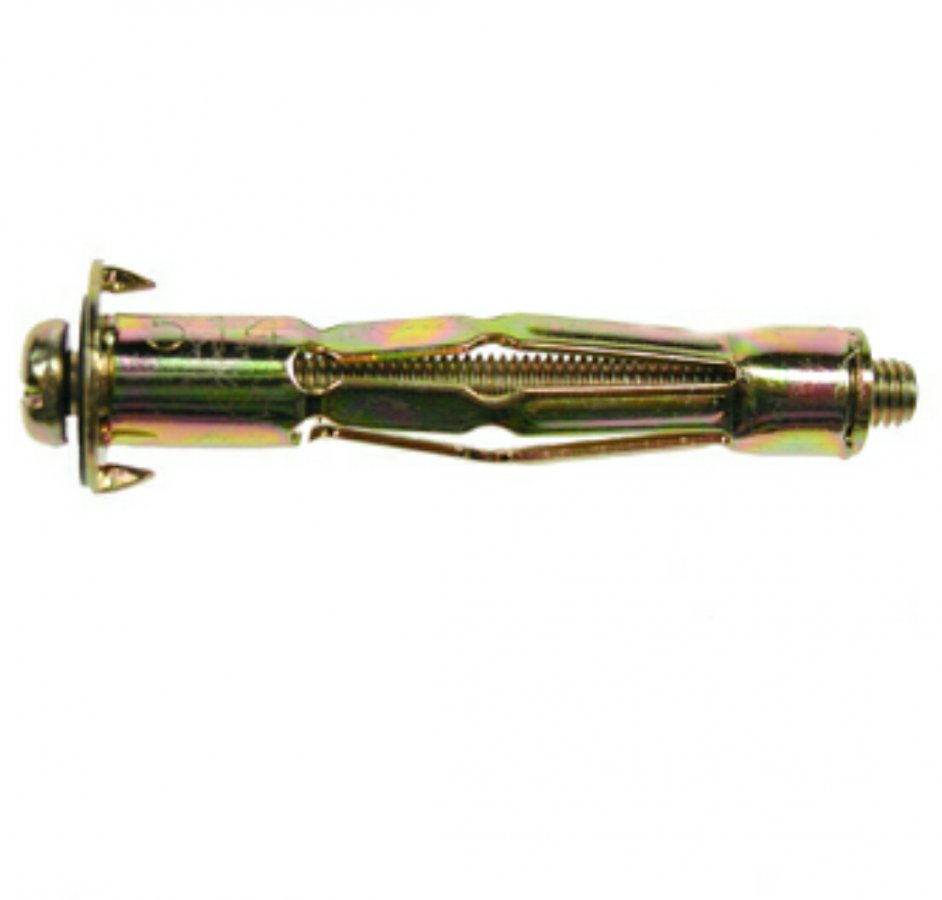

How about these anchors for the plywood walls.. Would you recommend them.. Pic attached
Those are for plasterboard walls. With plywood just a simple woodscrew will be plenty.

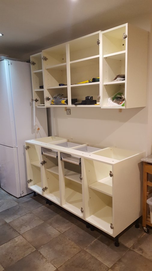

Thanks for your help folks. Wall and base cabinets fitted.. Waiting for doors and worktop now.
Why have the end wall units come low? If you plan on fitting a cornice or a pelmet then you will have trouble.
The wall units seem a bit high - whats the dimension between the base units and the wall units?
Are the what look like screwed on wood pieces below the wall units somehow involved in supporting the units? 450mm is a common dimension, allowing easy access to the top shelves.
You are right about the the corner units being a bit lower than the middle wall unit. The thing is that when hanging middle unit I messed up with drilling a hole for the bracket. There are bricks in the wall and my drill does not have hammer action. So drilled another set about 1 and half inch above the messed up hole. Dont know the distance between the base and wall units but its the same as the other older units already in place (on another wall not visible in the pic). Thirdly..yes those are pieces of wood in an attempt to support the 1000mm unit. It has been fitted properly n all but being a DIYer and doing this for the first time. I just wanted to give that unit a bit of extra support from bottom for my peace of mind.
If you're not screwed into brick what are you screwed into?
Fitting a temporary straight timber lath to the wall first can be very helpful to balance the units on when you mark out, or whatever......there may be some adjustment on your unit hinges to bring them into line but there's a fair bit of movement needed there.
John :)
John :)
I used a laser level to mark the tops...but due to messing up a hole for the middle unit had to change the hight.
It seems an awful shame to leave it stuck up in the air like that after going to the effort of extending the kitchen, cant you beg, steal, hire a hammer drill to reposition it?
