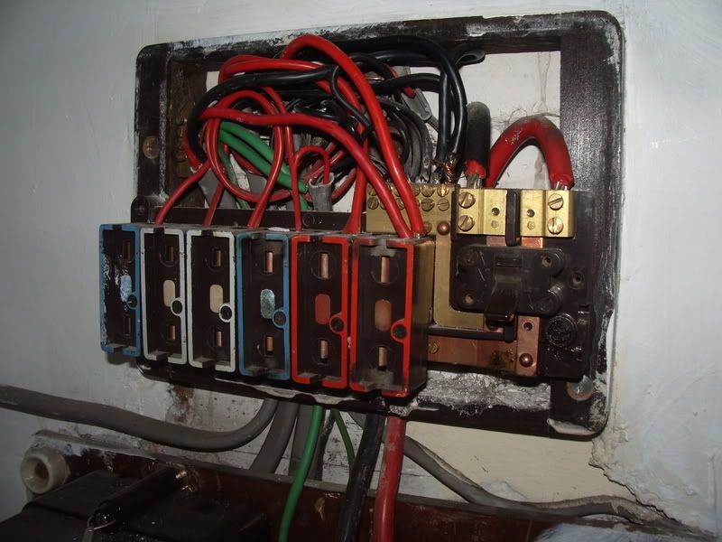

I cut this one off a couple of weeks ago.
The 2x 6.0mm² cables wouldn't fit in the same terminal so they had trimmed a few strands off each wire :roll:
This one was feeding:
1. An 8.5kW shower.
2. A 9.6kW shower.
Off 6milli...
