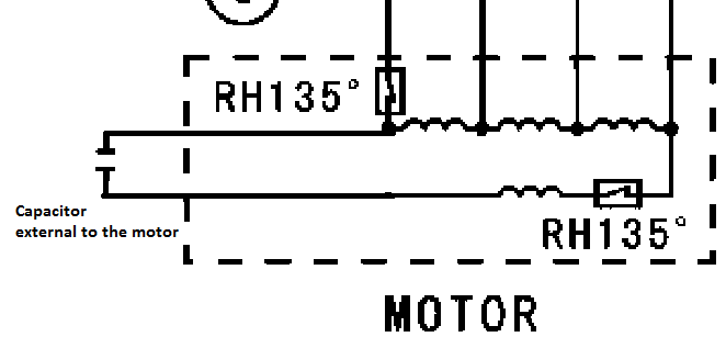

The point of this operation, is that I want to activate the boost function of my MHRV system when the cooker hood is turned on, regardless of its speed setting.
The hood is a Caple CGC610

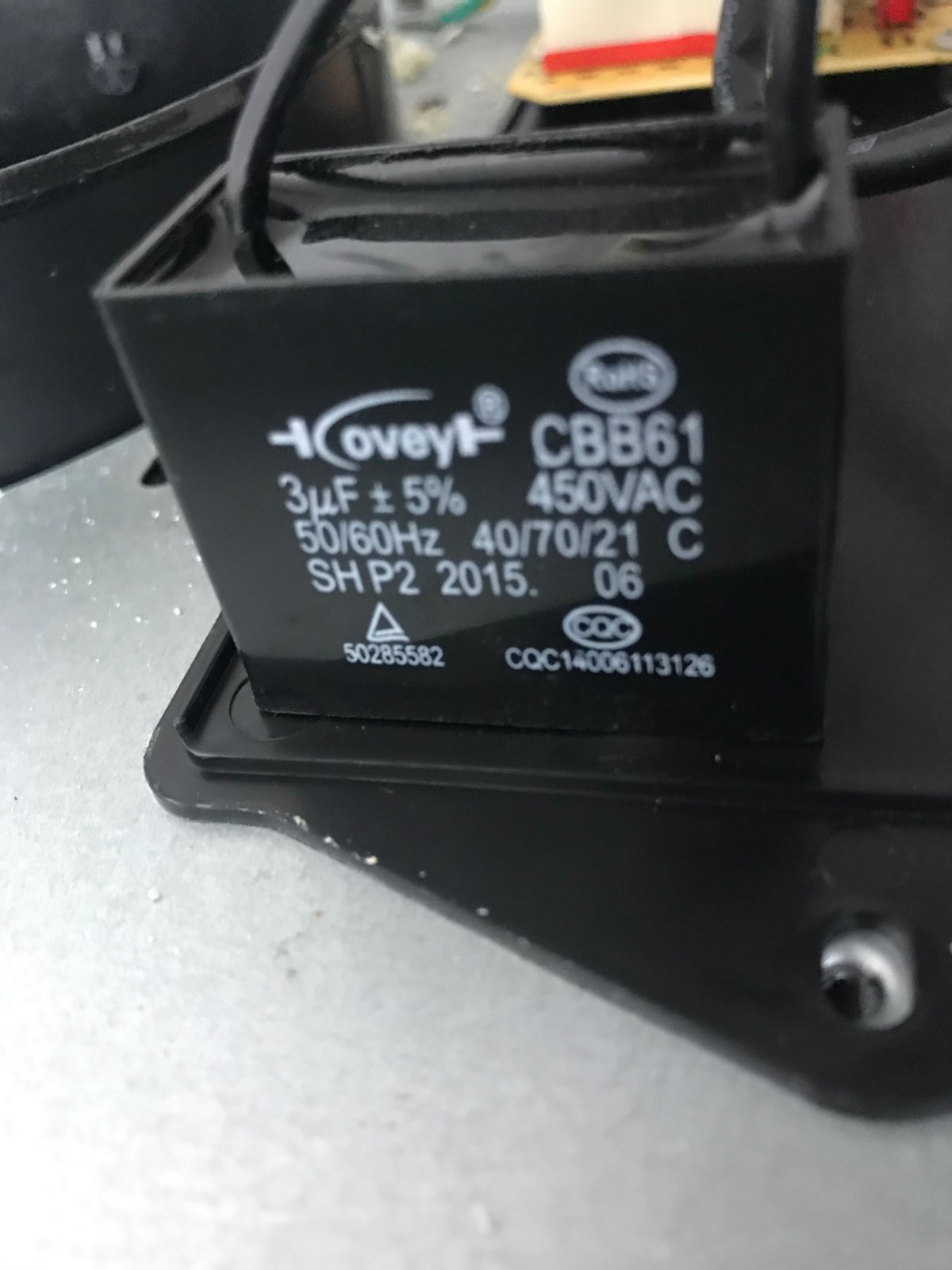

I've opened it up, and found that there are 6 wires going to the motor, however 2 of them connect to this capacitor (?). Sadly my photo of the wiring connector didn't work and I've closed the thing up again now. It did however have 4 connections, labelled on the PCB according to the colour of the cable and nothing else.

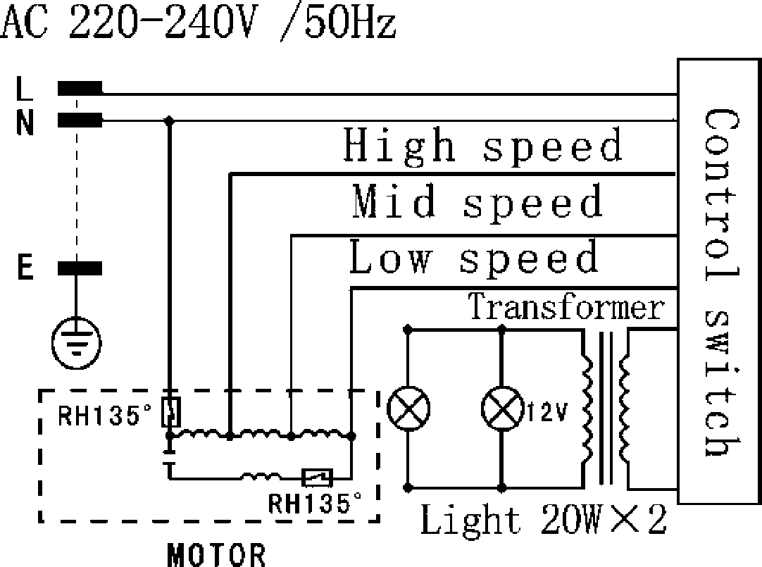

There is also a nice wiring schematic I found, but I cannot tally it with what I'm seeing.
Hopefully someone with more electronics knowledge can help me understand how it works, and if indeed there will be a constant 'live' wire when it is in operation.

From that schematic the 240vAC motor has a permanent Neutral connection and the live is switched to different windings by the "control switch" (it would be better to be able to see all this too?).
If the "control switch" is in fact just a switch then tapping into the "high" winding connection with a switched live would do it if done correctly.
Hence the 6 leads from the motor.

Second one- no there's not a convenient single 240v live that goes high when your cooker hood is on.
But (if you have a multimeter and can safely access those 4 wires while the hood is live) you should find that all 3 of the wires (marked LOW, MIDDLE and HIGH) go high when the fan control switch is in any position other than OFF (meter set to read 250v AC).
If that is the case then a 240v relay across LOW and N should give you your switch function (as a volt free switch)- once you unveil the MHRV wiring then an interface should be possible.

I want to select any of the 3 speeds on the extractor, and have that trigger the 'boost' function of the MHRV unit. It has a number of volt-free terminals available, and I've found a timer relay that accepts a wide input voltage, so would work for this I think
The boost is triggered by any of the 4 available volt-free pairs of terminals, so its integral to the unit (Expensive external options are available)
I thought maybe low would always be powered if the fan was running, as it may be cumulative through speed settings 1 - 3. I haven't put the meter on the terminals yet, as I wanted a little guidance before I started 'having a go'.

Make sure you connect the relay across the HIGH wire and use a relay which will switch at a much lower voltage.
When the fan is running at high speed, the low wire is likely to be at vastly higher voltage.
So I have now tested, and got the following results:
High
246v
206v
163v
Medium
274v
246v
193v
Low
311v
279v
246v
At least I think thats the right order, I couldn't completely determine which speed was on which pin from what I saw.
So as @SUNRAY has suggested, I should connect across the HIGH setting.
Any thoughts on the suitability of the overrun relay I have found, or any alternatives? This is all going to work out quite nicely :)
Tim
Those numbers look reasonable, and yes I think that relay should do it.
As Sunray says, the low and medium speed connections on these multi-speed motors can be significantly higher in voltage than the supply - the motor acts as an auto-transformer stepping up the voltage.
