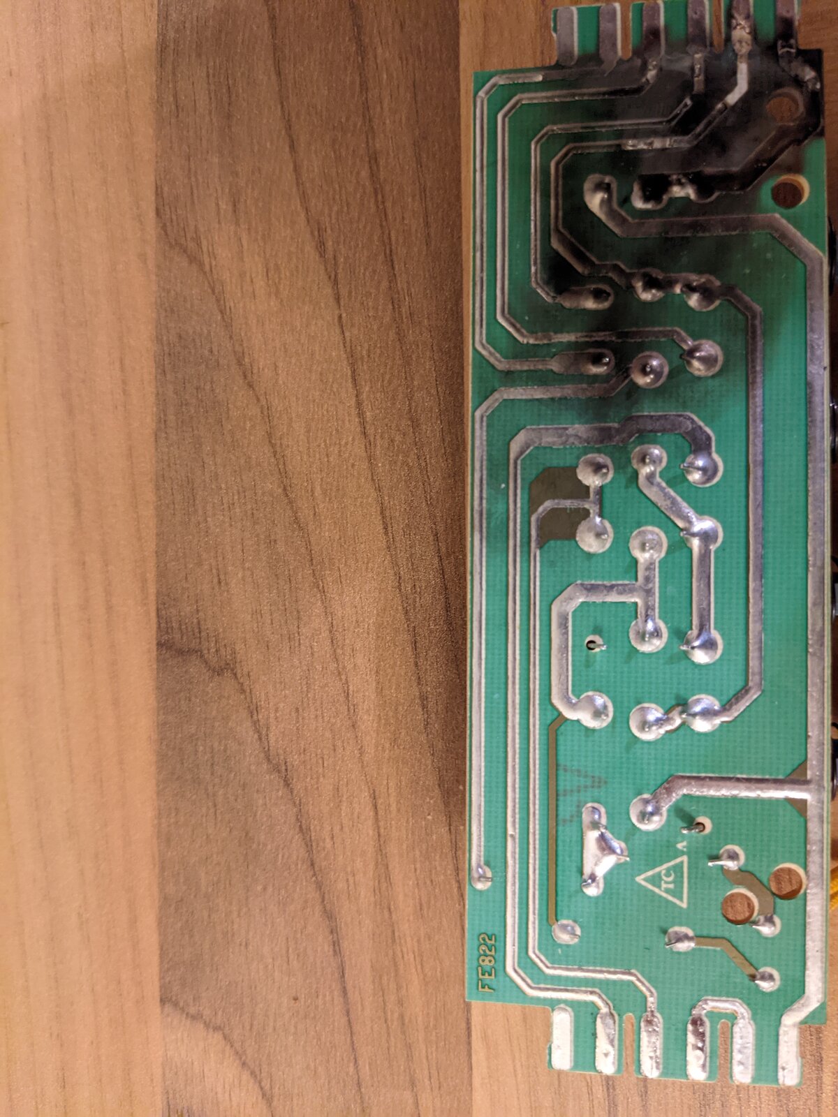

I'm sorry if you feel that Winston has not added any value to this thread. I have found his input very entertaining, especially after his assertion a few days ago that is not wrong.
He quite clearly posted
only to be faced with that beautiful photograph.
pxl_20211201_201616478-jpg.252822
:ROFLMAO::ROFLMAO::ROFLMAO:
One has to ask why the hood was not internally protected. After all FCUs are not available or compliant in most other countries.
Have you not worked this out yet whinny?
It's obvious...
1. As so many posters on here state, including you; The OCD it 0nly there to protect the cable. So in order to comply with the UK regs, (that is where I live and why I spend time in this forum called ELECTRICS UK) the flex requires protection with an OCD somewhat smaller than 16A. In the UK we are fortunate enough to have some better requirements and facilities than in those other countries you keep bleating on about.
2. Why should manufacturers fit this pointless additional fuse when the fuse in the FCU or plugtop (required to comply with UK regs and regularly recommended in their instructions) is perfectly adequate for the purpose?
The manufacturers are rubbing their hands with glee everytime someone like you disregards their instructions and installs without the required external fuse as they know premature failure is likely and likely to result in another purchase of their product.
