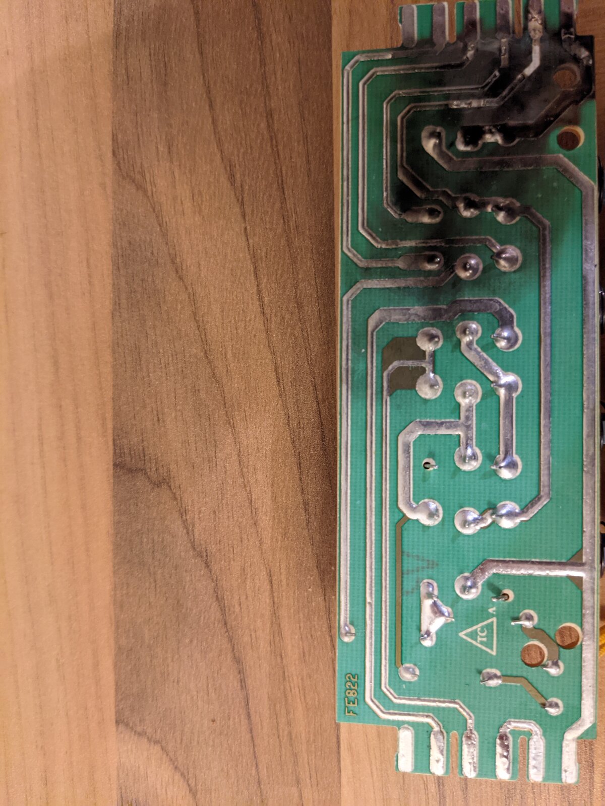

Ok so I've managed to borrow a multimeter from a friend and checked the supply at the junction box and it reports as 240 v.

In that case the next step is to find a way in to the case but not knowing your mechanical abilities I don't know whether to advise:
1. Working out how to remove panels, or
2. Seeking help from someone else, or
3. Replacement.

I would agree with W here. When you measured this voltage it was presumably across the metal of the contacts in the junction box. At this point I would be checking that the cable coming out of the connections going to the extractor were made correctly. In other words I would take the wires out, examine them and then put them back carefully. A failing bulb can take a fair bit of current, But to fuse the wiring inside the unit sounds a bit extreme and unlikely. It seems much more likely that a poorly made joint failed outside the box.

Wires look fine at the junction box for both the supply and the cable running to the hood, well secured in the terminals, no black marks on the insulation, no freyed ends. Electrolux offer a fixed price repair for £150 so will do it.
Ok so managed to extract the PCB, I'm not an electrician but it doesn't look healthy.

Whoa!
That's impressive! :eek:
It's possIble some PCB traces have been damaged.
And if that's the light switch (edit: yes, I believe it is the light switch!) above, that may also be toast! :(
Can you wipe off some of the soot and take another pic, and one of the other side of the PCB?
As linked earlier, the spare PCB from Ransom, is £52
https://www.ransomspares.co.uk/parts/brands/electrolux/cooker-hoods/efc70710x (94249236400)/push-button-switch-board-pcb/114247.htm
But, the connector blocks on the side also need checking for damage.
Also, good job of getting to the issue! (y)
I think you should buy a new hood and not waste any more time on your current one.
