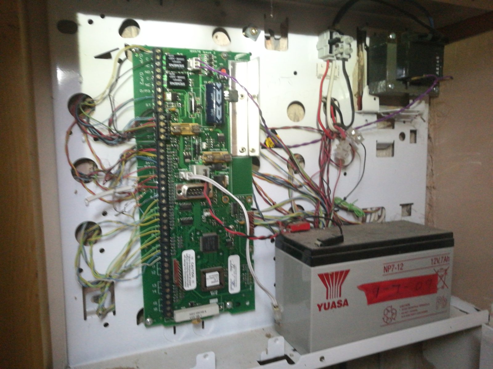

Got the cover off and no tamper....can see a big old battery which costs about 15 quid.
Any precautions for disconnecting it?

Not really. That no tamper thing surprises me. Was there a switch on the inside top of the panel? That battery is 3 years overdue for replacement anyway.
Pretty much what I thought.
With regards to clearing error codes...is there a way without resetting the system?
That tamper switch that's on the end of the white cable ( not ) now in a connector block ....lol
Ye it's not connected to anything!
I've got all the manuals here with writing on them...but no engineers code :(
Replace battery enter user code , it should clear , worst case power down and re power up , enter code , twice , reset time and date ....
Yes yes that is a bit of an issue. Hell, I own a similar panel with a similar board in it. Should have seen that right away! Let's hope your panel is in a place that is hard for a burglar to get to!
With regards to what Sparky said, follow his instructions. That's basically what you need to do. Just make sure that keypad you opened is properly closed or you'll have some more fun with clearing that issue!
