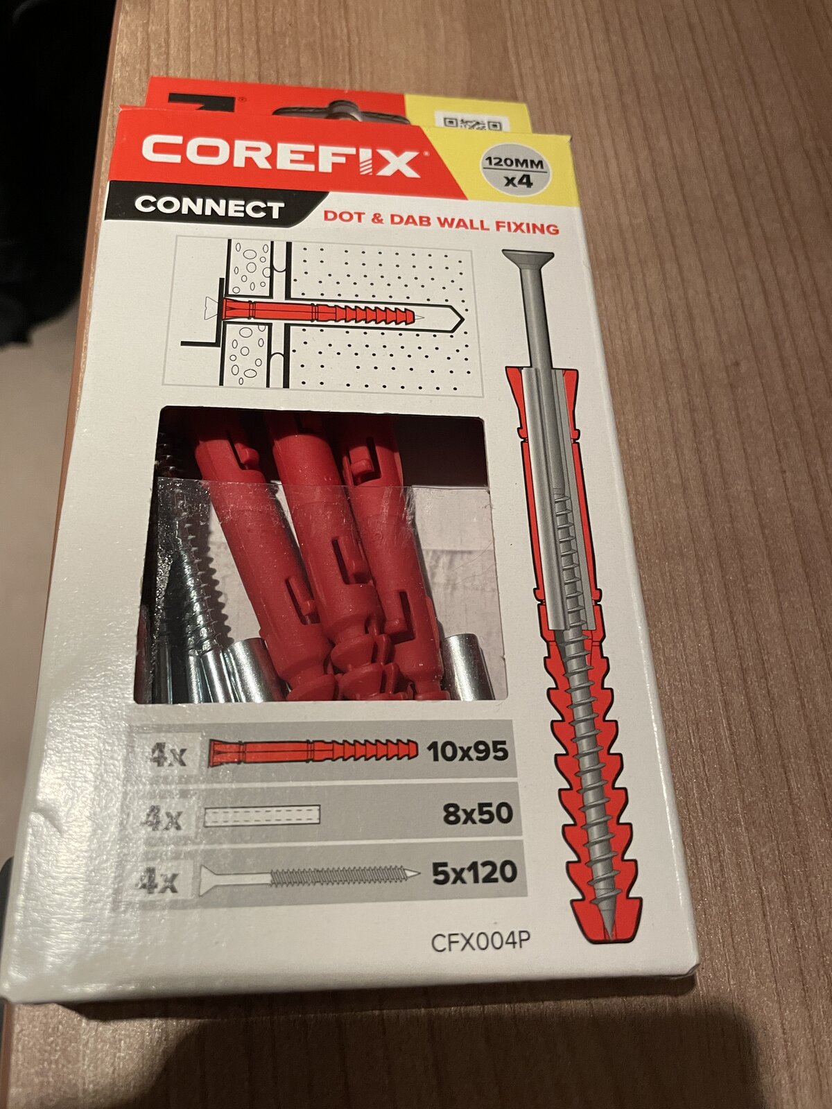

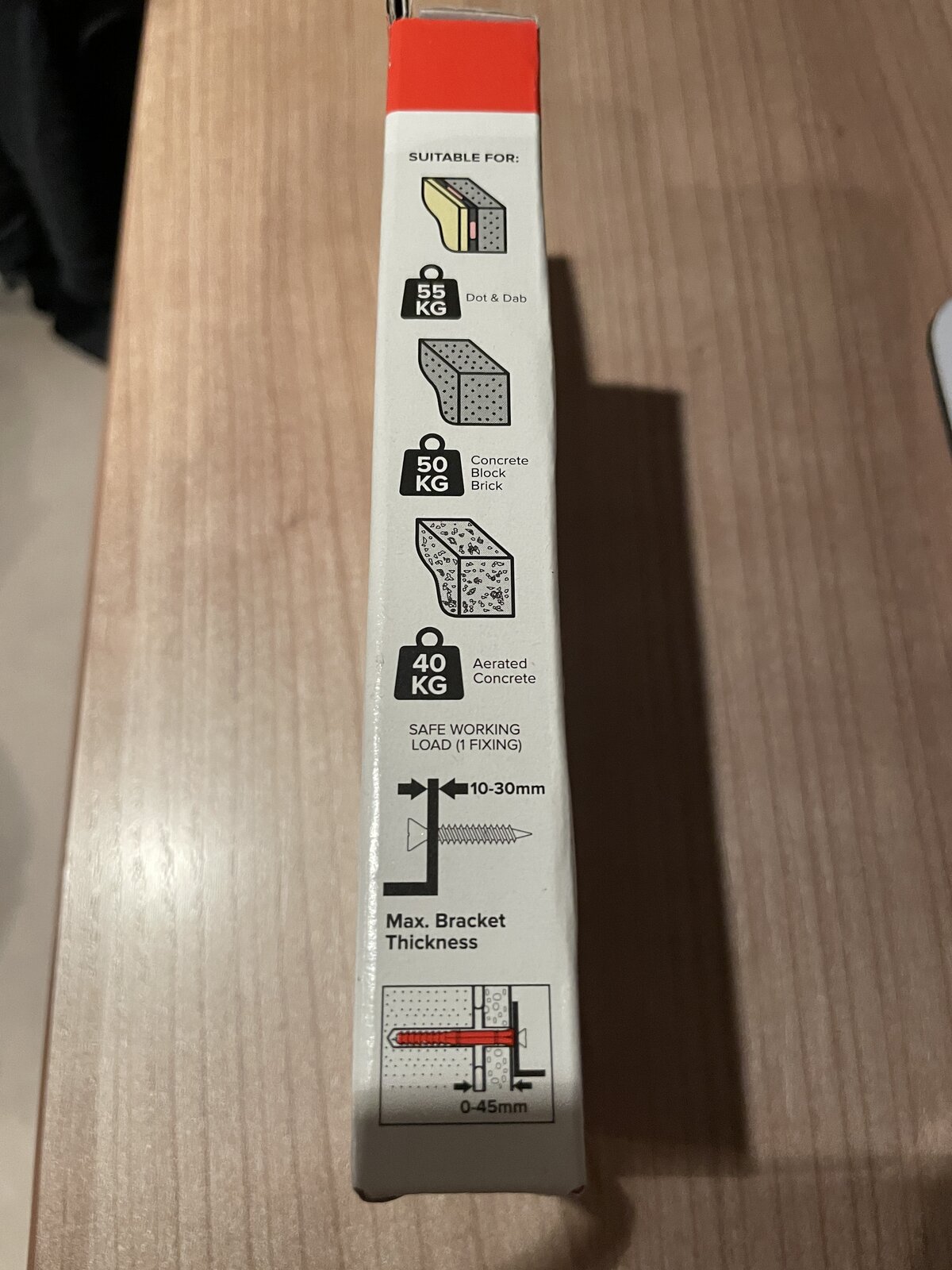

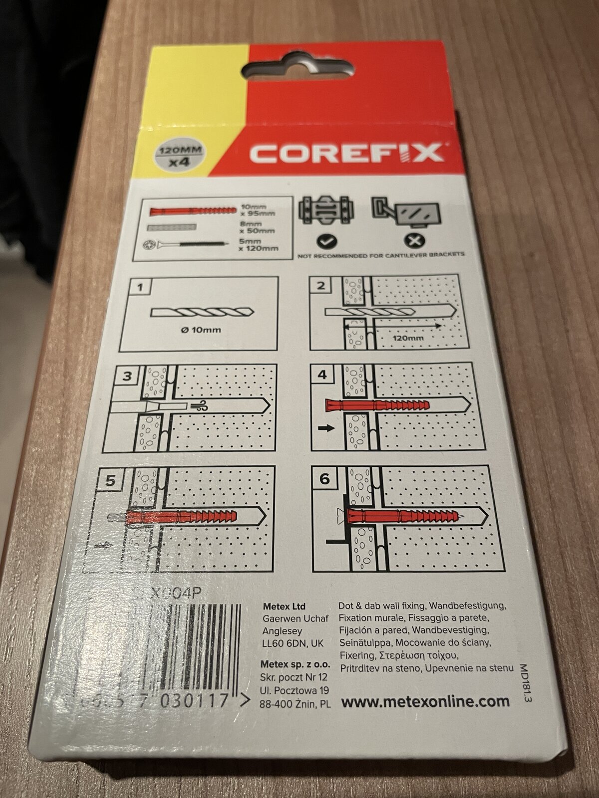

I am planning to use 120mm corefix to hang my radiator brackets off
The wall is dot and dab onto thermalite blocks
The packaging (see photos) says to use a 10 mm drill bit, however, I was wondering as the thermalite blocks are so soft, would anyone suggest that it were better to use a slightly smaller drillbit instead?
Any help and advice is appreciated

View attachment 382454View attachment 382455View attachment 382453

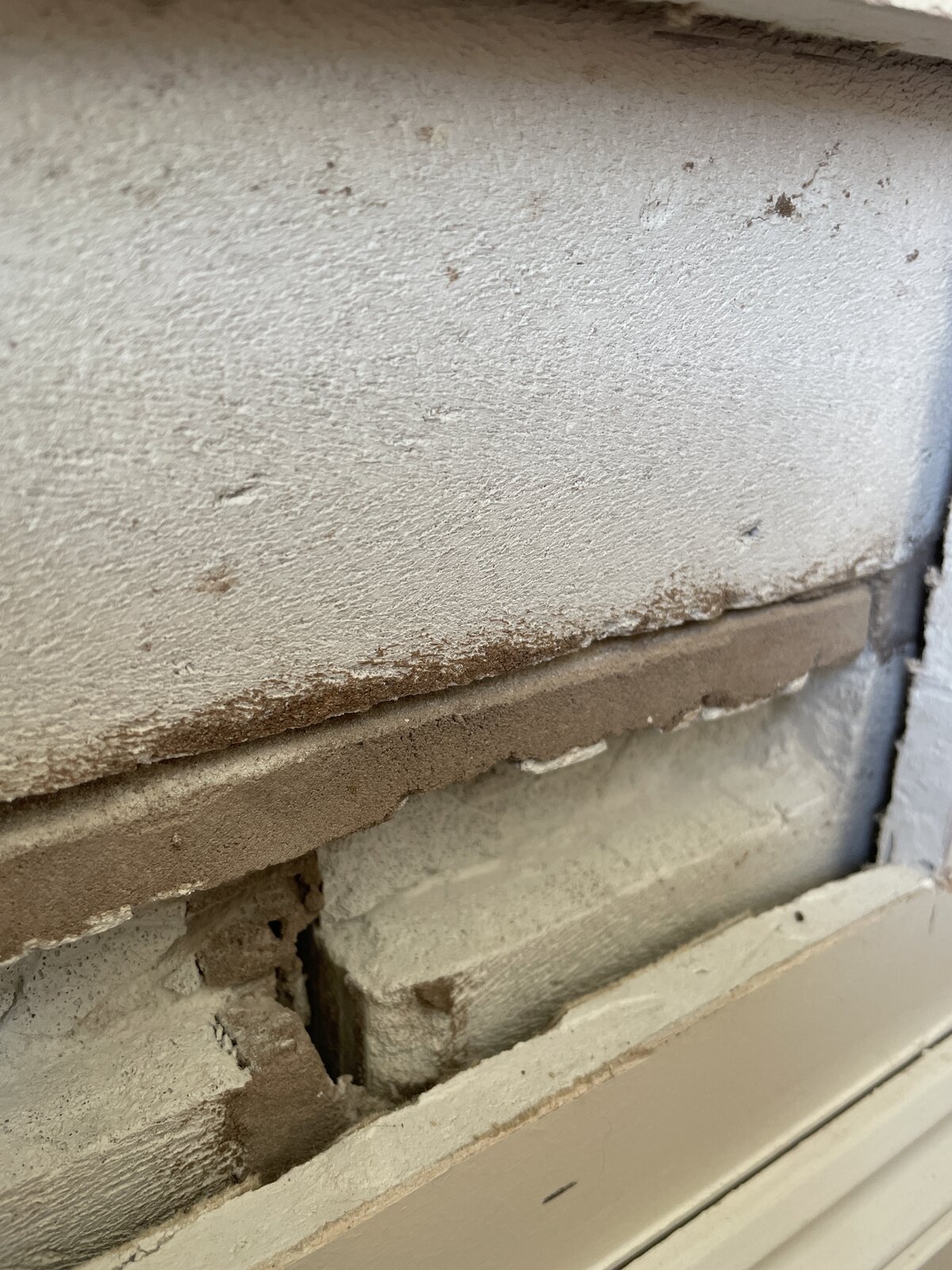

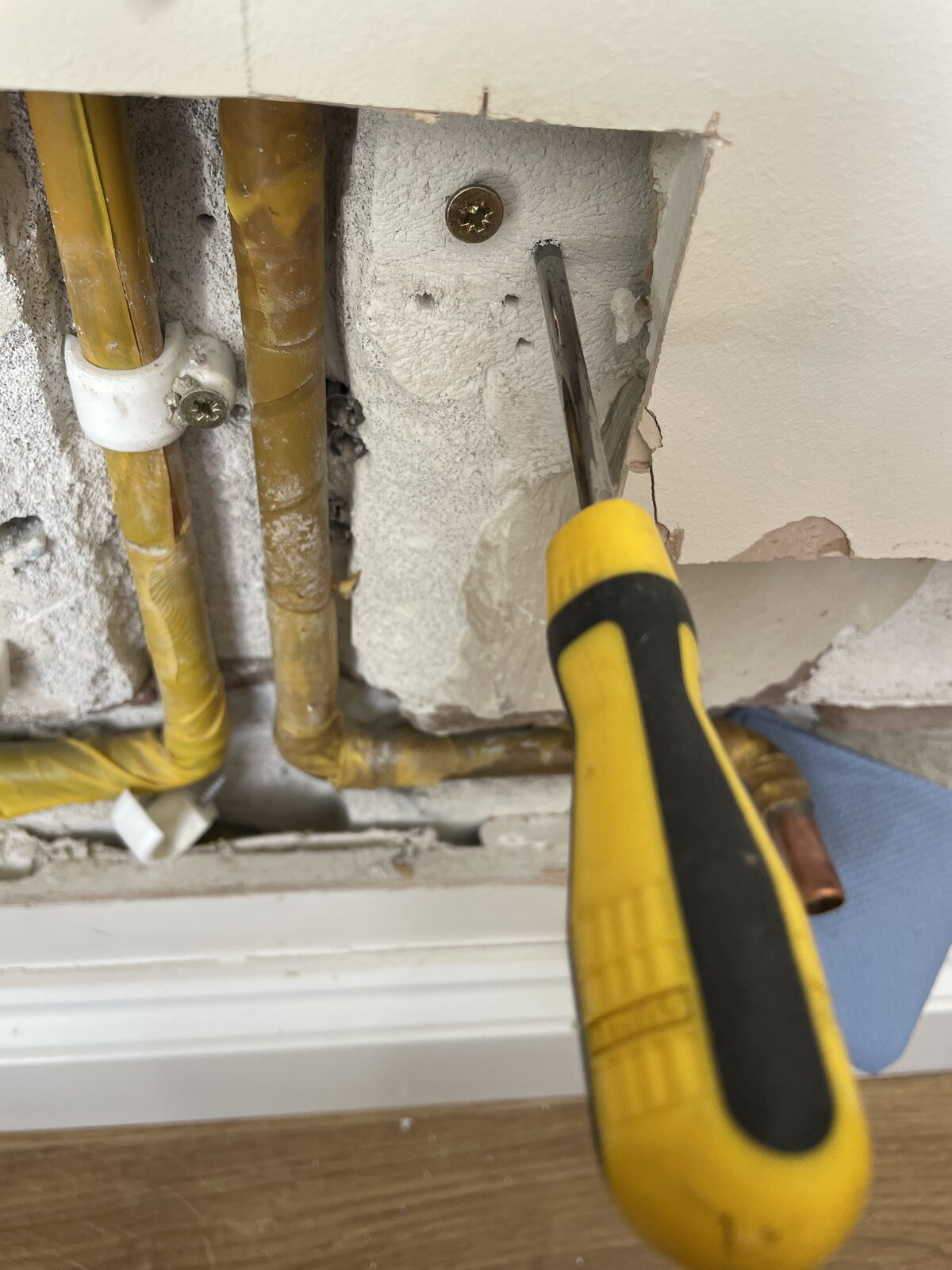

Here is a photo of the blocks
Personally, I’m not sure if they are thermal or thermalite ….. any idea from this photo please?
You can put a screw in without any real force whatsoever and likewise a screwdriver as shown
This extension was built back in 2011 if that helps also as to what products were being used by builders at the time
