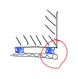

Dear Experts,
Black is existing wall; grey is new plasterboard, mounted on 25x38 battens to provide a gap for pipes etc. It will eventually all be skimmed. This is a corner of a deep window ingo.
Question is, how best to do the bit circled in red to suit skimming? There will be a corner bead, which I think have 25mm sides, don’t they? (Can you get wider ones?) Options I can think of are:
- Batten right up to the edge, then try to skim over the batten - will the plaster stick?
- Set the batten back from the edge and try to fit a 25mm wide bit of plasterboard over the batten.
- Fix some plastering mesh over the batten.
- Set the batten back a bit and try to stick some plaster or other filler over it.
Any suggestions?
Set the batten back and screw plasterboard to the wood.
The plaster will crack otherwise.
plenty of scrim tape between the p/b and existing wall.
