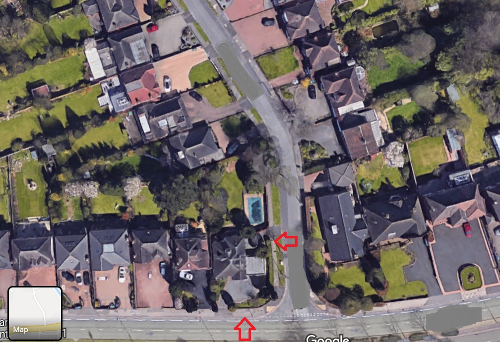

Corner plot dormer bunglaow
2 Sep 2015
330
6
Current property. It has a front drive which can hold approx. 6 cars.
The unbuilt section at the side rear is a second driveway.
In front of that is a double garage - flat roof.
The side boundary has a large Laurel hedge which is approx. just under 3m in height.

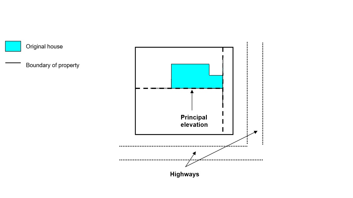

Proposed plan is to build a single storey extension where the current side drive is. As it will be in line with the side and rear of the property, I take it this will come under permitted development, am I correct?
I have seen this on the portal page
Question;
What are the chances of getting planning permission if I wanted to extend further out towards the side boundary line? I was thinking of 2m (out of the 3m) ?

Your side extension you are proposing behind the double garage needs planning permission; it is a side extension that extends towards a Highway. You don't have a 'building line' set by the furthest wall of the garage.. the building line is the outline of the original wall(s). Read page 15 of the Technical Guidance (and the 2 images that you haven't included from that guidance) and apply that to your staggered side elevation.
I'd say it's going to be difficult to extend even further towards the Highway.. You're probably going to have a lot of extensions to the main dwelling to the side, might start to look a bit bulky / clumsy, although that plot on the opposite side may be of use in terms of precedent - Check when that was built / approved and the local policies R.E. House extensions in your area.

Imagine for a second, your double garage wasn't there. If you were to add this proposed extension you would need permission because you are adding an extension (as shown as the grey shaded image on the Original Post) that extends off the side of the property (a side extension) and fronts a highway (falls foul of Class A, Part E).
Just because you have a double garage there does not now mean the proposed extension is not a side extension and does not front a highway - it does in either cases and whether the garage is there or not, the proposal does not benefit from Permitted Development.

If the garage is attached and original it is treated as part of the "dwelling" so the side wall of the garage is the side wall of the dwelling, therefore the proposal is a "rear extension". Or have the Council dropped a clanger????
Currently there is a double garage.
I dug old plans out, when the property was build it was built with a single garage - width of original property (with single garage) is approx. 12m
The extension width (behind the garages) will be 5.5m wide. Council have stated that as this is less than half the width of the original property (and not wider than the current total width (15m) then it will be permitted.
Even taking the above into account I am considering putting in planning permission as I may require 6.5m.
If it is original then yes it would be a rear extension. In either case it doesn't matter too much. The whole crux of this, is the proposed extension extends of the side wall of the main house (where the highest red arrow is pointing towards on the first photo) so therefore the proposed extension is a side extension (or maybe a rear and side if the garage is original).

They are confirming it's a side extension - I don't think anyone's really challenging this, but Under Class A, Part E, it says extensions won't be permitted if:
(e) the enlarged part of the dwellinghouse would extend beyond a wall which -
(i) forms the principal elevation of the original dwellinghouse; or
(ii) fronts a highway and forms a side elevation of the original dwellinghouse
It's clearly caught out by (ii) regardless of it's width as it extends off the side of the original house towards a highway. (covered in my replies on the 11th) I won't go on again because it's been covered and the OP is probably not going to go against the advice he's getting from his own LA especially when their interpretation seems to benefit him (which is fair enough)
