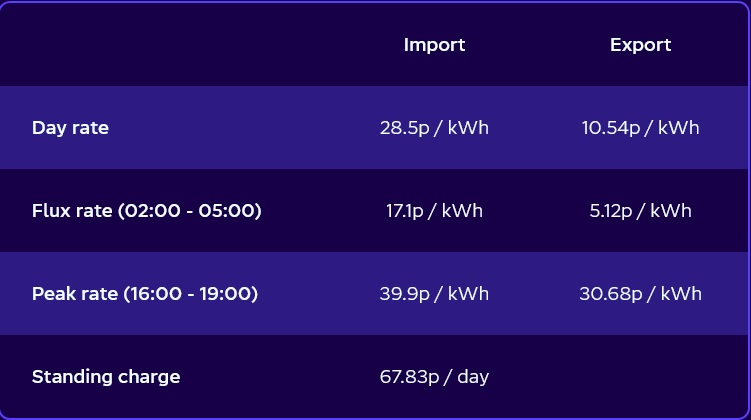

It seems to have no reason behind the tariffs, compare Octopus Flux and Go, where Flux is claimed to be designed for solar with batteries, and Go is for EV users the rates Flux 1757859446629.png has an off-peak, standard, and peak. The off-peak only 3 hours, and the peak 4 pm to 7 pm may work out OK in summer, but winter I may well run out of battery by 7 pm and by 4 pm I am being careful what I am using, so one would need a massive battery and be active ensuring it is charged before 4 pm, so one can export at the 30.68p/kWh, for me far too much hassle.

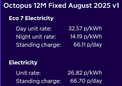

The storage heater rate 1757859919562.png seems good at a quick glance, but the night rate is still much higher to the Go rate for EV users. And I do not need 7 hours off-peak, it takes around 1.5 hours to recharge my batteries, but the tumble drier runs for nearly 2.5 hours, and depending on when you set it, you have ½ hour or 1 hour increments of delay. Setting it to line up with a 3-hour off-peak slot can't really be done. So either to start or finish it will be using battery.

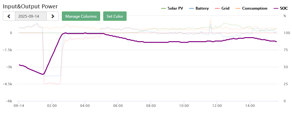

So today solar has not kept up with demand 1757860807626.pngbut the battery state of charge (SOC) is enough to likely reach 00:30 tomorrow when off-peaks starts without running out, as charged up overnight. But Friday exported 17.8 kWh, so the EV tariff works well, 8.5p off-peak 00:30 to 05:30 and 30.17p rest of the time, which I rarely need to draw on, and export rate at 15p/kWh so if I import more than I need, I am not loosing.
