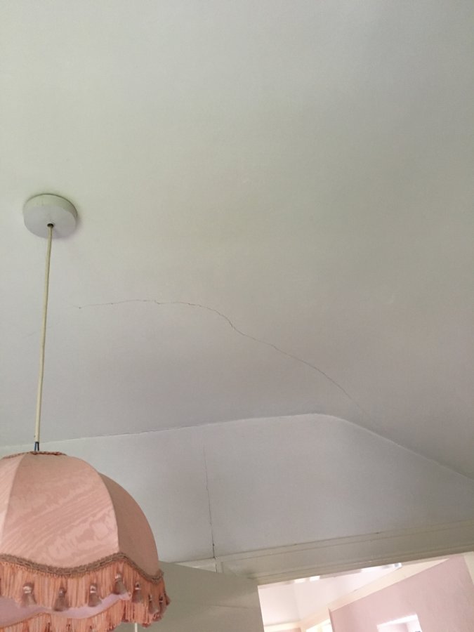

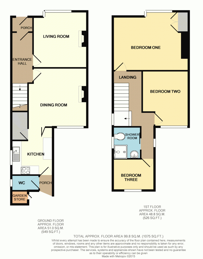

The second cracks are in the ceiling of the back of the house, bedroom 3 in the floor plan.

Looks cosmetic to me! Probably plaster/render failure, could have been a little movement that has caused cracks, but does not look sinister.
If you are in doubt a structural would be worth considering.

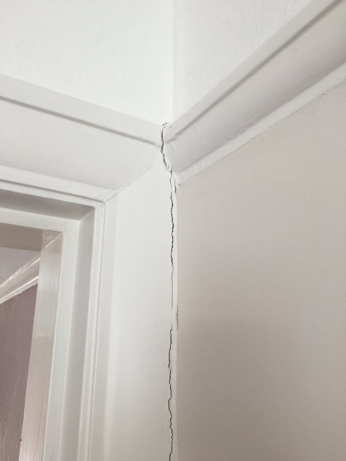

Cheers for reply! I Just remebered I took this also.... On the same side in the front bedroom there is this crack on door frame
Are there are cracks on the outside of the house? 1937 transition from double skin walls to cavity walls, what yours? Cracks like yours are safe if they are historical (has the property been re-decorated since 1937?). If they have happened over the last 5 years could be the house is moving about? - is it on a clay subsoil? are there trees nearby? broken drains?

Door frame crack equals 1mm every year? How long long do you intend to live there for? :) I would just use a bit of filler in them for the time being.

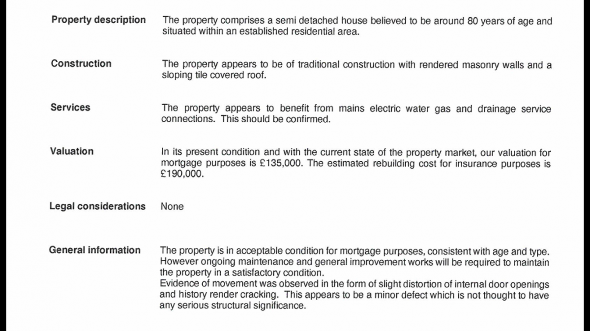

It doesn't say who carried out the report and in the report it did say signs of moment in door frames but thought to be historic. Which kind of satisfied me for a short while until people were saying the valuation is just for the bank and probably wouldn't tell you if something was going to be a problem, just isn't yet.
So I've been worrying because I haven't got a clue about anything building ha.
I did ask the bank who carried out the valuation and they said they couldn't tell me/ didn't know?
This was the report.
Well the surveyor has noted the cracks but hasn't followed on to determine the cause. Pretty typical for mortgage valuations - did the surveyor wear a mask & gloves?
No mention of a problematic location - a hillside or a mining area.
There's no way I would advise you one way or the other.
If you really want the place perhaps go round with a local builder or a SE?
