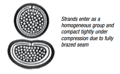

http://www.tnb.ca/aus/pdfs/Sta-Kon_Wire_Termination_and_Insulation.pdf
For their Ring terminals page G4 Seems to suggest there crimps are ok. but recommend to use a Double ind-enter tool with solid core rather than a single indenter tool.
Though they look like they have other bonus features compared with the average type sold.
on page G92 I see a reference to "For solid or stranded wire #20 to 4/0 AWG" and on G23 "solid or stranded AWG" but of course I am not familiar with AWG.
I haven't found anything yet that says "not suitable for solid wire."
No, but you have found that double indent tools are required; this is not what is usually used here.
The first two pages mention 'strands' several times as if that is normal.
There seem to be a multitude of tools and dies.
Does page 92 look like the typical work?
What would happen here with a solid conductor?
Does that look like what we're used to?
