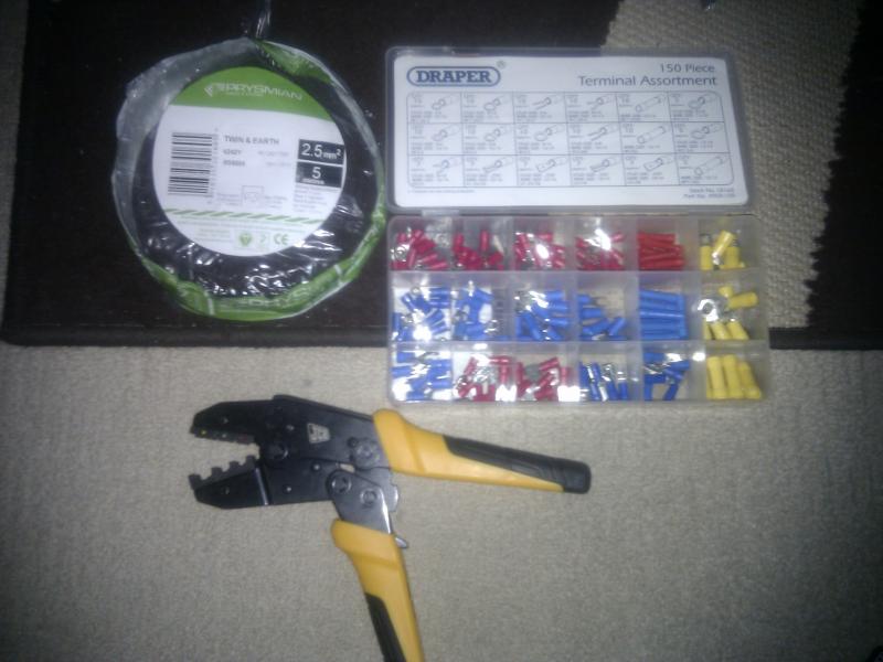

This is what I bought:

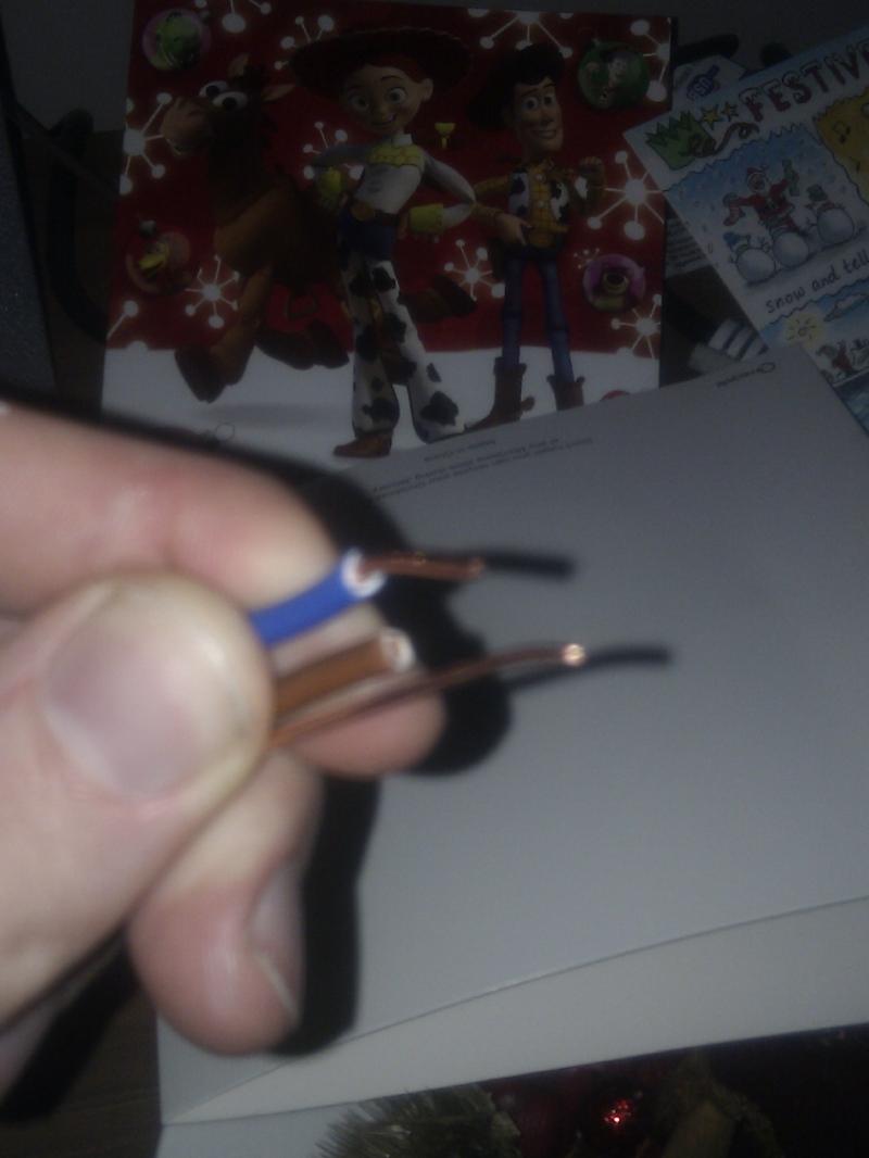

Can you post a clear close up photo of one of your crimped joints? Use the macro function on your camera if it has one.

Or the cable is not 2.5 !!! Can you post a picture of the cable and each end your trying to crimp together and we an look closer at it.

Here are some closer pics of what I'm using (crimpers are fully closed in the pic);
Two things about the crimping tool;
1, the jaws are the wrong way round ie. the yellow one should be closest to the piviot not the red ones, but that shouldn't make much differance using the blue terminals.
2, the jaws look like a set i've got, and on them one side of the jaw crimps more than the other, so try putting the terminal in the jaws from the other side, looking at them i would say the wire should stick out to the left side if looking at them from the top
You should be able to tell from looking at the inside of the dies which side the conductor should enter.

I don't use ratchet crimps that often, but from memory it looks like your jaws are not the correct type for your crimps? Are they for telecommunications industry perhaps? Also you say you got them from B n Q but they are branded JCB; anyone know if these guys make good handtools?
Get a pair of CK crimpers and buy your crimps from a wholesaler, they are much cheaper that way, or ditch crimps and use Wago push fits or Ideal Twisters.
