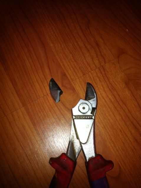

cutting bus bars - how do you do it?
Told you
