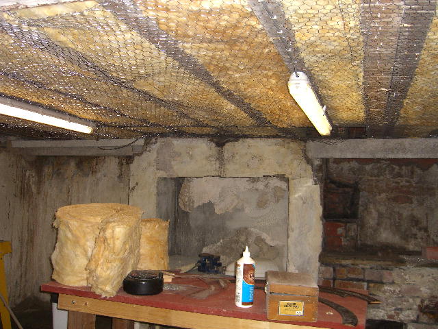

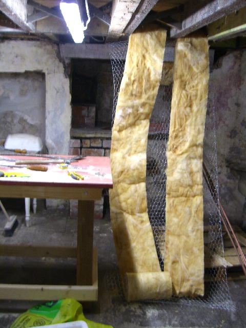

Thanks for starting this thread -some of the advice hadn't even occurred to me before. I insulated my living room floor today along the same lines!
(Still a bit to do)
