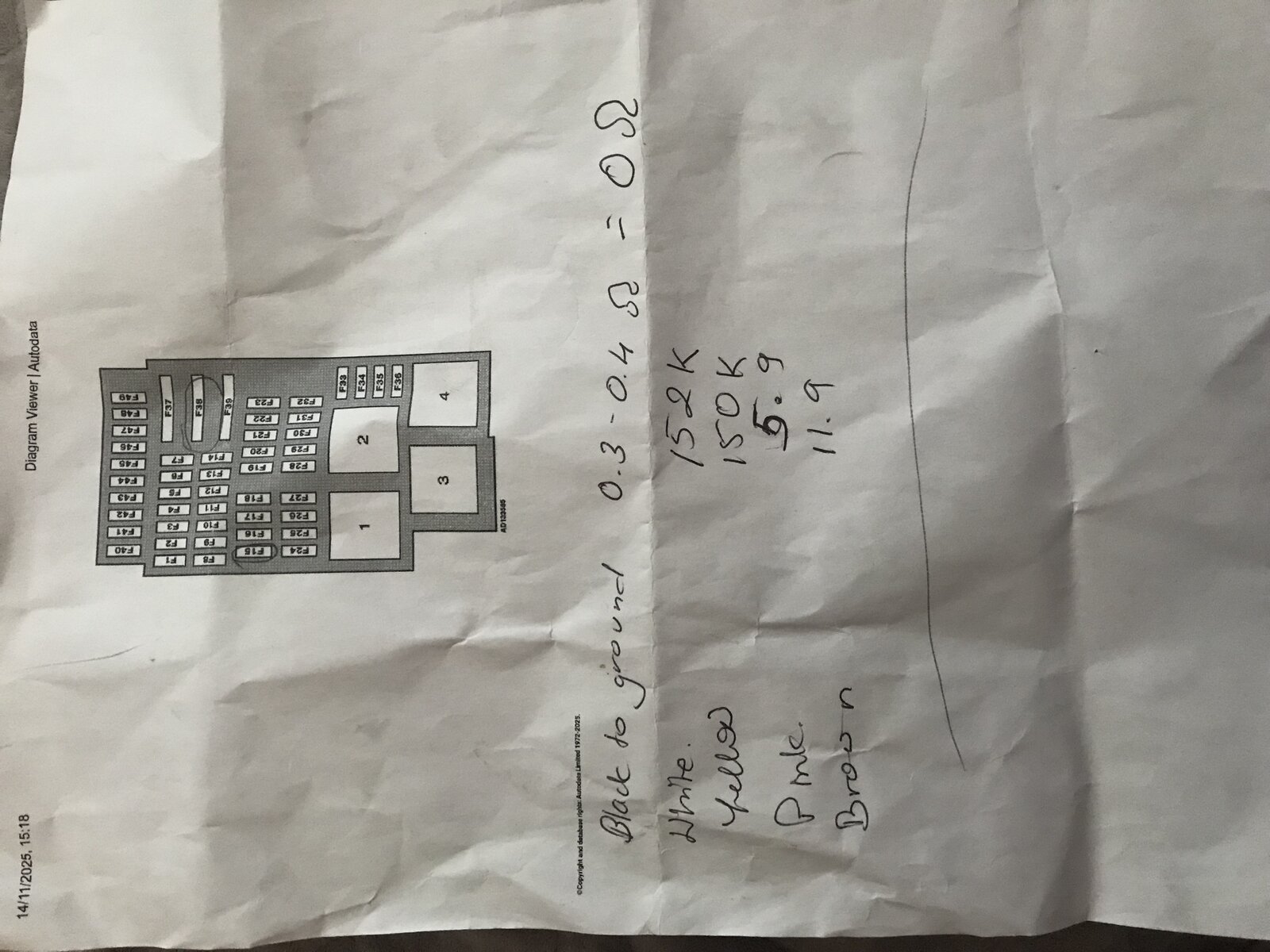

Looking for electrical figures for car is a nightmare , just testing the wiper motor as it was blowing a fuse straight away when trying to use the wipers, I tested the resistance of each of the pins to ground and got the results below, I think they look ok but having little doubts so was wondering has anyone have any insight on the test results

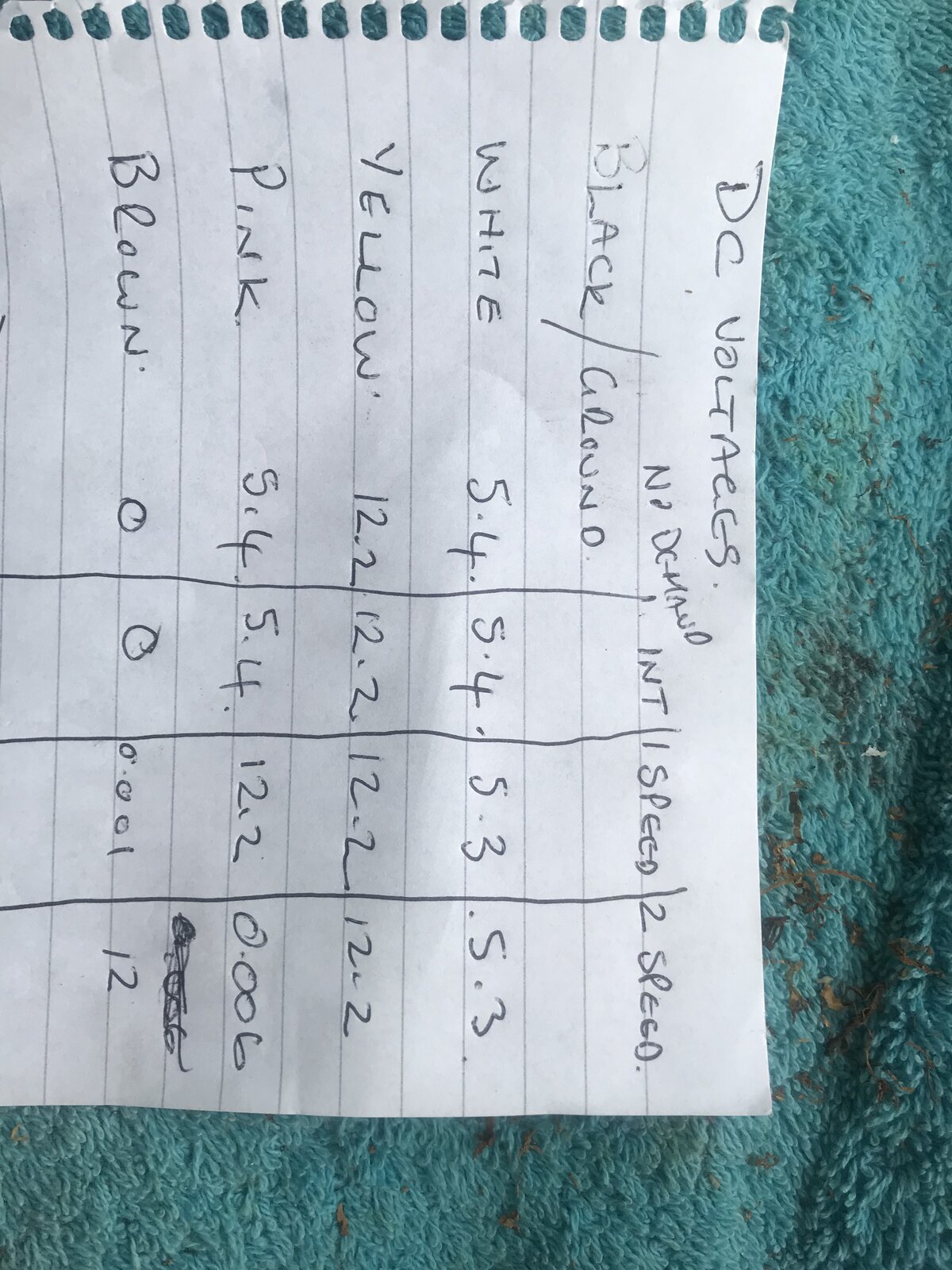

With connector to motor disconnected no fuse blowing, tested dc voltages to each wire in connecter with unplugged and got results below which seems to be normal well got no way of confirming that ????
My only conclusion is the motor but it was replaced with a non original part and was working for couple weeks but fuse didn’t blow originally ( old motor) but now with new part fuse does blow .

If the problem was the control unit would I still get the correct voltages? In my limited experience I thought I wouldn’t
How have you measured the voltages?

The voltages are already given Above

Where does it look there isn’t enough power ?
The figures given. You really need to test it with engine on, and off
Figures are very low. So is it a voltage/supply issue, that may be confusing the bcu too.

If those voltages are measured, engine running, then they look low.
If those resistances are to be believed, then the current at 12V would only be 2 amps and 1 amp, but that's a ridiculously low 24 watts and 12 watts. Typical wiper motor would be several multiples of that.
However they are probably unrelated as motors can't realistically be tested or much determined from the DC resistance when it's not powered.
Far too low, 12.2 suggest the battery is only about 50% charged.
Test again with the engine running, should be about 14 volts.
Yeah it’s probably more like about 0.8 amps
It’s was nearly impossible to electrically test the motor connected as couldn’t get my probes into the connector and didn’t have a
clamp meter for amperage. I mainly checked the resistance to see if I some sort of short
Don’t understand as it’s a 12v
