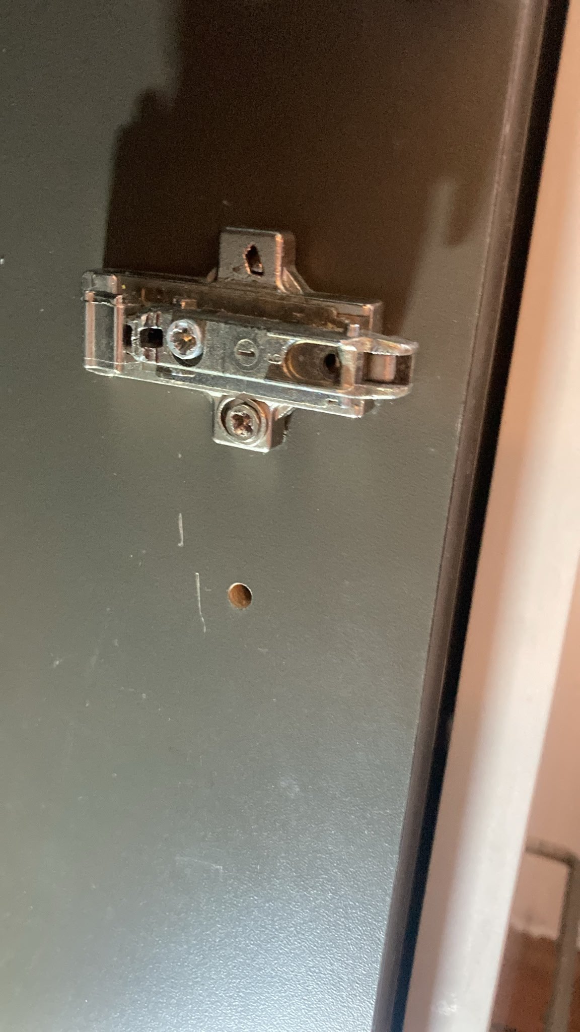

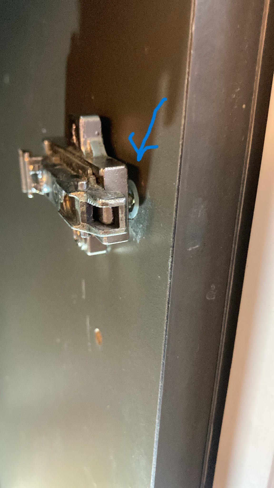

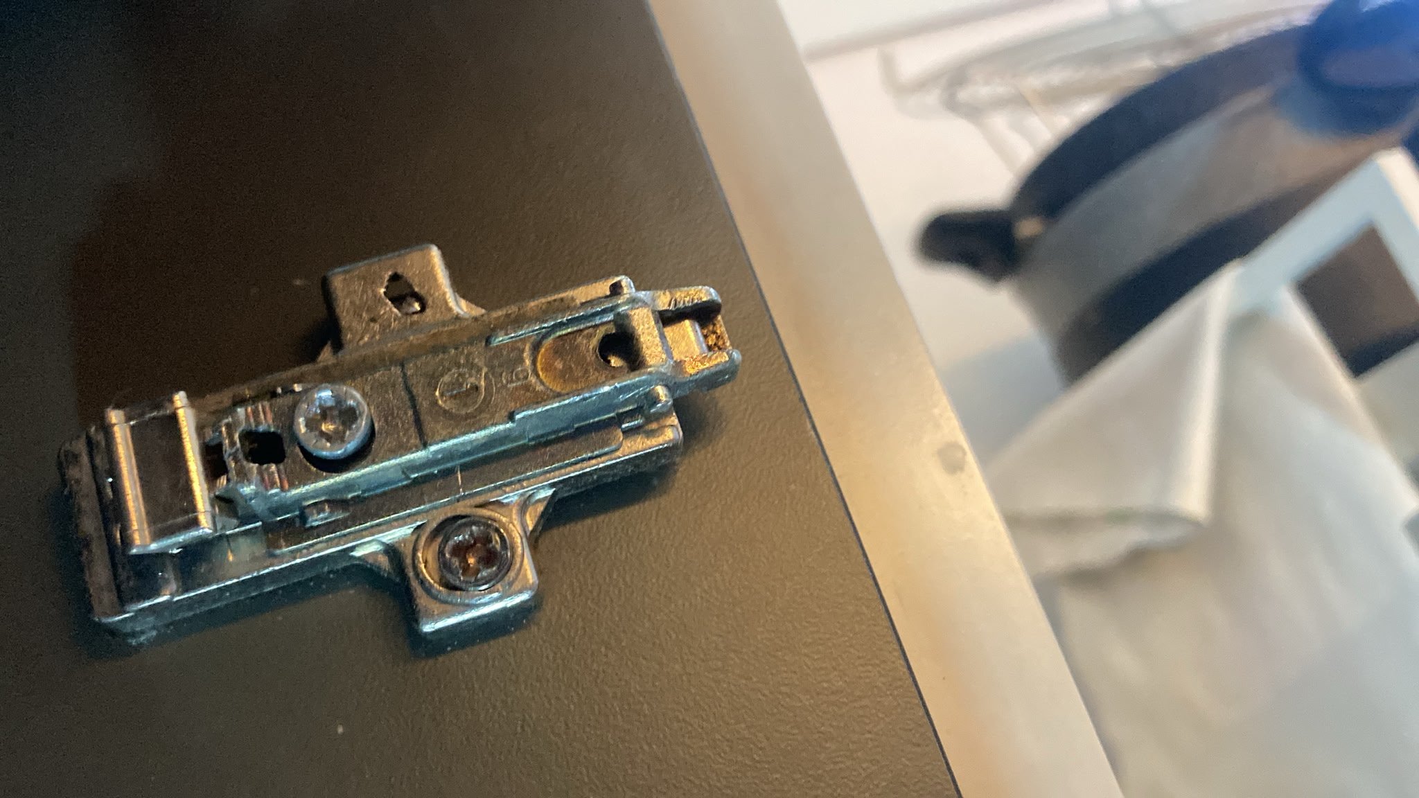

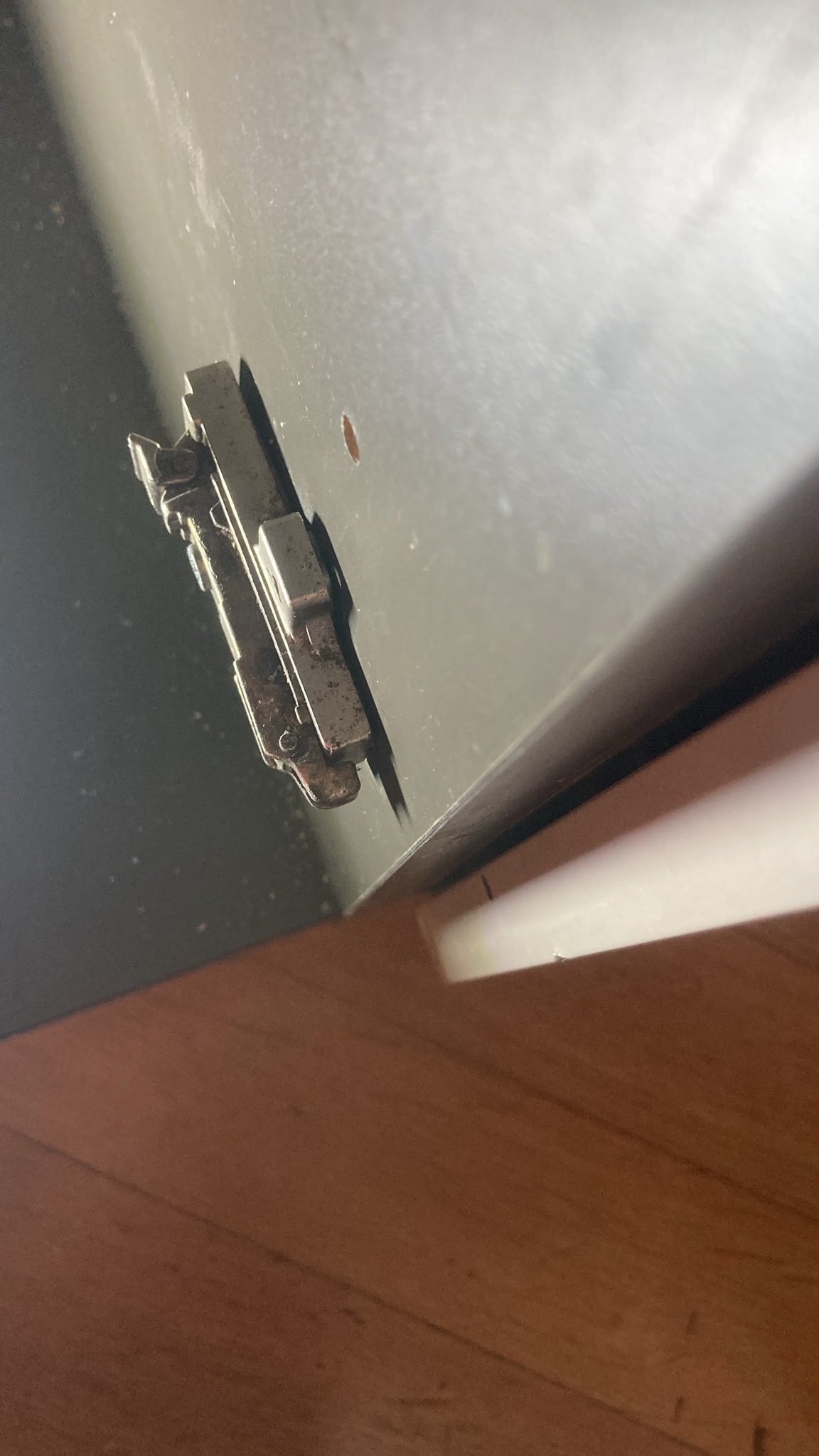

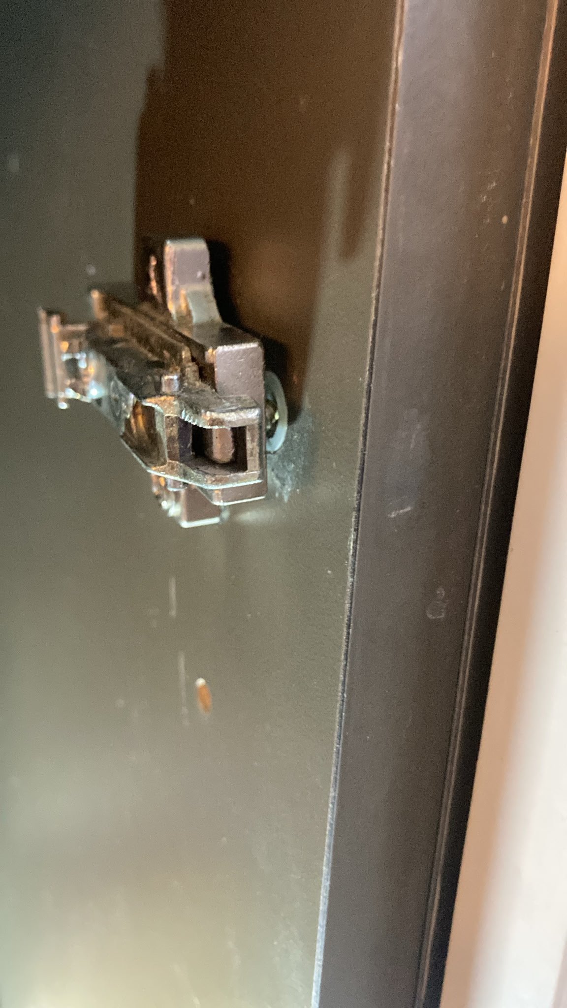

Hi
I have a Dada Kitchen, italian brand from 1996. I can't figure out how to unscew the base of the clipon hinge. The screw heads are unaccessable it seems that I need to reemove the adjustment plate. Anybody seen one like this?

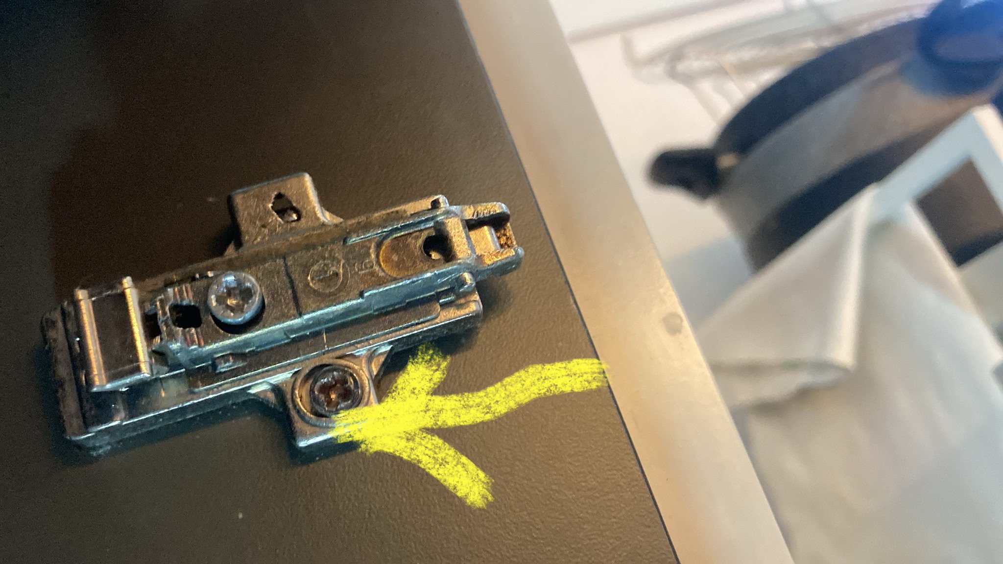

Yes that adust the height of the panel or door. there are 2 horzontal screws behind that fix what you see to the side panel

That is really odd. Image 2 looks like there is a screw hidden under the cruciform/ mounting plate.
That said, perhaps it is just a connecting screw between the two units.
As per @foxhole 's post, removing the screw that he circled should be sufficient.
The two slots exist to (ordinarily) move the mounting plate up and down.
The screw that @foxhole marked screwing it couterclockwise lowers the mounting plate then does not budge. Then other screw moves the plate left and right to its limit then doesn't budge. I could force then but risk stripping them. I seems that the cruciform plate should pop off revealing th.e mounting plate underneath. It is odd

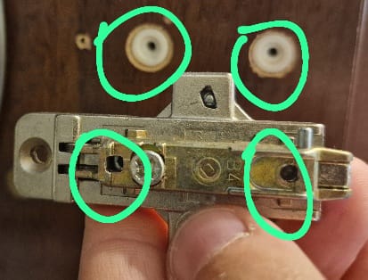

Thanks for your help I appreciate it, I found the solution on an italian fai da te or DIY site. you need to adjust he cruciform until you can fit a smallm allen wrench in the hole
