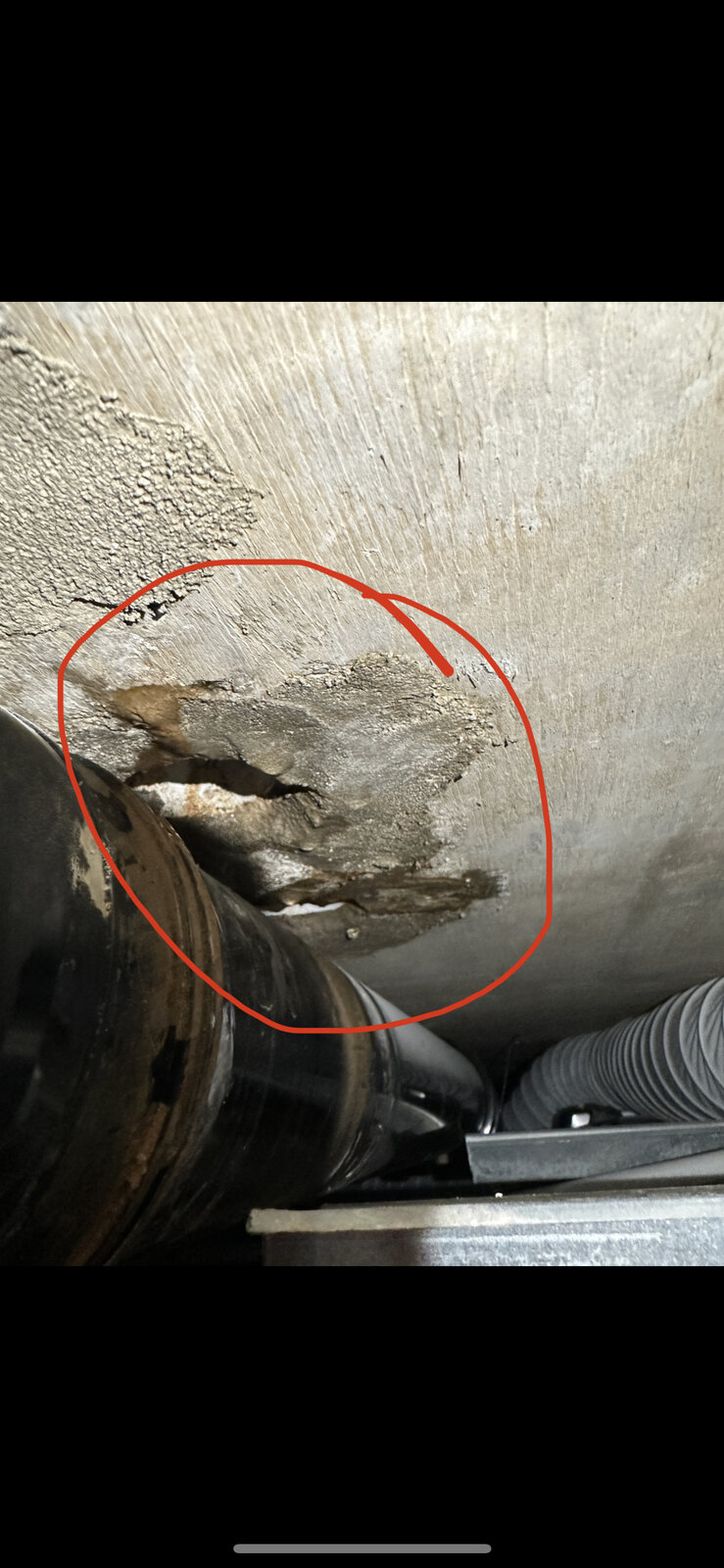

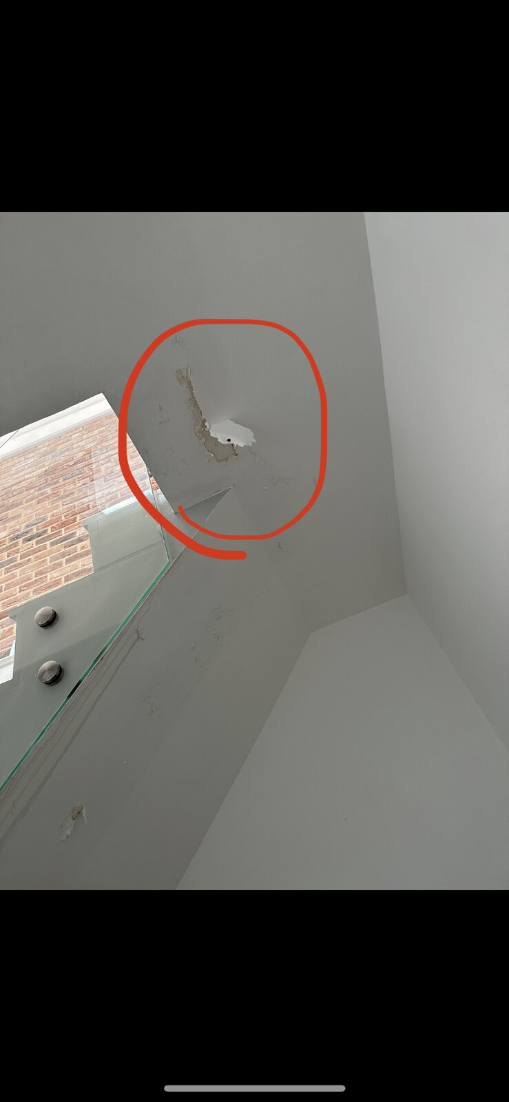

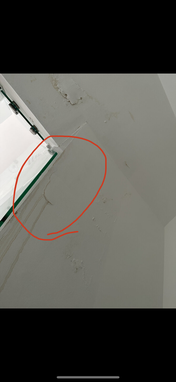

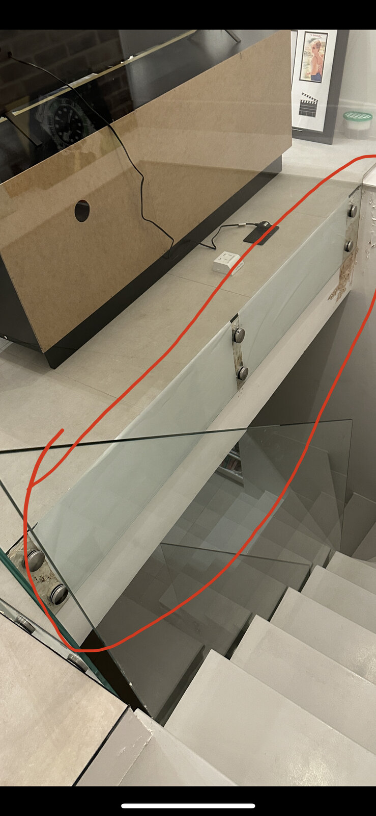

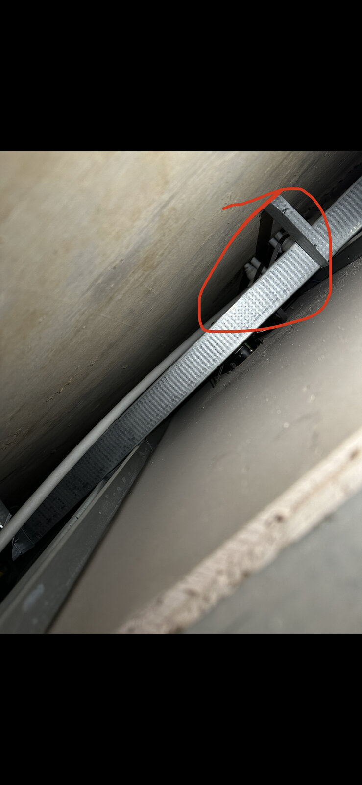

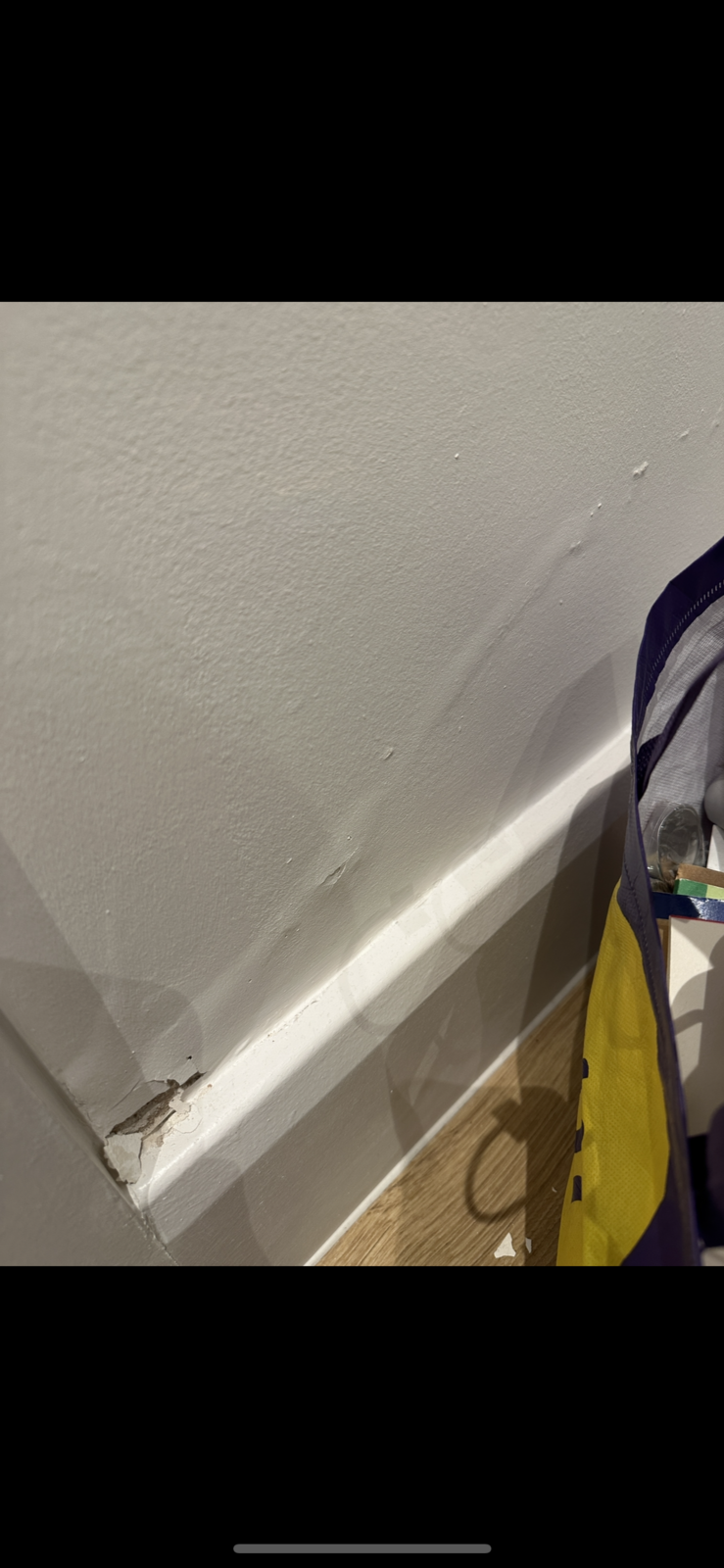

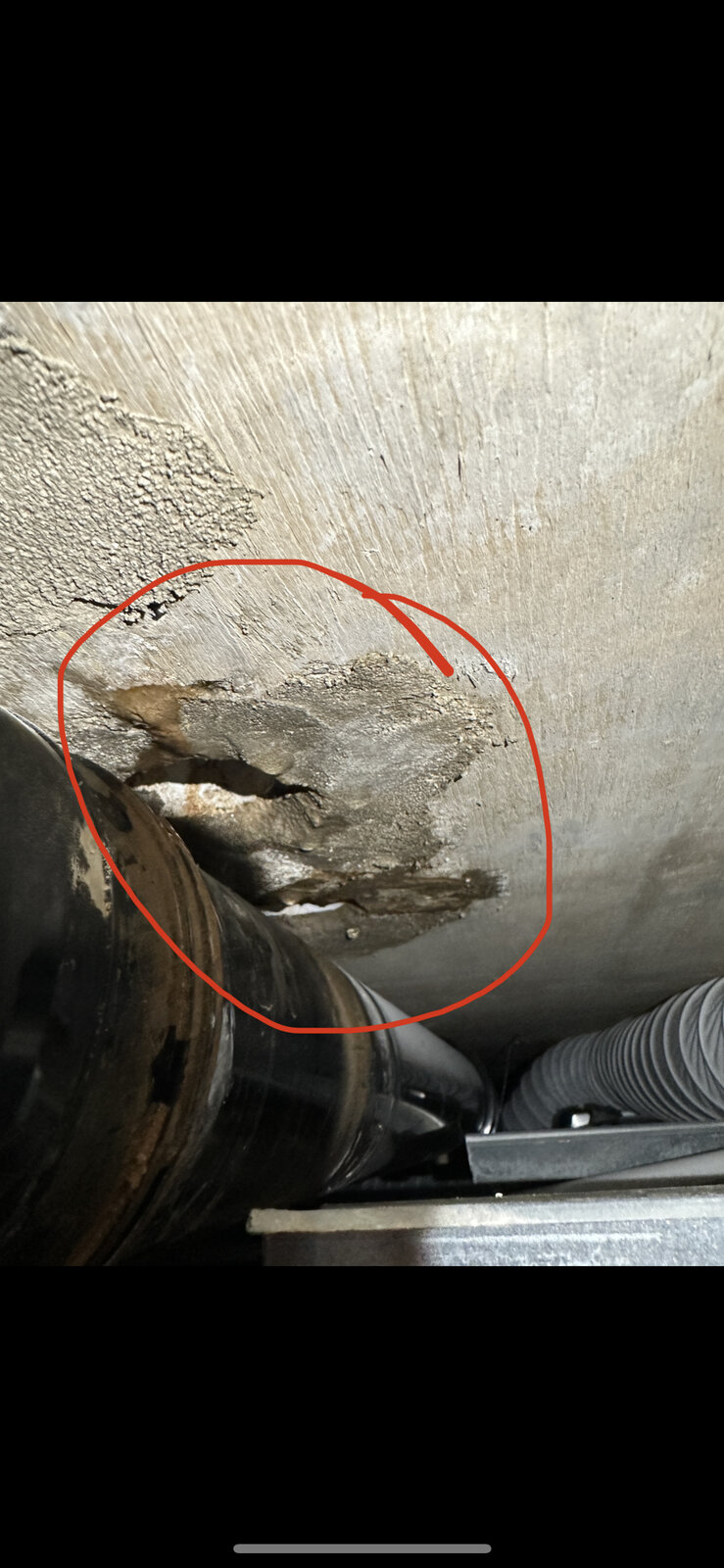

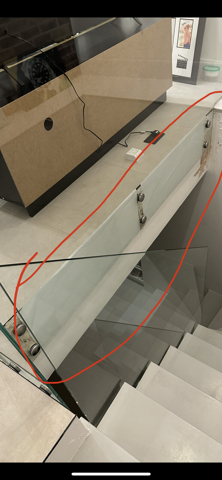

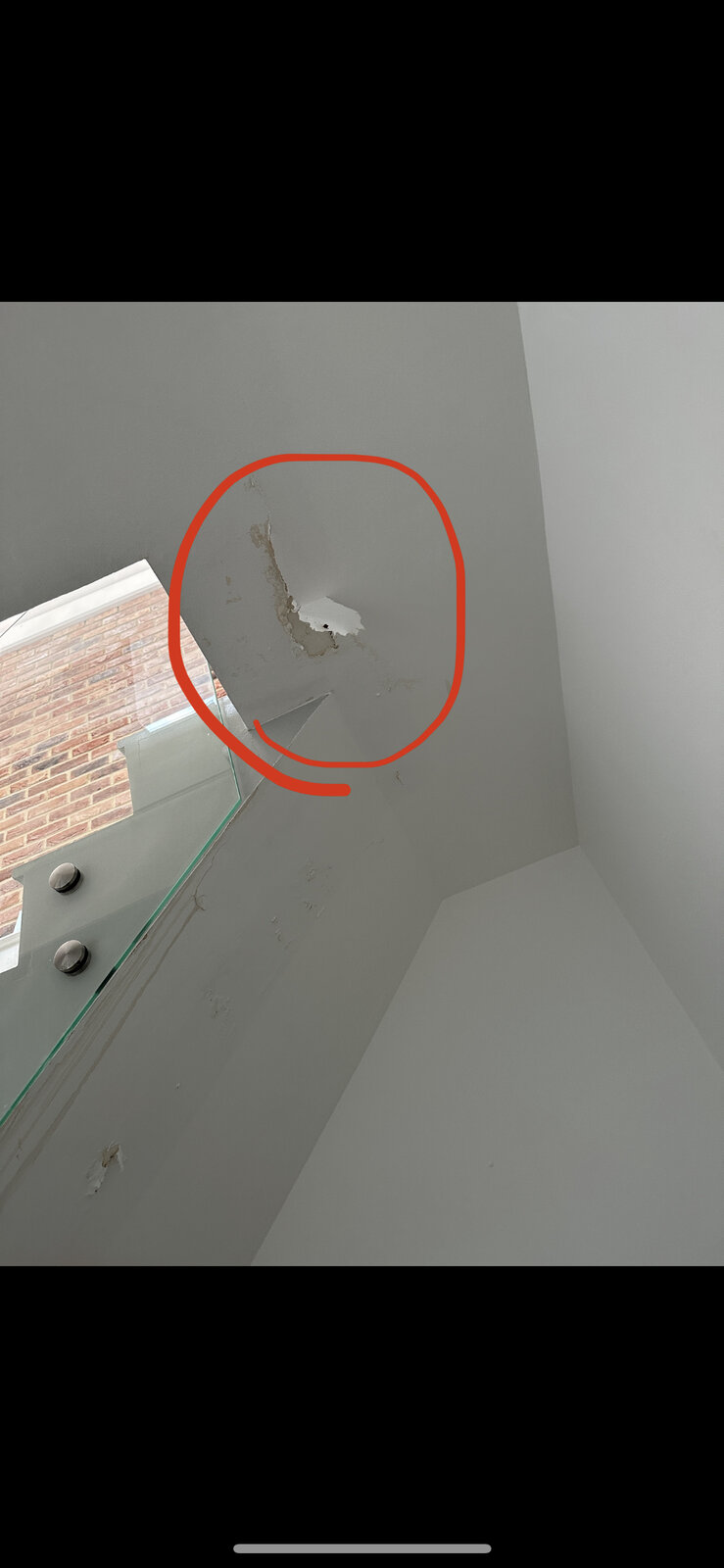

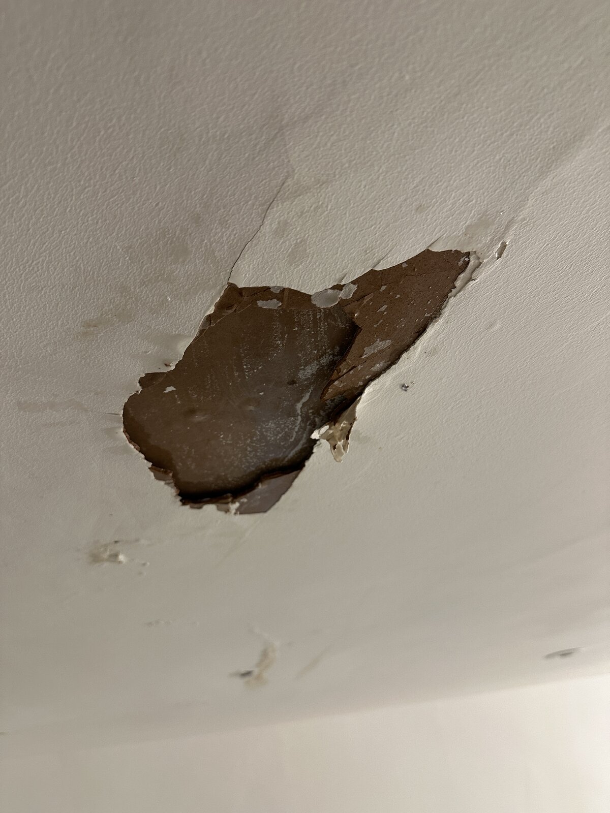

Since we moved in to a newly built house we noticed annoying damp stains, patches and the paint crumbling in a living room floor are - you can see it from the staircase. We've been trying to establish the potential cause of the issue and we failed. Had a plumber testing our boiler and underfloor heating - nothing was found. Leakage detection company could not find anything odd. A couple of days ago, we noticed an actual leakage with the water dripping down the ceiling in our basement level. It also started leaking from the floor connected with the staircase. We're starting an insurance claim. An emergency plumber cut holes in the ceiling to access and be able to view the issue. He could not locate the exact location of the leakage and advised to turn off the water supply in order to dry the area and to be able to return and investigate further.

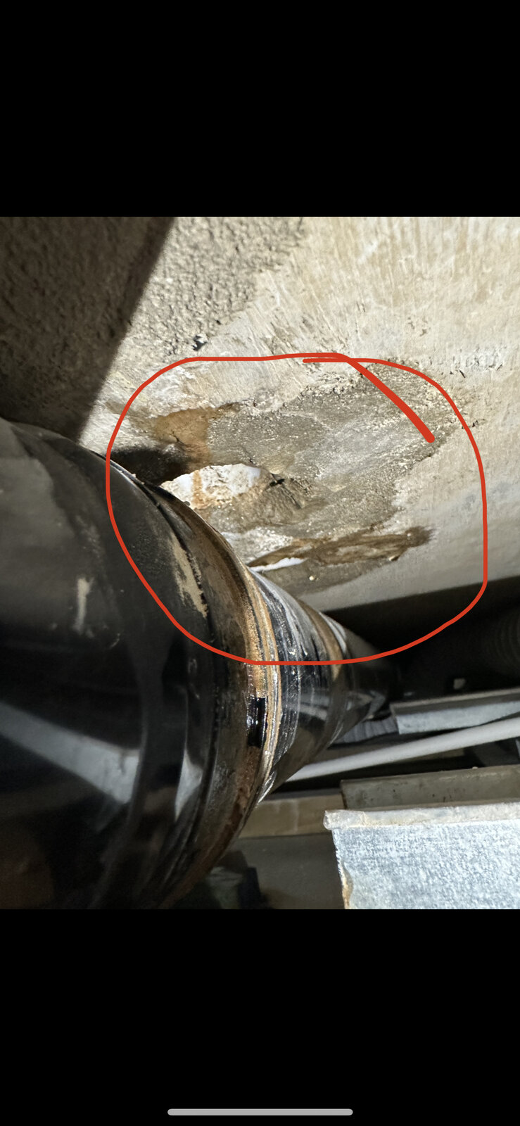

We turned off the water supply just before the new year (31.12.2022) - we were hoping that the leakage would stop completely after no water is circling around the house. The leakage calmed down. On 01/01/2022 we came back home at 9pm and we have noticed a much worse water leakage from the same spots. To add, on both occasions there was a rainfall present. Right now, we woke up to a good weather with no rain and the leakage is much slower than it was yesterday. We have an internal drainage system and the roof is a hipped sedum roof with a small skylight at the top. I'm inserting some images of the ceiling in the basement level. I'm a bit
baffled as to why there seem to be two holes up the concrete - the insert seems to be white PVC pipe of some sort. We're desperately trying to find the answer - is it the plumbing issue or the roof is letting water in. The fourth image shows the small study room, above our bathroom. The last image shows the initial area of our concern when we moved in. There are some white sticky sheets covering the floor, suggesting the builder tried to cover it up.
I would really appreciate any form of input.

Have you reported this to the builders? They have to be your first port of call unless you want to pay all the repair costs yourself.
Your pics are a bit too close, difficult to determine the context but the internal drainage arrangements for the roof have to be suspect, the heating system is also on the list (there will be a goodly volume of water in there even if the supply is off)

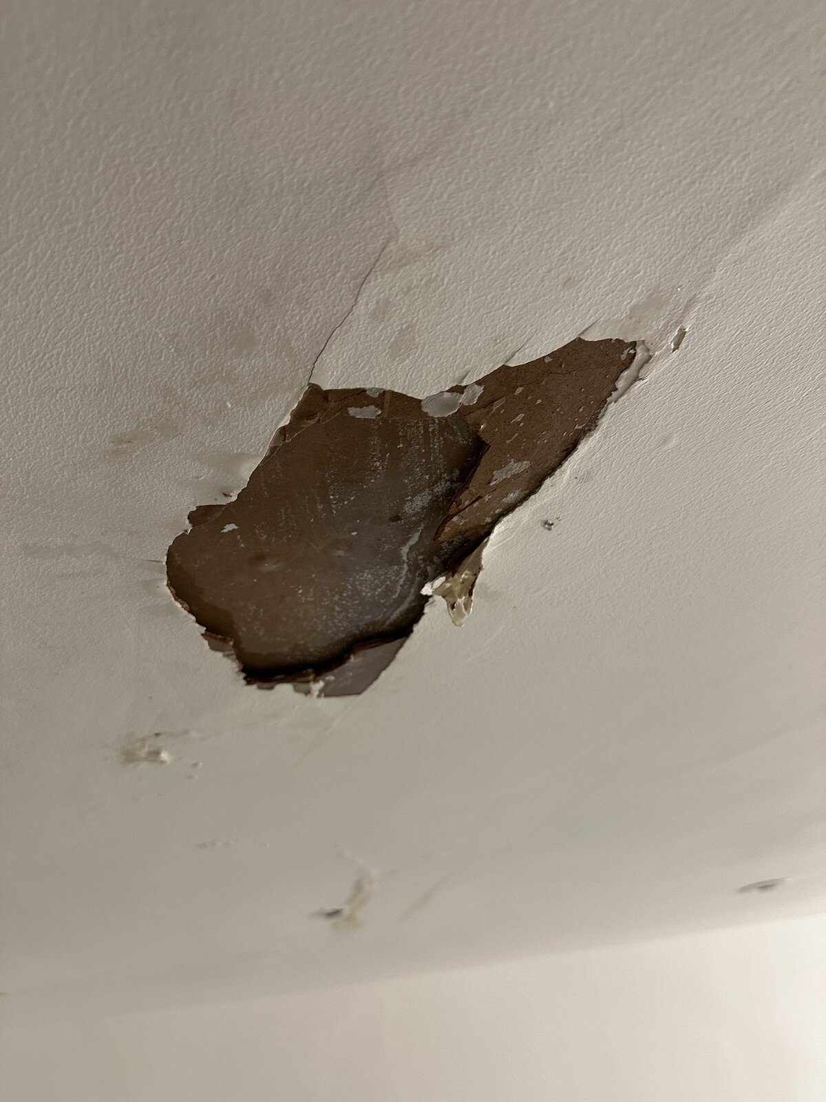

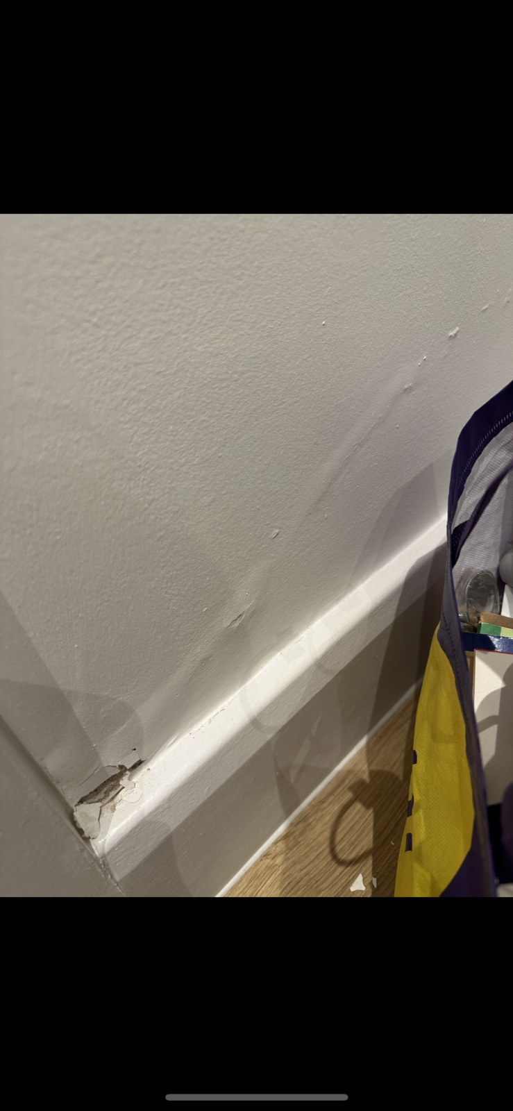

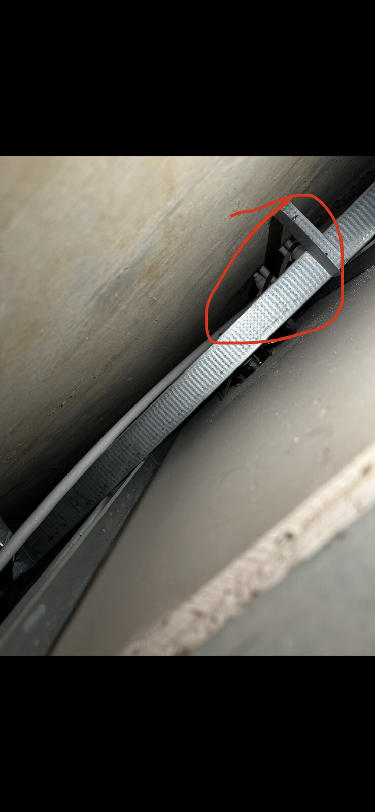

Tomorrow, I will start a claim with the building insurance and get someone in for another trace and access. For some reason, I still cannot rule out the possibility of the leakage from the underfloor heating, but everyone keeps on telling us the pressure is okay, otherwise it would drop down to zero and we had the living room area tested with a thermal camera - perhaps the water travelled from other part of the floor. The ceiling in the living room is soaking in water. I peeled off the paint so easily and the water was coming from underneath. The original leakage in the bathroom ceiling is alright, less drops of water. In other parts of the ceiling the paint has peeled off, however it doesn't seem to be soaked in water.
I'm still unsure about why would we have holes in the concrete floor - the inside of each hole looks like it's a pvc pipe. The ones on the attached photo is leaking the water. Some of the other ones are completely dry.
