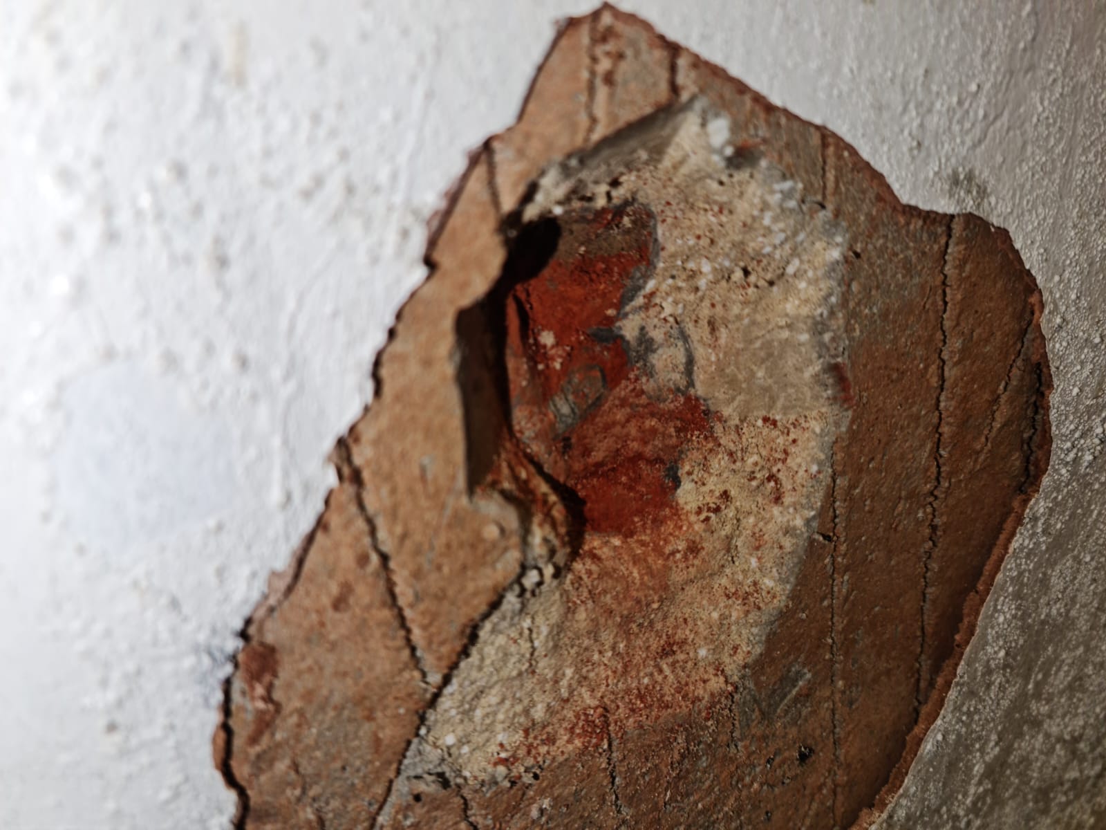

1. I knocked off some plaster on one of the damp internal walls and found the brick also damp:

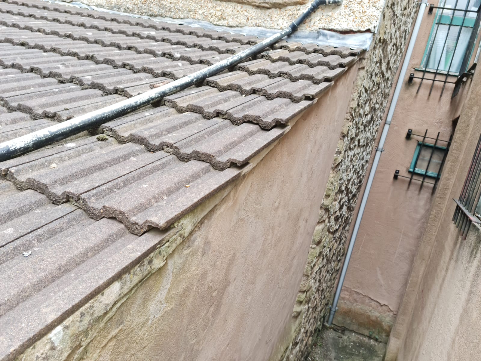

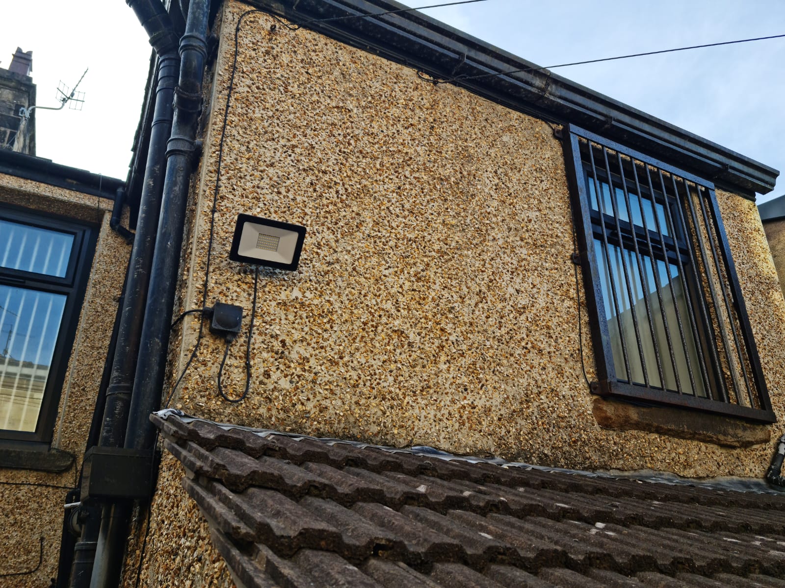

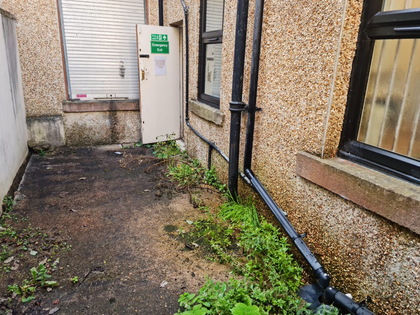

2. I took some photos showing more of the outside of the building:
View attachment 357643View attachment 357642

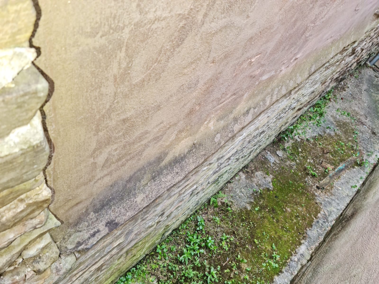

The internal wall of this side of the building is where the damp goes up around 2+ meters:
The roofing felt was overhanging, but I could not tell if it would be catching water that could then be getting inside

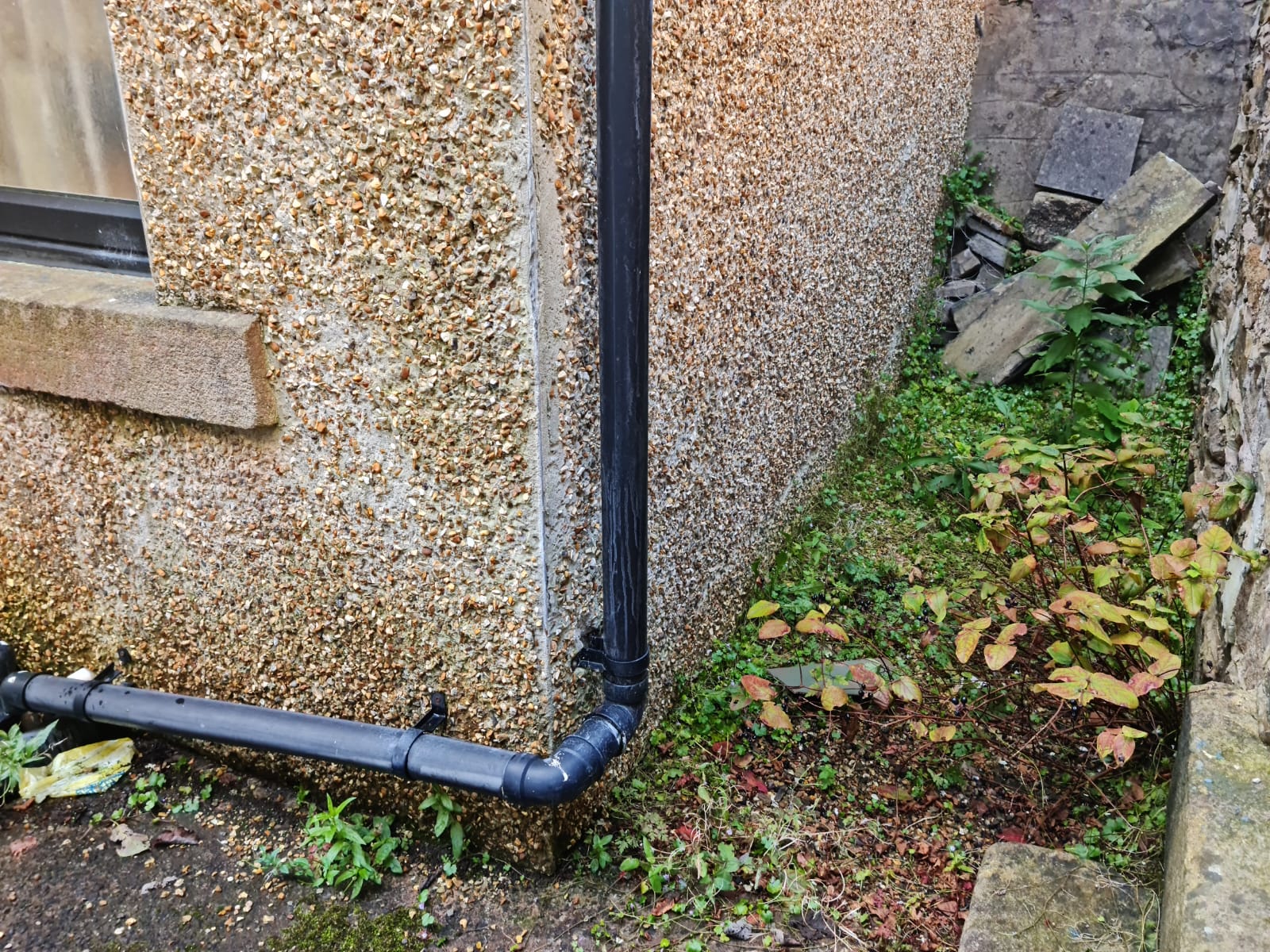

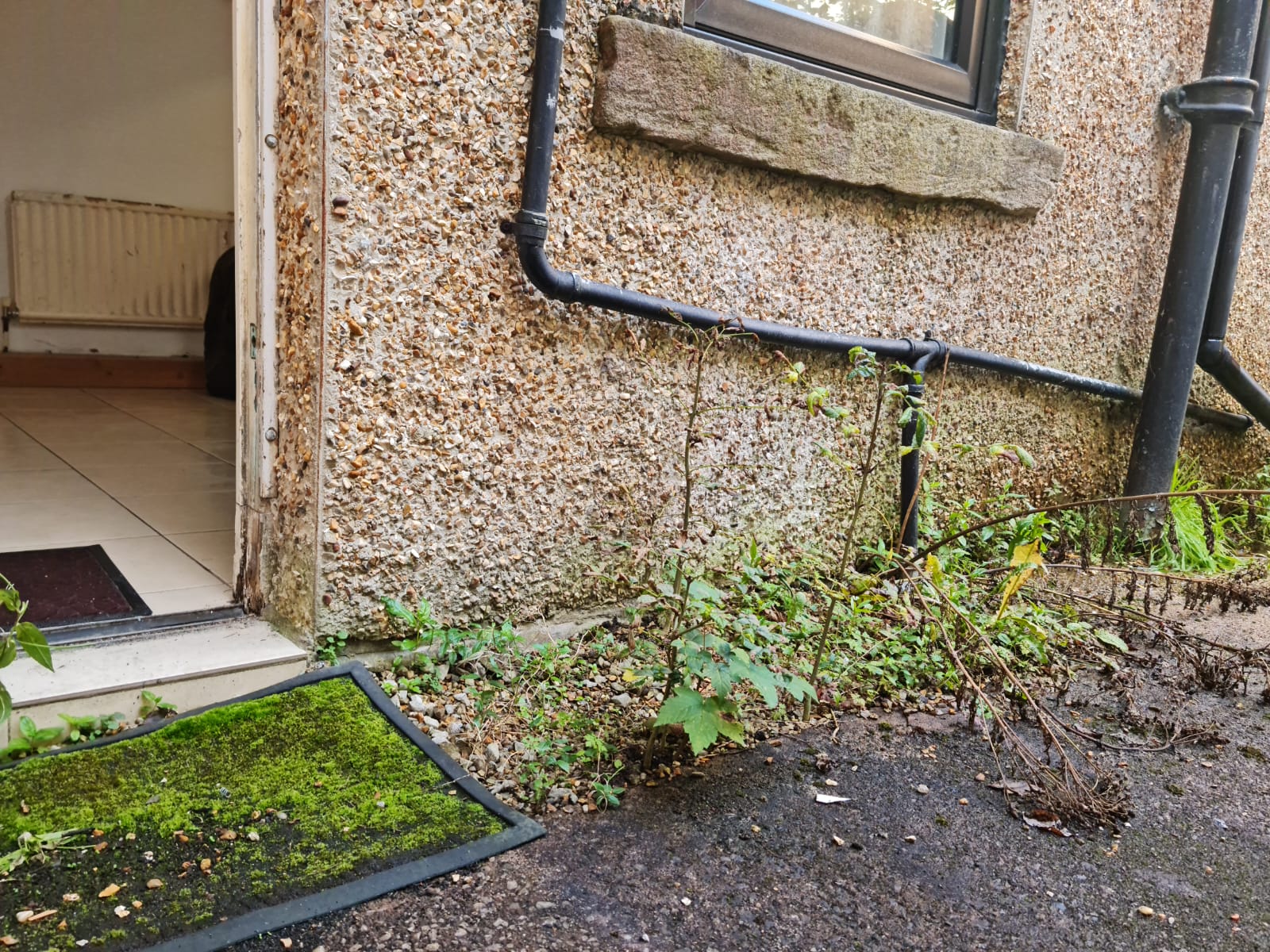

3. I was thinking the damp could be being casued by the pebble dash breaching the DPM, but then I noticed that on one side of the exstention building it does not have pebble dash, yet that wall is still damp on the inside.
The wall without peble dash:

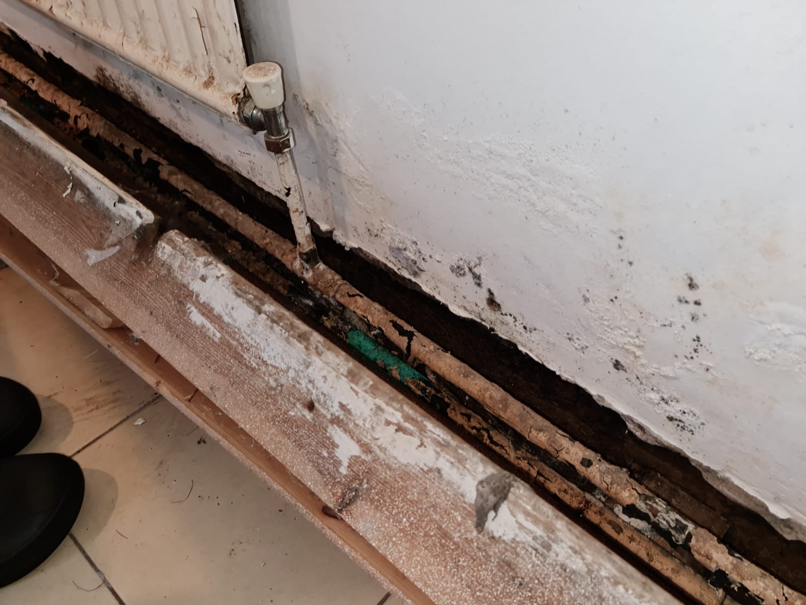

then on the inside of the wall above it looks like this:
-In the photo above I removed the radiator pipes boxing. I checked for leaks on the pipes but they seemed ok. Yet the wall is very damp, even though the outside of this wall has no pebble dash on it. As mentioned previously, the wall connecting the main building to the extension also has some damp at the bottom of the wall.
It's damp because it's a low end poorly built, zero cavity, zero insulation structure.
It need several thousand quid spending on it, to bring it up to snuff. Just about every façade or elevation need work doing to it.

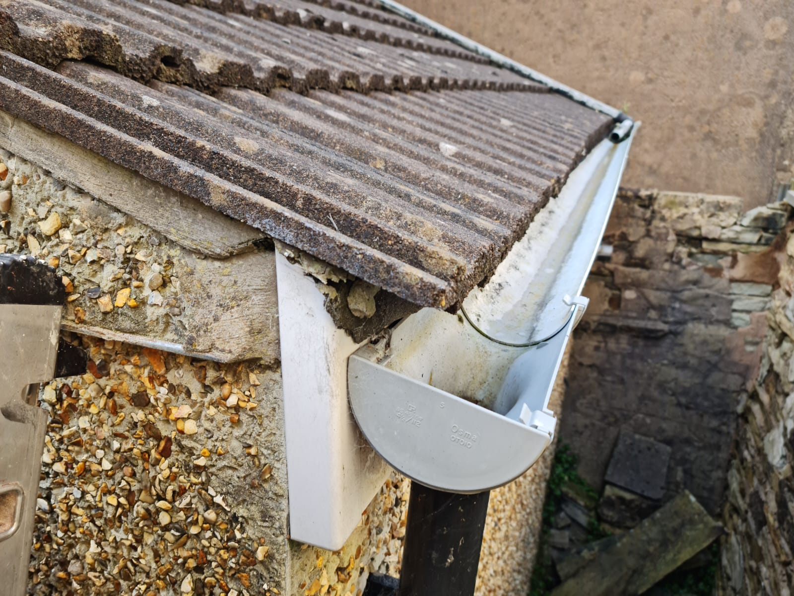

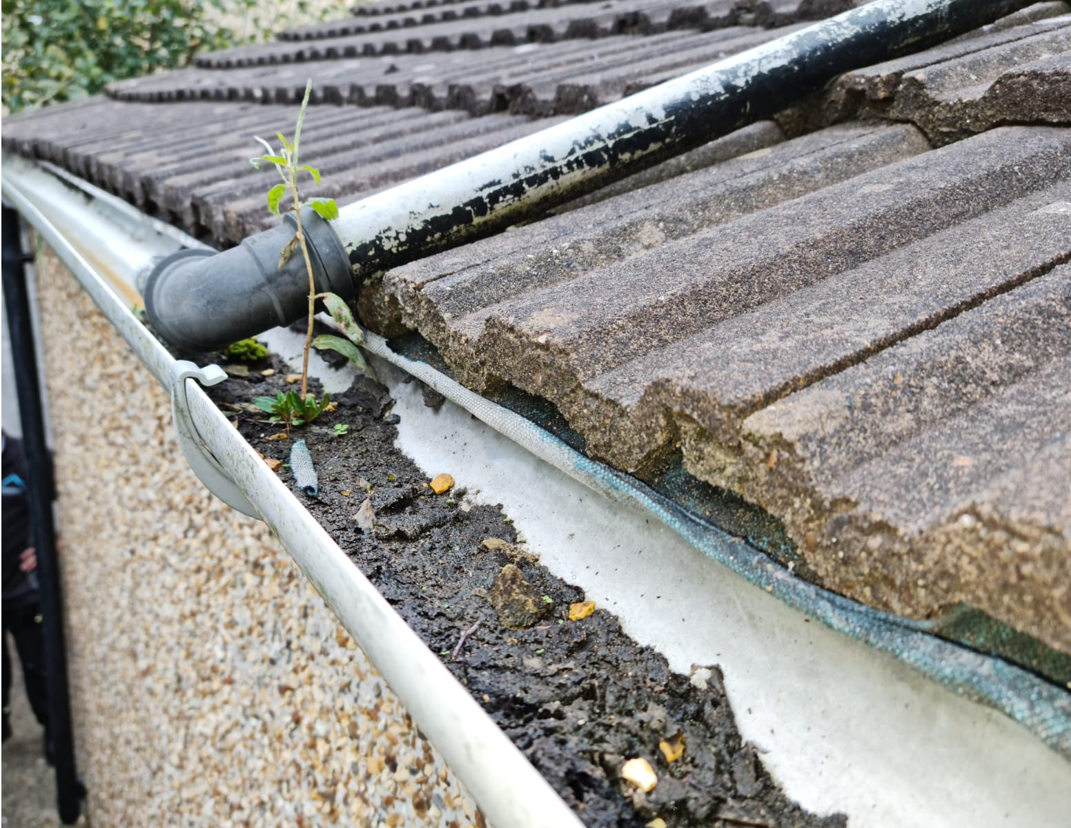

Do those roof tiles have enough overlap? If water was driven up underneath.....
There seems to be felt, but it's not clear what happens at the verges

You could start by clearing all around the outside, maybe removing a foot width of the hard standing and forming a French drain with a perforated pipe discharging into the gully.
Inside I can’t you have any choice but to strip off the plaster, isolate the damp and plasterboard over.
You could just put say 50mm of celetex against the wall, tape all joints, then 50 x25 battens flat then foil back plasterboard.
If you don’t to insulate then there are isolating membranes that can be fitted before re plastering.
I suppose you could fit wall rock dampstop wallpaper over the plasterwork, it’s a bodge but your only other option is stripping the plaster off the wall

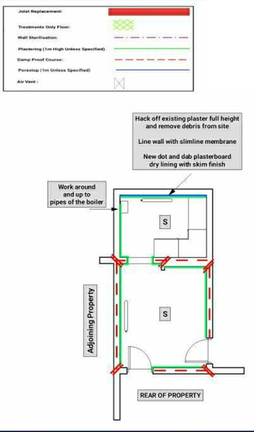

He messaged me today and said he got a company to do a damp survey last year. He showed me the proposal today. The bassically said they thing he needs a chemical DPC and some other things to solve the problem. I'm not sure if they are scamming him or not, though, as I have always heard bad things about companies ripping customers off with fake claims that chemical injections are needed.. I'll copy some of their proposal below.
The customer is a good guy, very honest, and doesn't deserve to be ripped off (not that bad customers deserve being ripped off, but still worse when it's a good guy having it done to him)
The propsal >>

Install a chemical damp proof course incorporating our [redacted] DryWall Diffusion Process to those walls indicated on the sketch, in accordance with the explanatory leaflet attached. Our quotation for this work is enclosed.
Our damp proof course can be installed (subject to access) in solid walls from one side only of the wall to be treated, causing the minimum of disturbance. Non-flammable and non-toxic fluid is used in the installation. There is therefore no fire risk, the property can remain occupied with a minimum of inconvenience to the occupants and will have no ill effects on you or occupants of the adjacent property.

It is usually recommended that all the walls to be treated are re-plastered to an even height as indicated on the sketch, strictly in accordance with our specification for ‘DryWall Coating’ but as the walls have been dry lined full height we will have to change our specification in places so that our new plaster matches the existing but can still prevent any salt contamination into the finished wall surface.
Our quotation covering re-plastering allows for the following:-
[redacted] are to:-
Hack-off and remove existing plaster from the areas and heights indicated on the attached sketch, and clear resultant debris from site.
Re-plaster these areas in accordance with our specification for ‘DryWall Coating’.

Form a Vapour Barrier Up-stand ‘Raglet Joint’ to treatment wall / floor joints as follows: -
Prepare the surface by removing any plaster remains and wooden plugs, pointing up any large holes or voids from below the line of the DPC.
Where the original plaster extends below the floor slab, this will be raked out, cleaned and the void filled to floor level. A vapour proof slurry coating will then be applied to the wall-floor intersection up to the DPC installation level. This jointing technique will considerably reduce moisture vapour condensing on both the underside of plasterwork and the rear surfaces of skirting boards, extending their life span.
Rear Wall only -
Supply and fix a slimline mesh covered membrane to the exposed wall/brickwork using sealed plastic plugs and waterproof tape to the joints
Dot and dab fix new moisture resistant plaster boards to the same treatment areas and skim finish
Refit skirting boards and pipe boxings
After re-plastering, hairline cracking of the setting coat may occur. This will not present a problem regarding the efficiency of the new plaster and should be made good when decorating.
Note - The waterproof membrane will prevent any salts or dampness from permeating to the surface of the finished plaster during the drying out period

Why do they need to install a water repellent to the skirting boards if their cure-it-all chemical dpc will solve the damp problem?

Roof, gutter, dpc, the ground level and debris?
The inside floor seems to be at the same level as the ground outside. Often this is because the outside ground level has been raised and the original damp proof course has been buried; the fix in that case is to restore the original outside ground level. But in this case apparently the structure is only 15 years old and it doesn't look as if the outside has been changed in that period - so what has happened? Was the extension built without a damp proof course? Perhaps the client insisted that there be no internal step into the extension. This all needs to be understood.
If there is no damp proof course, or if it is below ground level and so does nothing, then their proposal has some merit. Inserting a damp proof course at a suitable level relative to the ground outside, and then doing ...something?... so that the dampness below that level doesn't get into the bottom of the wall and floor, could work in theory. But in practice these chemical treatments are ... controversial, maybe?
All the previous comments remain valid (read them all again!). Knocking it down and rebuilding it properly should not be ruled out.
