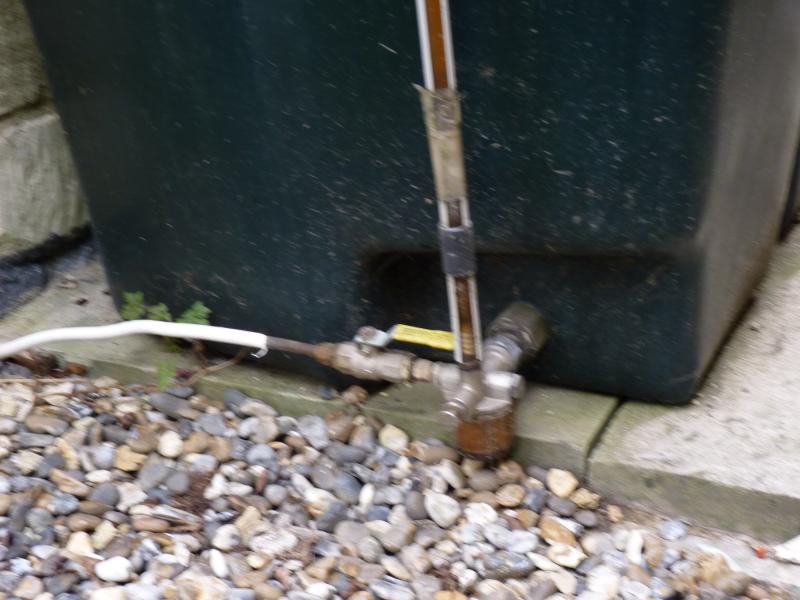

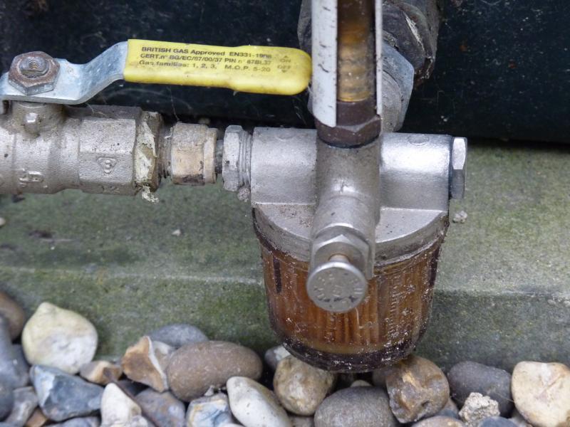

It seems like you have a fairly ideal installation tank wise there, so as long as the filters are clean etc there's nothing to worry about.
