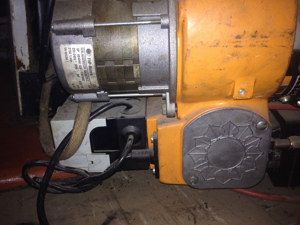

Hi, can u help please. Have a Worcester Danesmoor 15/19 OIl boiler and when switched on after a few seconds in trips the circuit breaker on the fuse board. Seems to happen when there is a click like a solenoid.
Disconnect the solenoid lead from the coil. If it does not trip, replace the solenoid. If it still trips, then isolate the components in the sequence they are energised until you find the culprit.

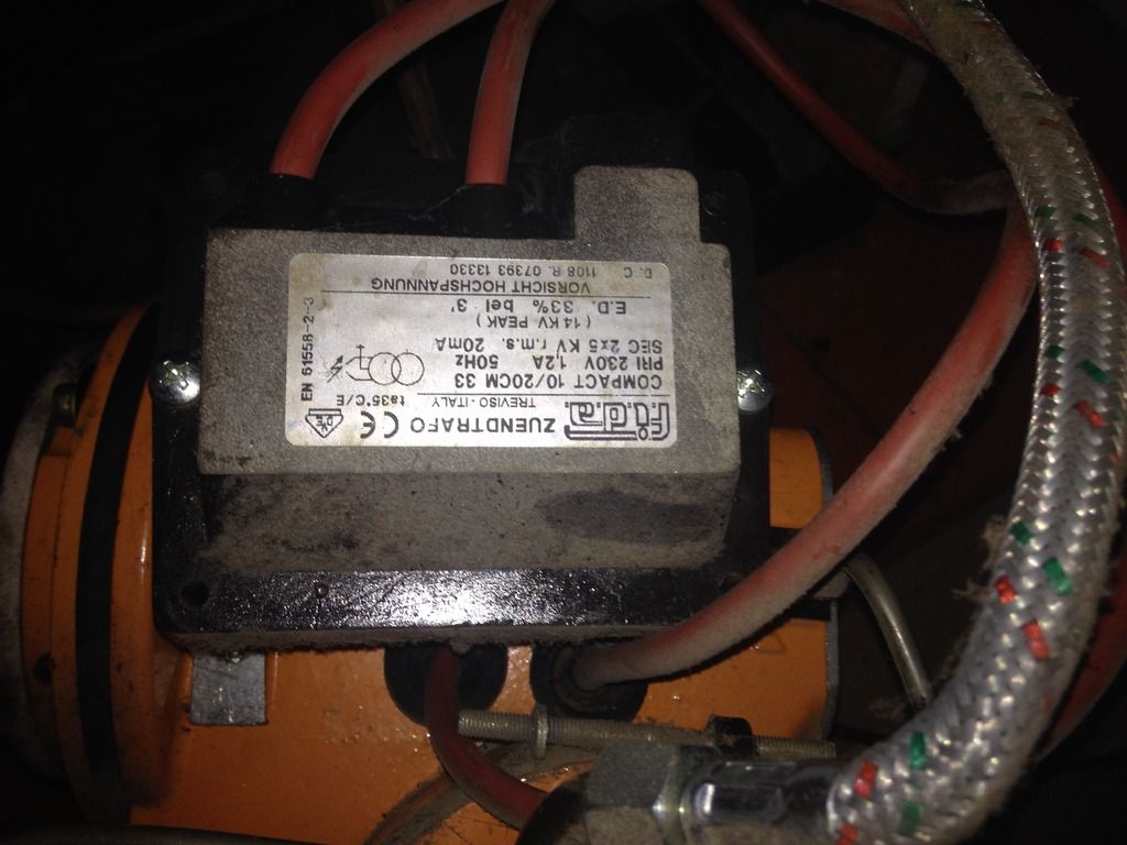

Thanks quick response, A few pics,
Which burner do I have?

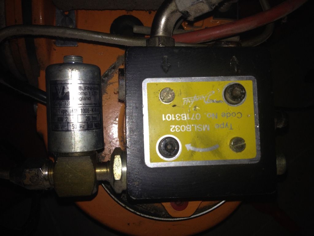

Is the solenoid the silver jobbie in the first pic.
Yes . You will need to remove the live feed to the components in the control box to isolate.

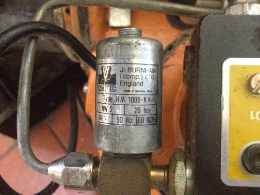

Ok disconnected and isolated the live wire from the silver solenoid in the first pic. The boiler does not trip the electric now but the lock out light comes on.
So this is the solenoid coil ?
I guess its likely that replacing that will cure the problem. Had a look online but cant find that model.

That would be my choice due to the pumps age.
It is not a straight swap though as the high pressure fuel pipe will need modifications.
The oil pressure and combustion will need checking.
Or try "Brahma 1809107"
The Brahma will be a better bet but you may need to adapt the pipework a little. If you change the pump complete, then the burner will need to be recommissioned.
Thanks for the help. Out of curiosity why is the Brahma better. Doesn't seem to be widely available in the UK.
Haven't measured the existing yet but looks like it has male 1/4 bsp on both sides. The brahma will be 1/4 BSP female I think so I may get away with two 1/4 bsp male to male adapters on each side.
rgds
My mistake, male to male
1809107 - E7B 1/4"M x 1/4"M 230v Oil Solenoid Valve c/w 600mm Lead
Only place I can see that in the UK is Anglo Nordic. Cant find a picture, hoping one of the male outlets is long like the existing.
V matic is no longer available. They were used extensively on Rayburn pressure jets and NuWay burners. There are also Delta valves that may be better suited. These are used on Rayburns, and are 1/4" BSP female both sides. A 1/4 nipple will fit on the pump side, but you would need to find a 1/4 bsp male to 1/4 flare on the burner side.
Guys thank you. Boiler is running again. Its a bit slow to get the rads hot but I guess its an old boiler, the pump was replaced last year.
Ended up with a Delta solenoid coil and some adapters. The BSP to flare adapter was nearly as much as the solenoid. I suppose in hindsight another way forward would be to change the pump to a Danfoss BFP21 including a new solenoid.
