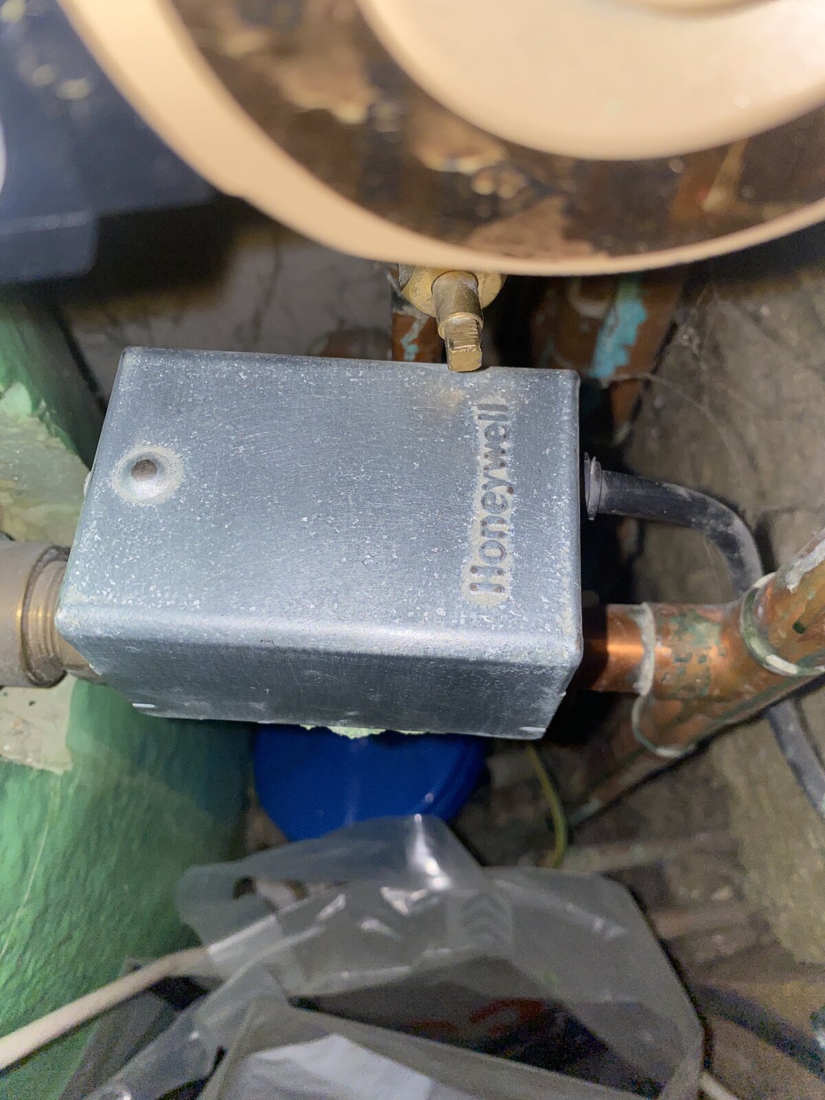

Hello hope someone can help. Have a Worcester danesmoor 15/19 boiler.
The problem is the boiler won’t switch off everything off and thermostat on 0 still heating up the radiators.
Can anyone help
Likely the valve works, but the micro switch inside is stuck, but changing the V3 micro switch is not really possible, so if head will come off, change head.
A light tap may free switch but only temporary it will need renewing.
Ok cheers mate.. thank you for help . Try and see if head comes off or call a plumber
took a picture
It is removable. BUT is there another one as that looks like the Hot water valve
Can’t see one , think it will remove but screw or nipple blocked by water tank
