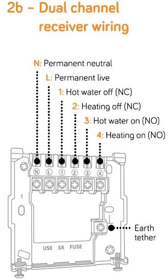

Hi. I’m wondering if someone can help me. I am trying to swap out a Danfoss TP9000 for a Hive (image below). I have done as follows;
Neutrals - Neutrals
Live - Live
3 - 3 (HW On)
4 - 4 (CH On)
5 (Removed at Timer and Sensor)
6 (Removed at Timer and Sensor)
Extra Neutrals? (Bottom right of image) I have put in with the other neutral with a link into seperate terminal.
Extra Earths? (Bottom right of image) I have put in with other earta with a link into seperate terminal.
When I finished putting everything into place and turn on the power it’s just blowing fuses and tripping at the fuse box.
Anyone any ideas what I’ve done wrong? Driving me mad and I can’t seem to understand what the extra “neutrals” and “earths” are even there for in the first place.
Any help hugely appreciated!

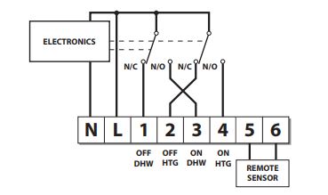

The TP9000 is wired as below:
It's just a matter of moving the wires from the TP9000 backplate to the Hive dual channel receiver backplate terminals that have the same function. Which in the case of N, L, 1, 2 ,3, 4 are exactly the same, as you can see from below, just swap them over like for like.
Don't worry that not all terminals will have a wire in, you will only need the existing wires you already have.
The remote sensor in TP terminals 5 & 6 is disconnected and removed. The Hive thermostat replaces it and communicates with the Hive receiver wirelessly.
The wires in the two terminals on the bottom right don't have a function as far as the TP is concerned, they are just terminals and should remain connected exactly as they are, so you will require two new separate terminal connectors. One for the yellow and brown wires in the top terminal, and the other for the yellow and blue in the bottom terminal
As has been said when it comes to heating systems the wire colours are meaningless much of the time and depend on the choices of whoever installed it. The blue wire in (4) is actually being used as a live wire and so really should have a brown sleeve over it to identify it as such. Something like this:
You have obviously created a short circuit somewhere, hopefully it won't have damaged the Hive receiver, but it could have done.
