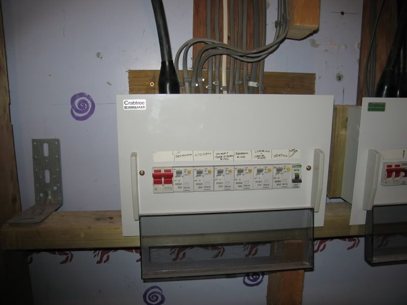

I am stacking my warehouse with MEM pods.
That's a bit risky John, what if people want a quality product? :lol:
...and before the whole world and his wife starts posting...it's ongoing in my house :lol:
I think I've sold all the Crab ones.
And yours are too fat.
LOL...a bit like me then.
