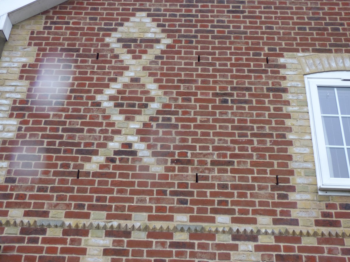

As promised, some photo's.
First is one of the gable end and you can see the gaps are in a straight line vertically. There are 3 slots on each horizontal line, (all in the same course line), and this is repeated on the right of the window. The lowest slots are about 5'-6" from ground level and the highest are just below the roof line out of shot.

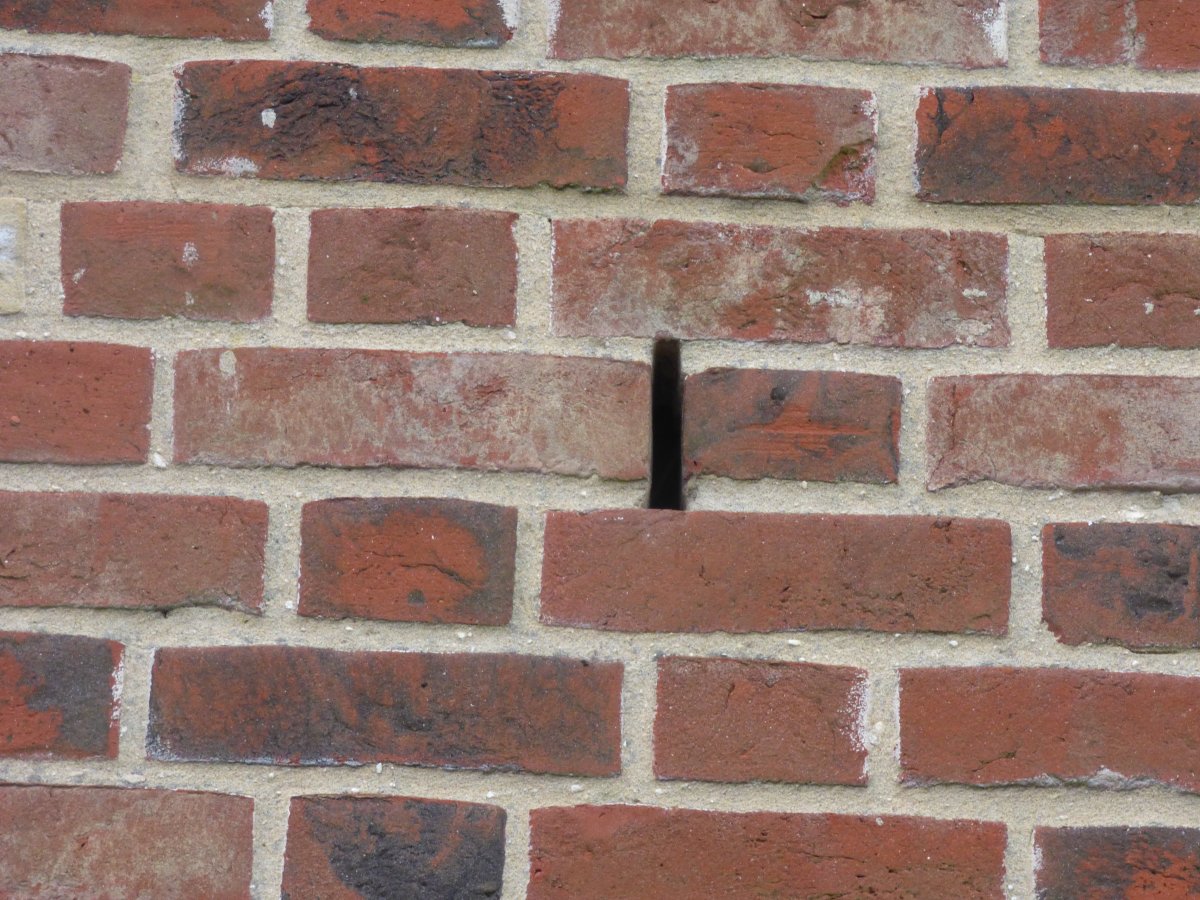

Second pic is of a single slot.
I've just noticed that the brickwork appears to have stretchers in each course and looking down the slot, with the aid of a torch, there seems to be about 1/2" gap to the internal brickwork.
House was built in 1876 and extended a few years ago to closely match the original brickwork, (hence the patterned brickwork). These slots are only in the front and side of the extended part, not the original structure. Rear of house faces east, side faces south and front faces west, if that is of any significance.
