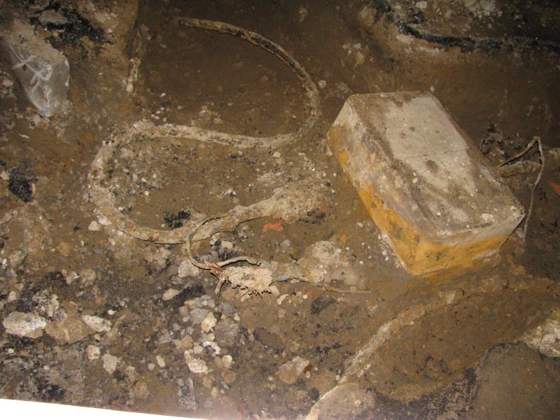

changing the subject, I've seen at least 5 vans (at the same time) from various different Organisations at this location, (I walked to a near street at 6:30 PM today, and took this...) "attending" to various services, a big sign stating "Do not disrupt, Engineers working on live cables" or something to that extent, it can be seen at:
http://www.browse.to.it/cable.jpg
and is a severed feed, the pic doesn't really do it justice... but its 2" in dia
any thoughts? for sure this ain't live.... (well now is isn't) and the state of the bonding is in question (but this may well have been caused by the excavations)
