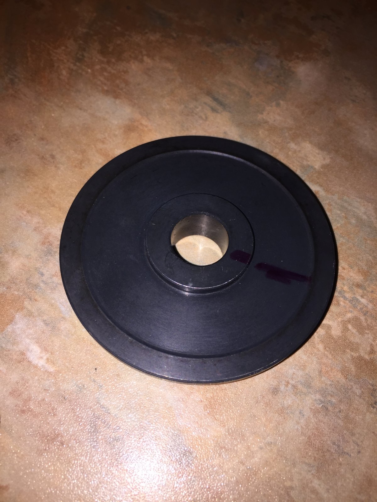

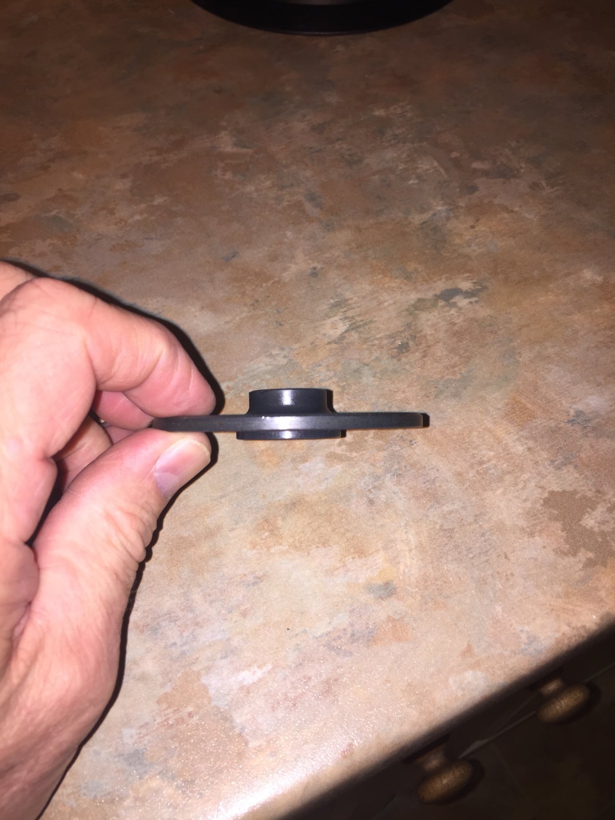

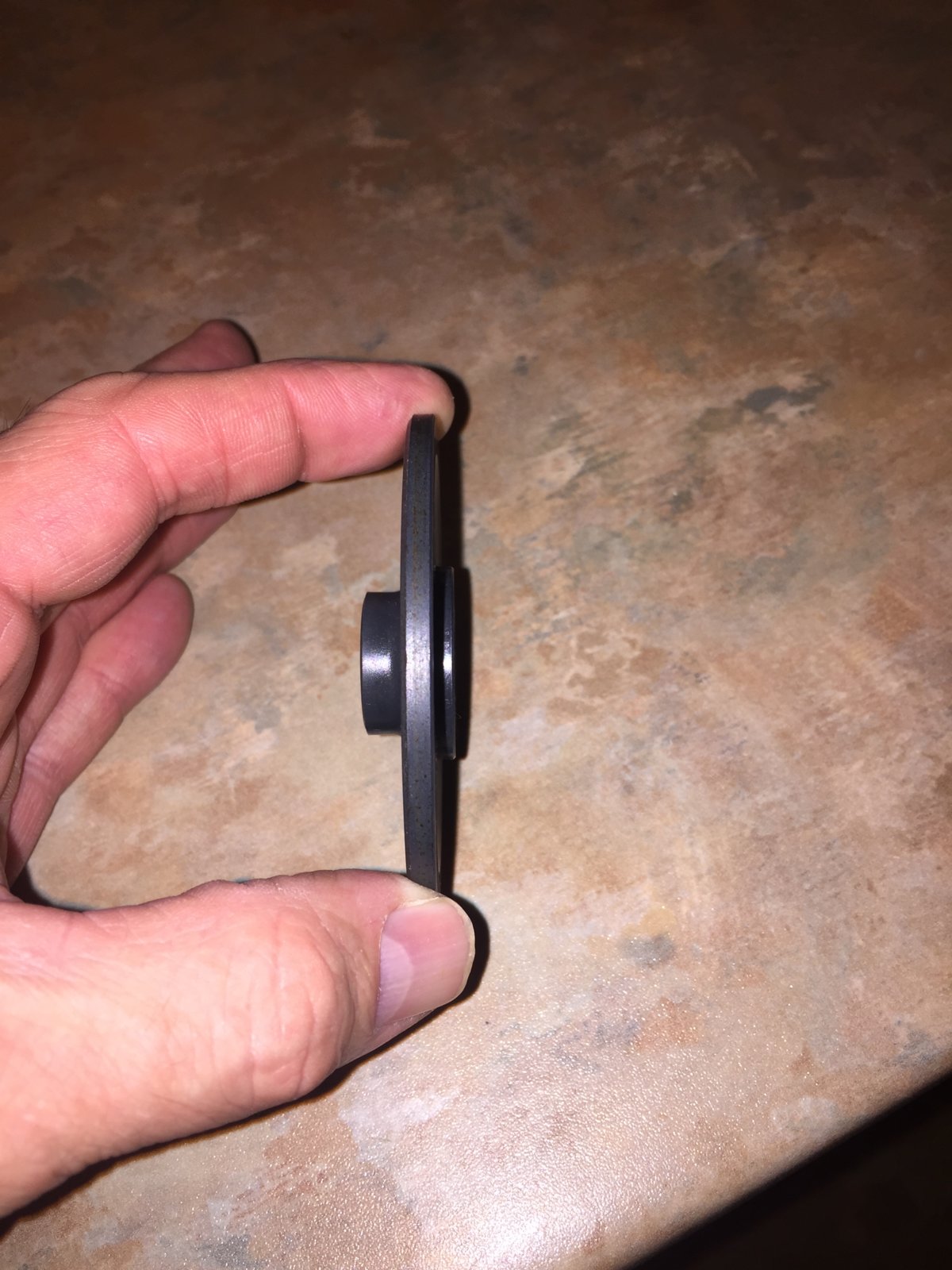

Thanks for looking Eddie. Unfortunately it’s the inner flange I’m looking for. That’s was is so frustrating. Other parts are available.
Thanks footprints for your thoughts. I suppose it could be shimmed, but certainly outside my skill set.
This is the flange required.
I can’t see any distortion!

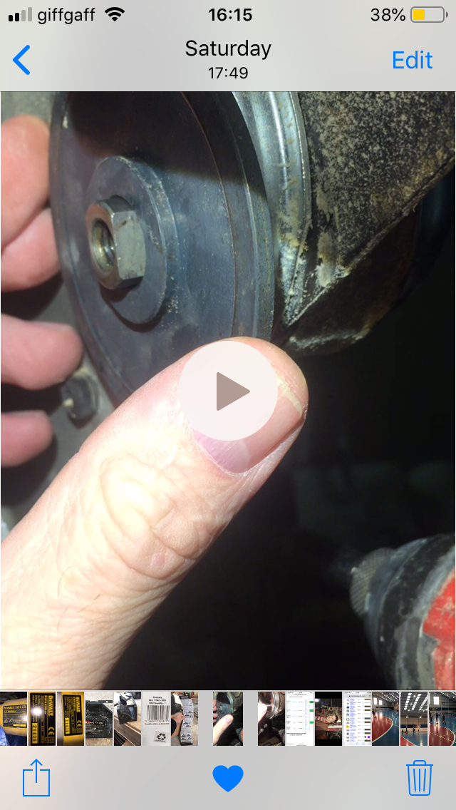

I used the following utube clip to diagnose.
I’m not sure whether my blade spun, but I came to the same problem source without as much visible damage to the ‘flange’ as we call it in the UK.

Part of the problem is that your saw is well over 8 years old, having appeared as an Elu saw back in the late 1980s and then been replaced by the DW718 maybe around 2005 or so (possibly earlier, but I recall using a DW718 around 2006 on a job). That model has in turn been replaced by the DWS780 (several years ago), so your saw is, well, pretty old. Maybe try the flange from one of the later models, or get an engineering shop to turn you up a replacement?
Yours does not look damaged like his although we don't see the underside If you had one like his with the shoulder off it might grind smooth flat on a sheet of coarse wet and dry then a thin shim washer but I think as joband knock says it might be worth trying a later one otherwise time to treat yourself.;)(y)
