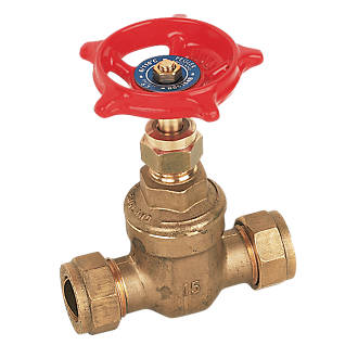

I remember buying some "full bore" lever valves online, but when compared to the Altecnic's I bought from a local plumbing shop, you could clearly see they weren't quite full bore. So not all full bore's are equal either.
I prefer to use gate valves on everything.
So, like that pictured below?
Are these considered to be more secure to use as an isolator valve rather than the more common ballofix variety?
http://www.screwfix.com/p/gate-valve-15mm/85316
http://www.screwfix.com/p/pegler-gate-valve-15mm/12308
