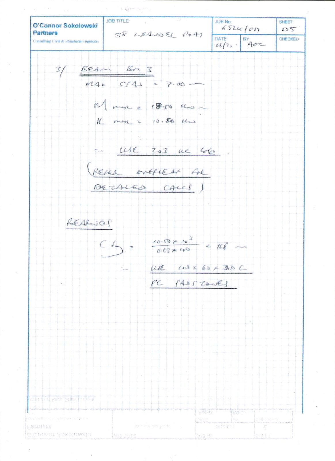

It depends on the load the beam is putting onto the padstone, and also the bearing capacity of your brickwork. Your SE should advise on the size of padstone; if he hasn't told you the size required, he's not done his job.

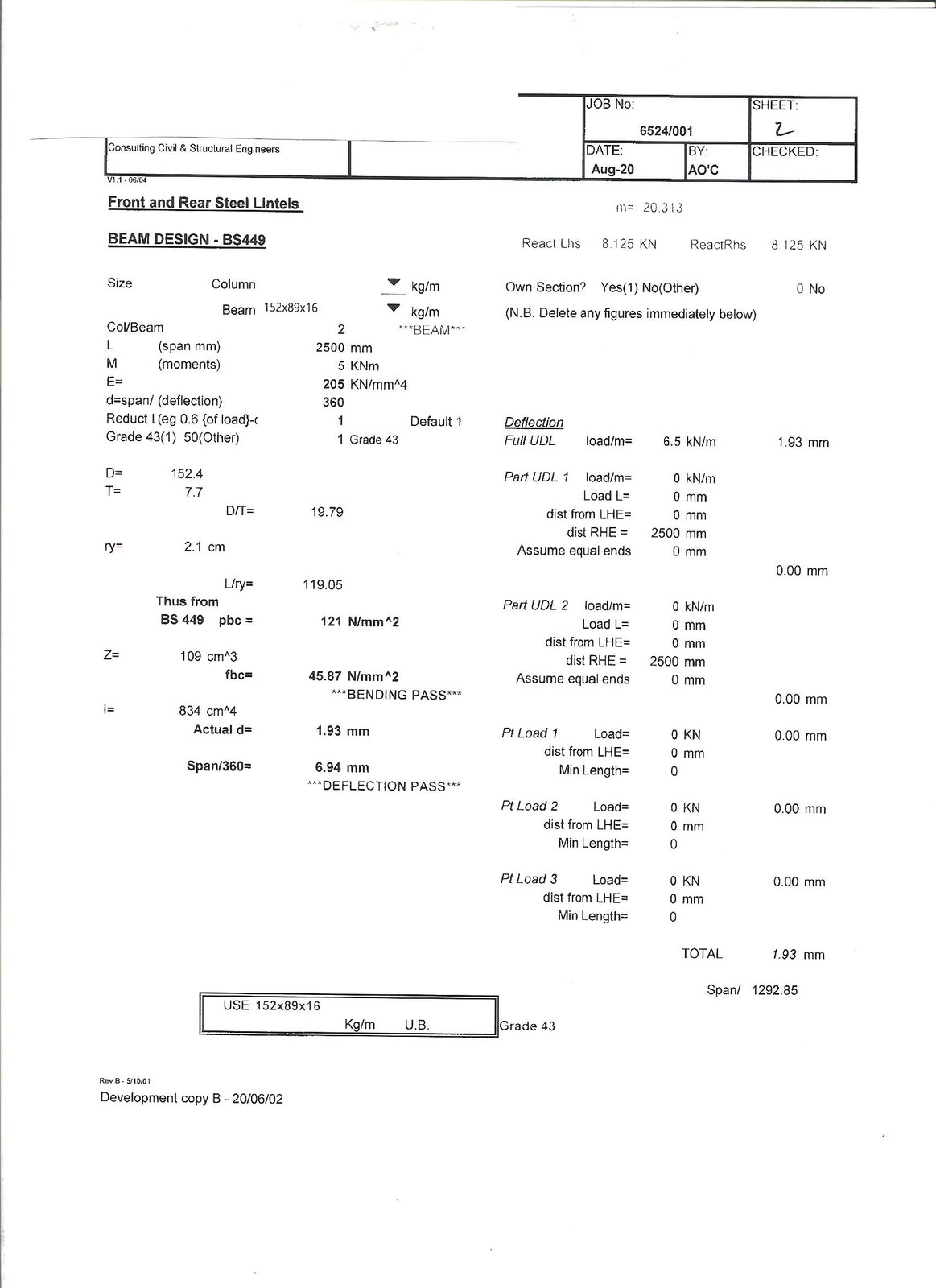

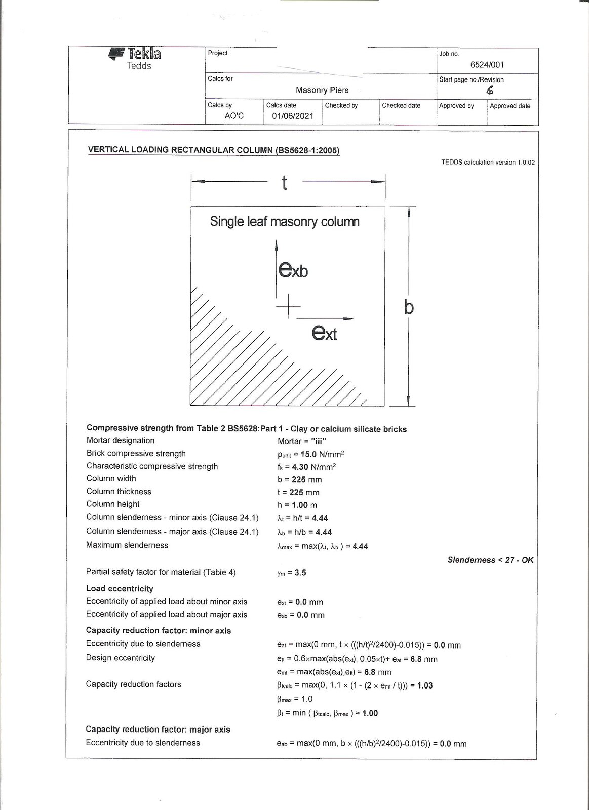

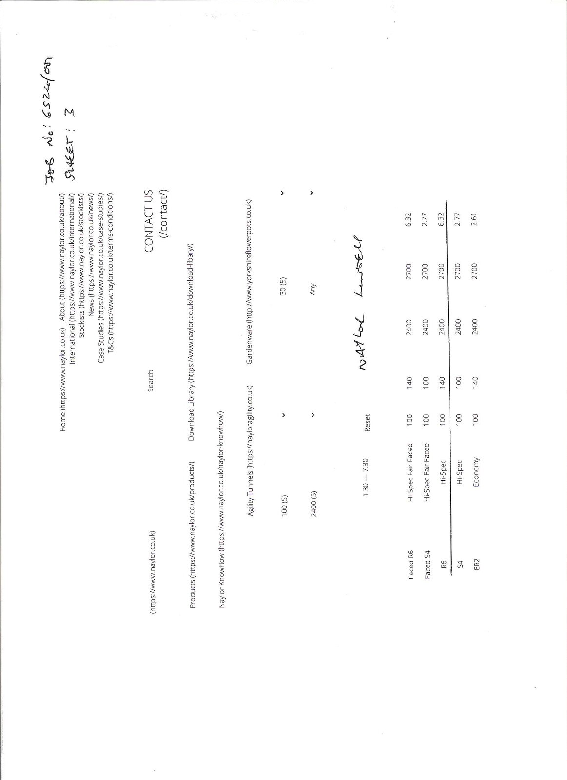

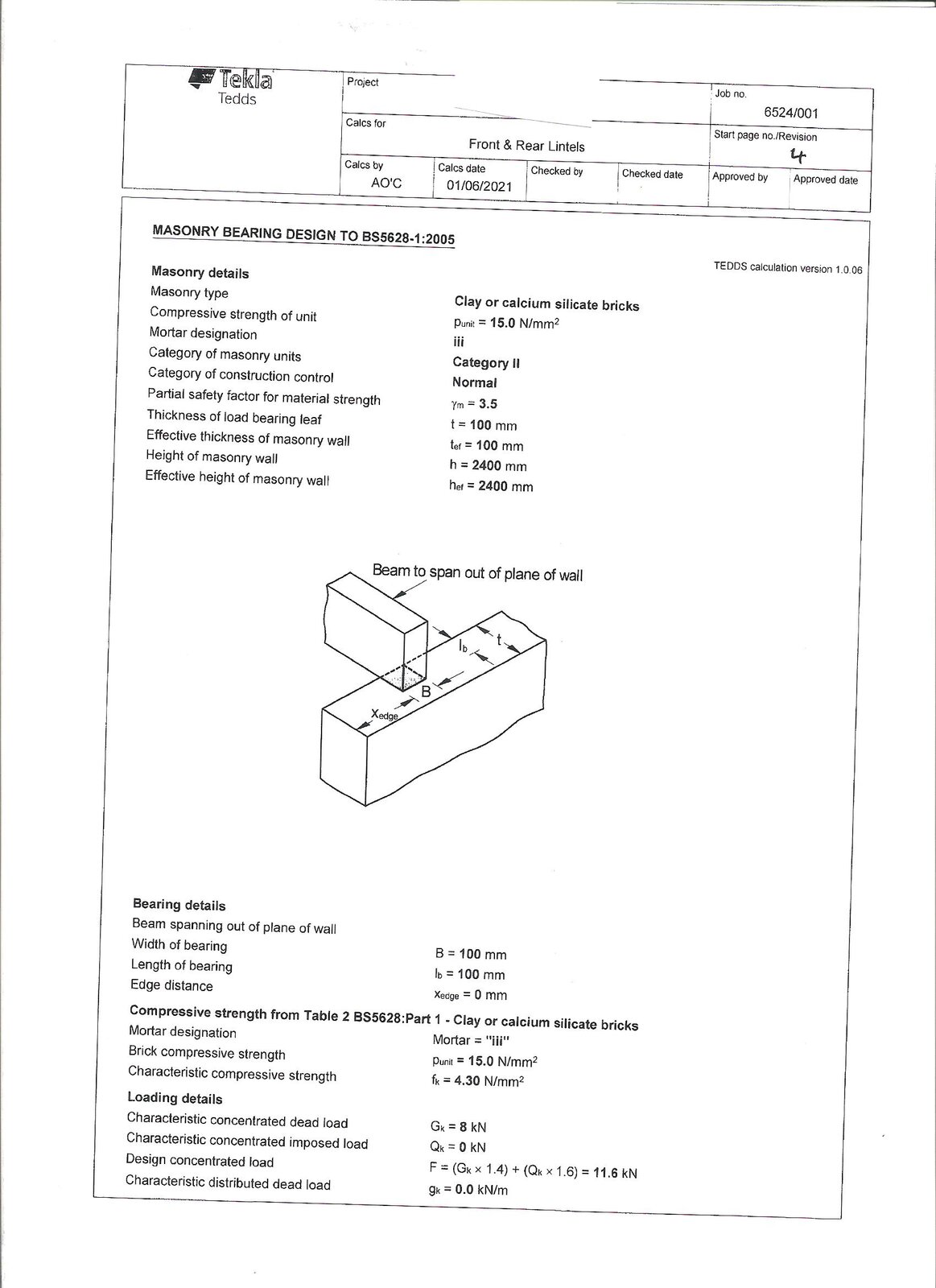

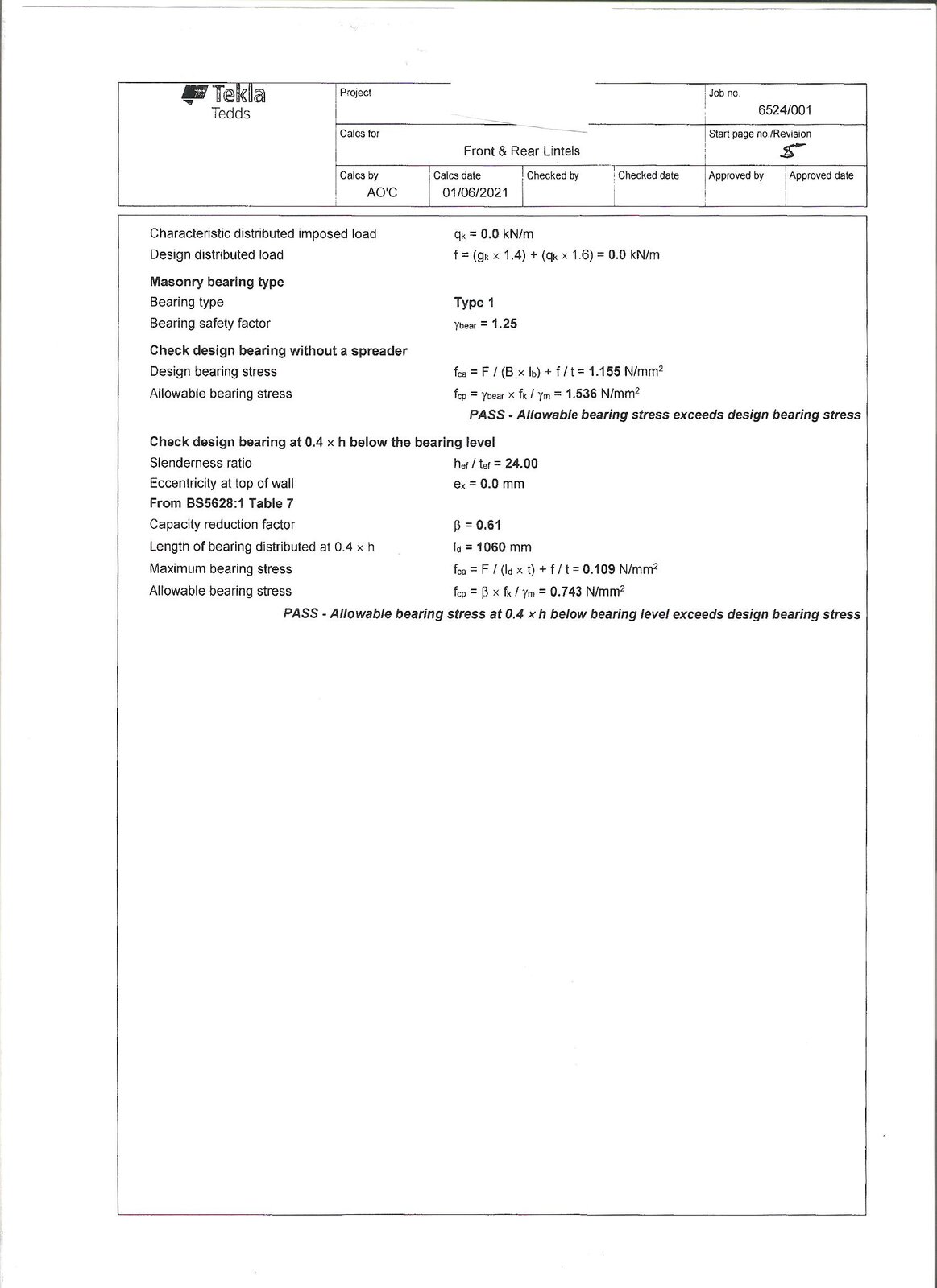

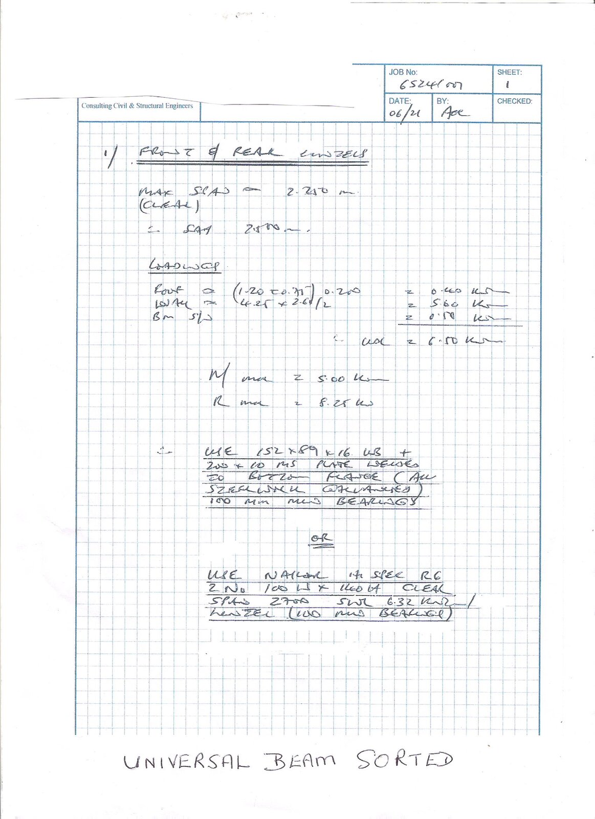

Did your "surveyor" mean something like this? Ask at Jewsons if any in stock
Thank you.
I guess someone will know more about this attachment than I do.
Please have a look.

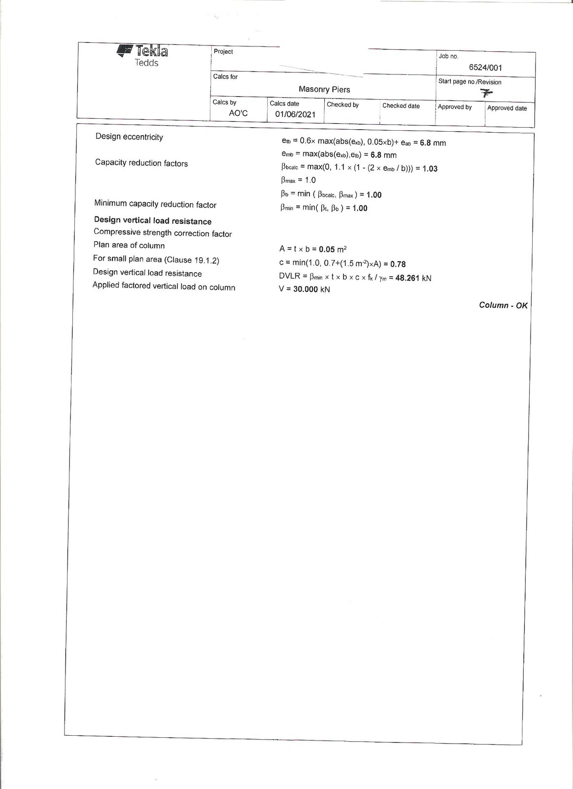

Its about time your Structural Engineer learnt to use up to date design codes. BS449 was replaced by BS 5950 and then years later by BS EN 1993.
The masonry design code is also out of date but still used by some older engineers.
Yes, 449 and 5950 are superceded, but I've still seen a few figures done under 449. It's still accepted by many LABC checking engineers for smaller domestic work; the advantage is that its quicker but it is also conservative, and smaller sections can be obtained by using the later Codes.
I stick with 5950 and have never had any queries raised. EC 3 potentially gives even lighter sections, but I rarely use that, not being into pain.
I never hired a such surveyors before for this type of work but I began to feel he could be more involved, and what you have quoted here confirms my thinking. I am fed up with him that is why I put my queries here.

That bloke has specified a concrete lintel as an alternative. Use those and you don't need padstones.
Alternatively, as the steel beam is so small, use 2 solid blue bricks instead of a padstones.
For a 2500 span you could probably set it on two of my mum's jam tarts and it would be ok.
So what's the characteristic compressive strength of your Mum's jam tarts (in N/mm²)?
I have a 3.2m span, single storey, on a 100x150x250mm padstone which is barely more than a brick. As above I think anything will do really.
