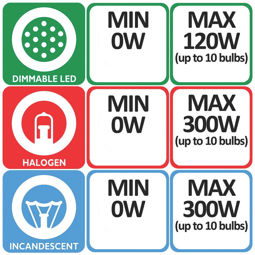

    I'm after some advice please. We've just fitted 8 Enlite E5s on our landing, controllerd by 2 way switching. To be honest, they are too bright so I'm looking to fit a dimmer in place of the downstairs rocker but I'm a bit lost as to what I need. I imagined (hoped) I could just buy a trailing edge ready made rotary switch to fit on place of the rocker but now I'm not so sure. Can anyone offer any advice on what indeed here please? Thank you.

    Not used one but that screwfix dimmer seems well rated by people dimming Dimmable Led, though to me the description is a bit vaque it does claim to dim Led including 8 x 5w = 40watt, which is about what you have.

    I'm using one to dim 5x Enlite E5's and a 6w LED retrofit bulb - 28.5w in total
    8 is probably a bit excessive, but I fitted 5 in a relatively small room but use a dimmer - with a single pendant light it was dark with lots of shadows. With multiple light sources I can have much more even lighting.
