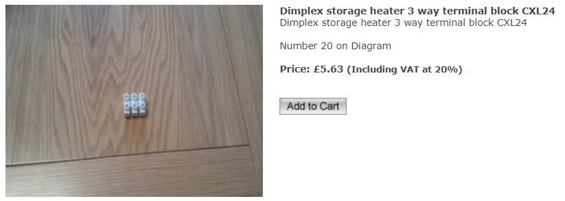

Somewhat excessive - plus postage? :)
99p for 12 at Toolstation.
Just out of interest, the price is £4.69166r without the vat.
I wonder how they arrived at that figure.
