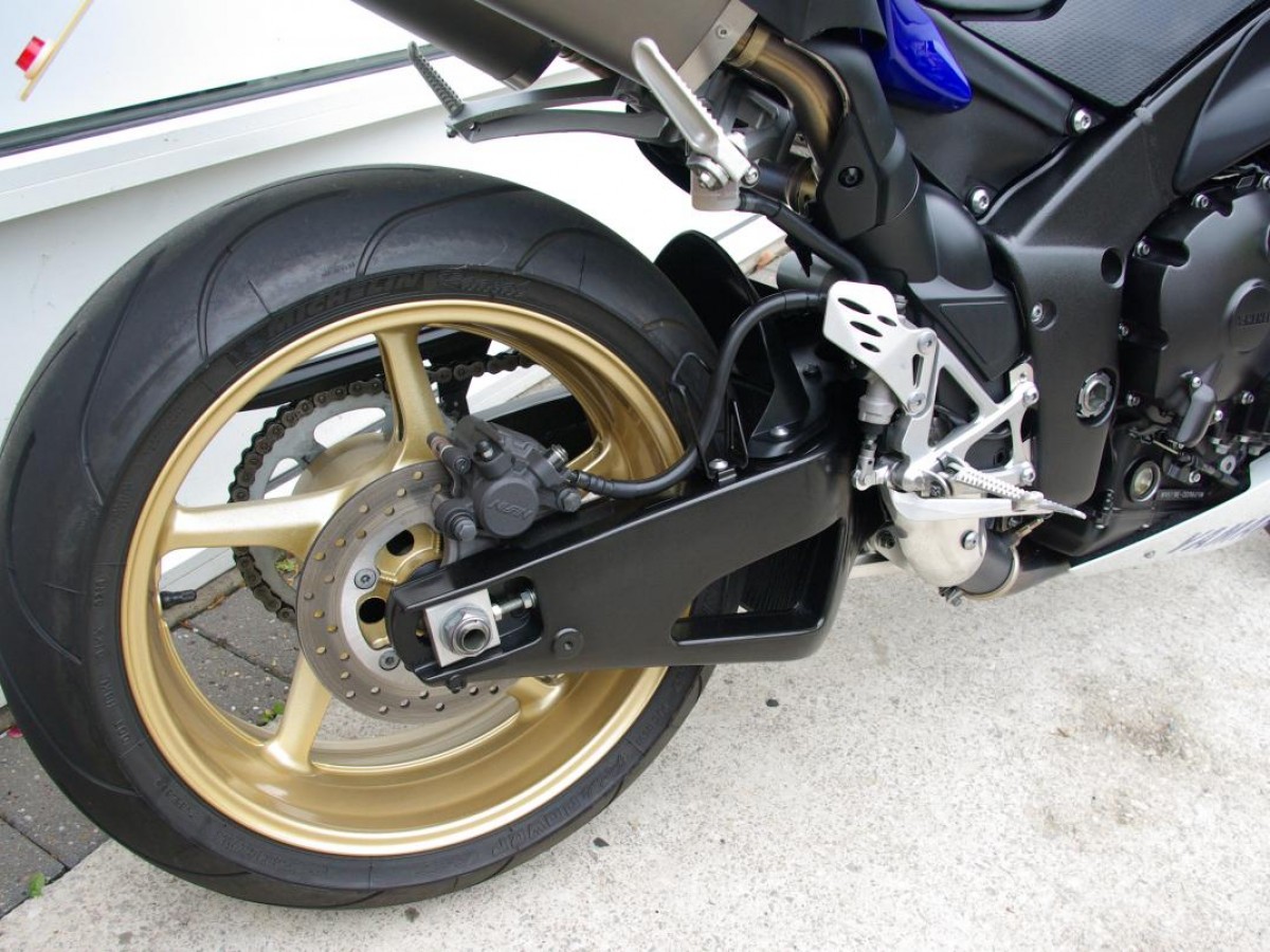

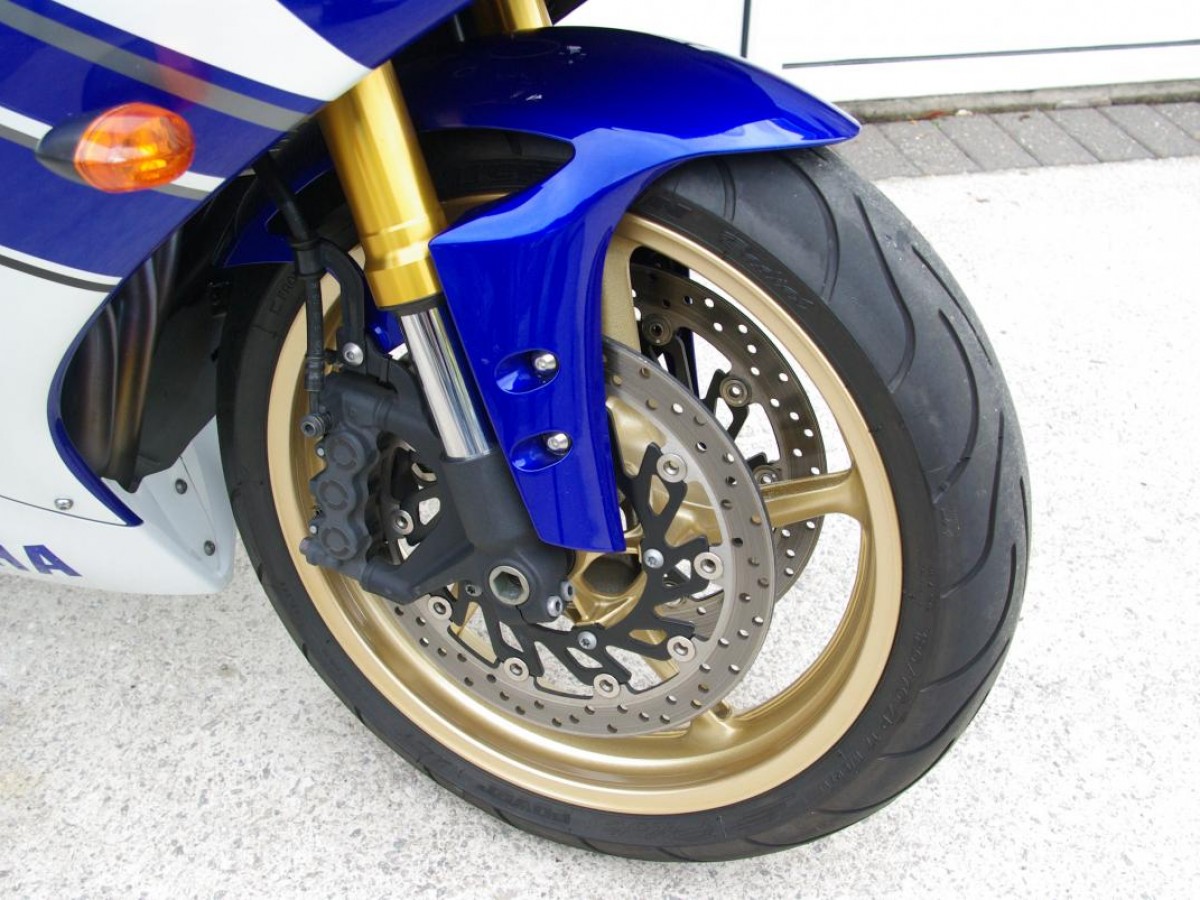

Yep. Have a look at pictures of most motorcycles with directional tread tyres. The front tyre is always fitted looking like it’s the ‘wrong' way round.
Yam R1 front and rear.
Rear wheels have to deal with acceleration force but the front wheel has to deal with braking force. They are usually labelled 'Front' and have an arrow marking the direction of rotation when going forward.
I don't understand that. I get that the front will be applying resistance under braking rather than acceleration. But it will still be rolling forwards, so that directional tread will be squeezing water inwards instead of shedding it outwards which, to my mind, increases the risk of aquaplaning.
I think that front tyre is on backwards. Is there an official guide on this, or is this one of those things that people just do?
No, definitely not on backwards. That was my initial thought and I had never considered it until I bought and fitted a set of tyres on a bike I owned. I thought the front tyre had been marked up wrongly so I looked into it. Look at any pictures of a bike with directional tyre on the front. I think the fact that there is a radius on a m/c tyre instead of a flat contact area helps with water dispersal more than the read pattern.
The explanation I found suggests that the water within the treads has its own forward momentum. While the bike is slowing the water wants to carry on going ahead of the bike. So it shoots forwards within the treads, to the outer edges of the tyre.
That does actually make sense. But it still doesn't make sense when you're cruising and ride through a puddle. Then the water will be pumped into the centre of the tyre.
