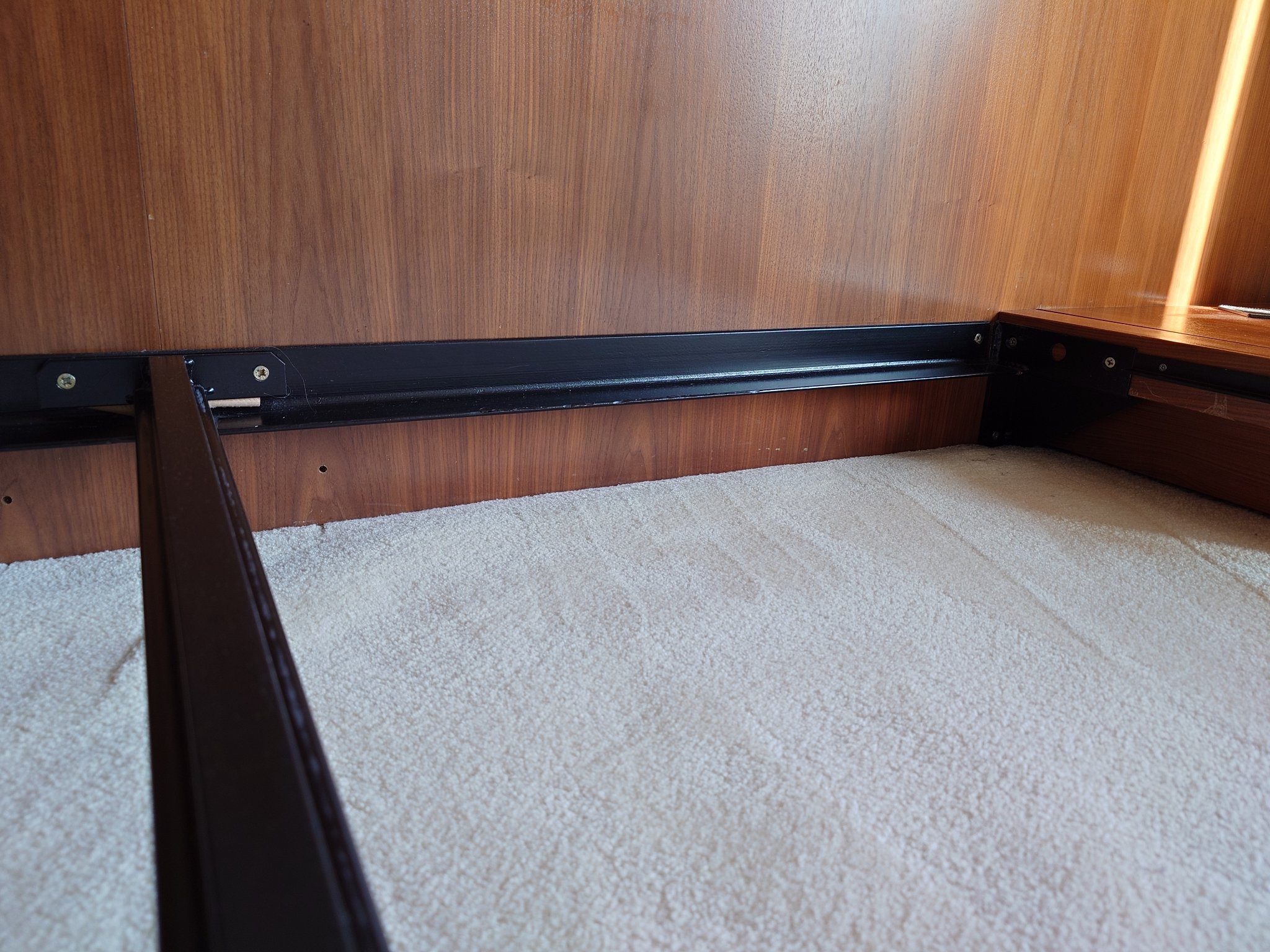

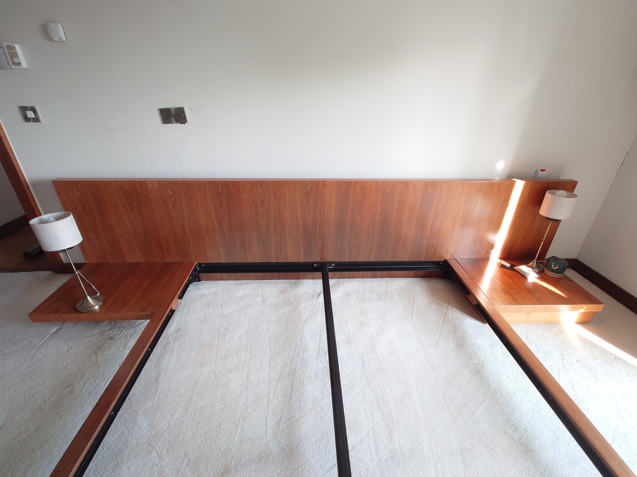

Yeah I've tried all that. It's built from a Poliform Ando bed. ( Not made anymore ) The metal frame and components were salvaged but the headboard, timber frame and shelves were remade. Some more photos attached but really at this stage all I want to know is if I unscrew will the screws go back tightly in the same holes. Or if not how to get around this.
Are they wood screws? Sometimes there are metal inserts that a threaded screw goes into. In the worse case scenario, you could fit thicker screws or even add some strengthening brackets. They’ll all be hidden when the bed is dressed.
I would be more inclined to turn it on it's side and pick it up to move out through the door.
Carpet fitters should be able to do this if you are physically unable to as it does not look that heavy.
Take one screw that connects the metal to timber apart.
Look inside the hole to see if there are metal inserts
If there are, then you should be good to go
If not, you can buy inserts that would go into the existing wood holes, after increasing the original hole.
They normally go into a hole drilled to a specific diameter and depth.
You often insert them using an Allen key (hex shaped) and they screw into the timber, with a metal thread inside.
