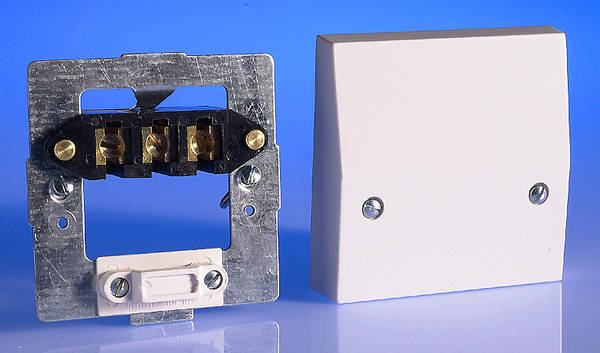

Sounds like they have a cooker connection unit,, so there shouldn't be any loose wires behind the plate.

If you have something like this which your cooker connects into; remove the front plate and it should be fairly obvious.
If in doubt some pictures please.

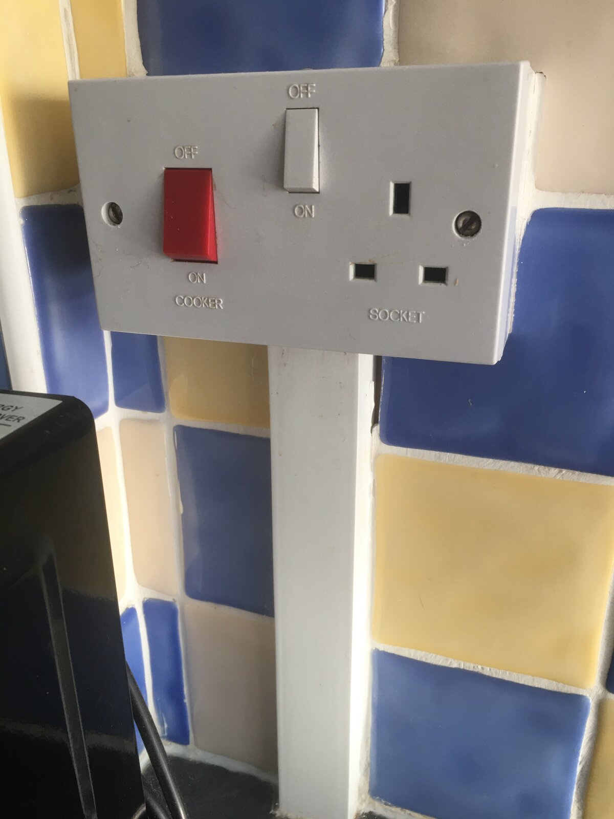

Ok its a bit different to what I thought. The cooker is wired into a plug socket. Can I still just turn off all the electrics to the entire house at the fuseboard, open up the socket and just disconnect the wires attached to the cooker cable, then just screw the socket front back on? (like a plug) or do I need to do anything special in the socket? Thank you
So the cable is plastered in and pops out of the wall, and not to a junction box?

My apologies, I didn't attatch a pic

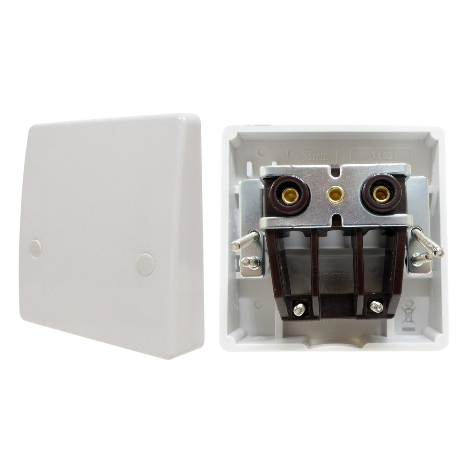

Do you have something like this behind the cooker?
the cable is in trunking down the tiles, it goes through the cupboard underneath and into the back of the cupboard. I don't want to leave the cable behind, so I need to disconnect from this socket.

Fair play. Just disconnect the cable in the switch and pull the load cable out of the trunking.
