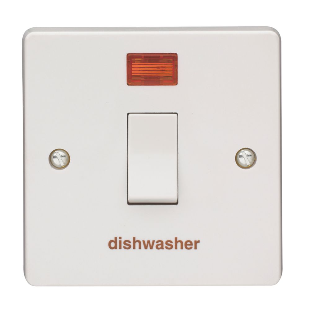

I notice that you can buy a switch designed for a dishwasher, such as this
ae235
ae235
It seems designed to have the dishwasher wired directly into it, which is not what I am after (because I
don't want cabling above the worktop)
Can I use this as a standard control switch and just have a chased cable running from it, to an unswitched socket under the counter?
It's not designed for a dishwasher; it just has 'dishwasher' written on it.
It is exactly the same as one with 'washing machine' written on it or nothing at all.
I don't know what you mean. The DW wouldn't work if not wired directly into it, would it?
You can have a 20A switch without a fuse, if that is what you mean but you don't have to.
Of course but that has nothing to do with whether you have a switch, what kind it is or you don't have one at all.

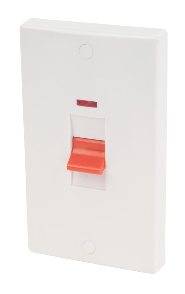

Just to clarify my original rambling question, I really just wanted to check that I could use that rather than something like this
ae235
sounds like I can and, as EFL points out, it simply has Dishwasher written on it :)

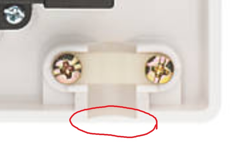

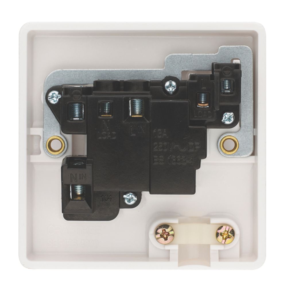

As the "Dishwasher" one seems designed to accommodate a flex direct to the appliance, I just wanted to check that there was no reason not to run 2.5mm T&E instead, down to a socket.
As EFL says, there will be cabling above the worktop, but I plan to chase that it the wall. I should have clarified that I didn't want a flex or visible cable (so that the worktop has no gaps or holes in it).
That's just an optional feature, this little bit of plastic needs breaking off to convert that into a 'flex outlet'...
So yes, without breaking that off, it can be used 'normally' for concealed cables down the wall.
