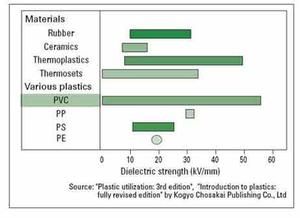

There it ends as data cable is PE insulated which is +1000 VA AC resistant.
Ensure that is the case and forget about anything else.
And that's my exact point, is the PE insulation (or HDPE in my case) on data cable officially rated at 1000V AC???
