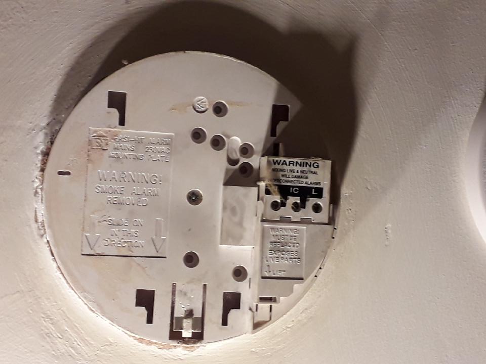

My mum has 3 old mains base units, wired to mains. The tops (i.e. the detector parts) are long since gone having malfunctioned some years back. I have replaced with three FireAngel 10 yr LiIon alarms. thing is the old base units look ugly and are still screwed to the ceiling and connected (to what I am not sure)
. The wires seems to have been clipped onto the joist so hardly any movement. I want to remove the old base units and make good the ceiling but what to do with those pesky live wires? The consumer unit has an entry labelled lights/smoke alarms so I guess everything is spurred off the lighting circuit (each unit is near to a ceiling light).
There are 2 cables entering the unit: twin and earth, and a 3 core and earth (T&E + yellow, I seem to recall)
Can anybody please advise the safe way to render the wiring safe; I feel that just snipping them off, taping over and pushing the cable into the ceiling void is not right?
Are you sure you should remove them, they may be a Building Regs requirement, i think having at least 1 mains unit has been a Reg for some time in some homes, so may vary with age of premises, poking old wiring in ceiling is not an ideal option,

It's good to have mains ones, if the alarm is triggered on one floor, all go off
Them base do look like the aico brand
If you went for them (look on eBay) you maybe able to just slide new ones onto the base with no damage to ceiling.

They need to be mains with battery back-up - that way they will keep working for a long time and the temptation to just take the batteries out when they run down is removed.
They need to be interlinked - that way, when one is triggered, all of them sound which means those sleeping on the top floor (where it's too high to climb out of a window and jump down) have some chance of being woken up before the fire from the kitchen has made the stairs impassible.
You can use radio links for interlinking, but that's a backwards step when the wiring is already in place - I would never use radio when it's possible/practical to use fixed wires.
