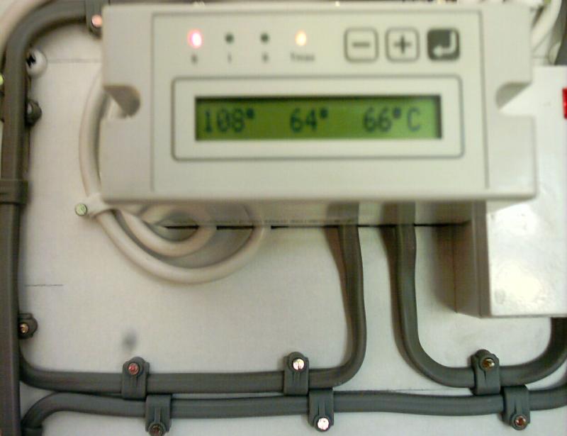

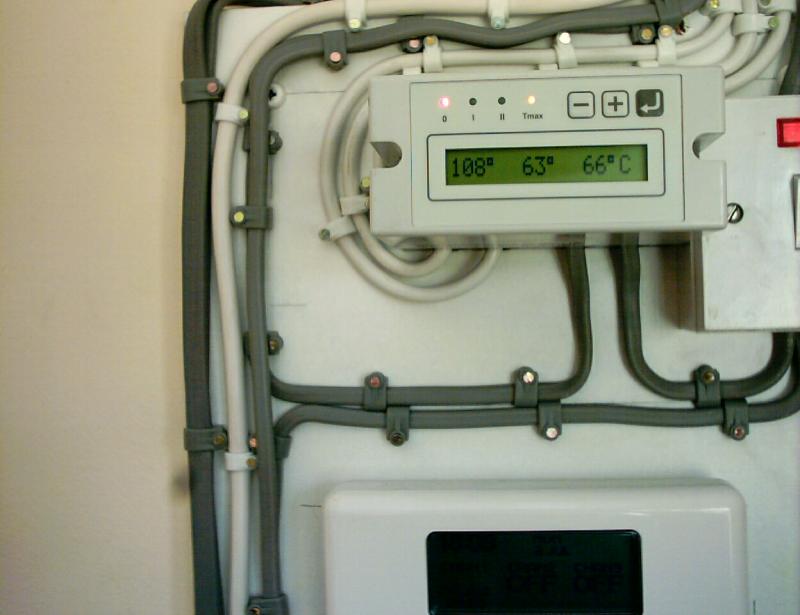

just a couple of pics with my panel on overheat! 108C panel temp 64 top of cylinder and 66 bottom of cylinder
have a years temp records. with cylinder temp above 90C and hot water pumping round house still had to dump some water on 1 occasion when panel was 140C and cylinder at 102C
What is the setup and sizes?
